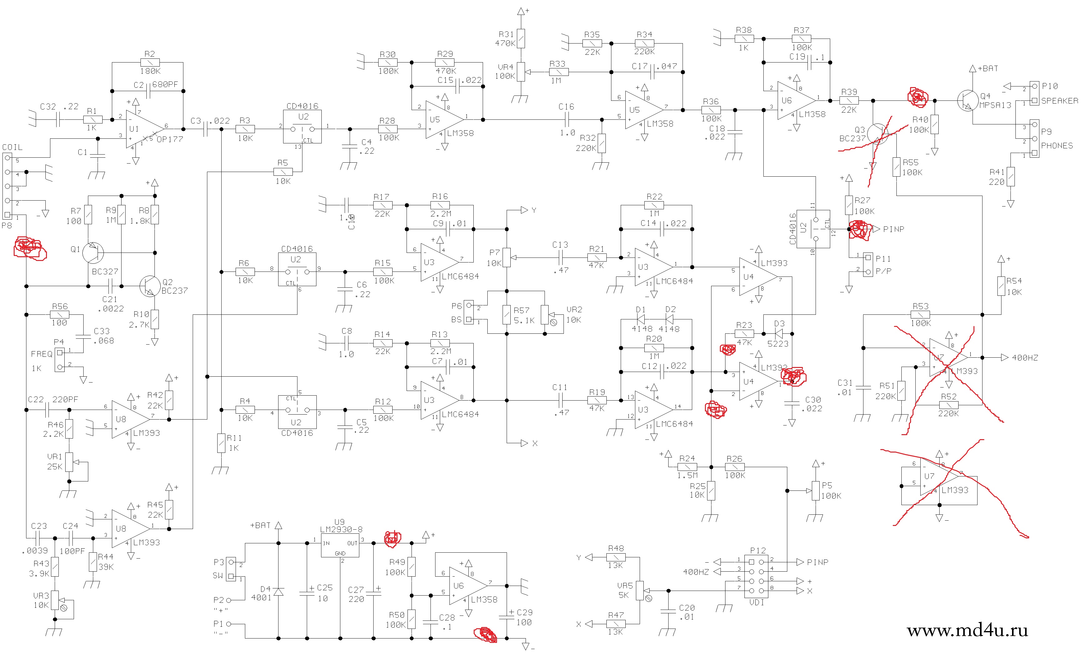

      Eduardo could you please verify the connections on the 2-tones board especially the connection from pin 6 on the two tone board to the TX coil transistor Q1? is this correct?
      My low tone is good, but my non ferrous tone is weak and broken. thanks
      • Here are the points of connection with the PCB-2 TONES. U7 and Q3 is eliminated. Mine works very well as shown in the video. You have to respect the connections and everything will be alright. There are no mistakes in my PCB.Regards.

          Yes, that is exactly the way I have it connected. I used one BC547, and one BC547B transistor. I should have socketed the IC's for testing. My high tone on good metals is not working.
          • Do not know what can happen. Mine works perfectly.
            • Post here the PCB has done and so I can look if you made a error. What version have you done?. If you have not posted here in the forum I can not guess the error.

                    I socketed the IC's, replaced all the semiconductors, still the same problem, static, good low tone, broken high tone. It also seems to change the way the discrimination control works. Would using ribbon cable to connect the 2 tone board to main board cause noise problems as opposed to using separate wires for connections? possible crosstalk? has anybody else actually built this two tone board?
