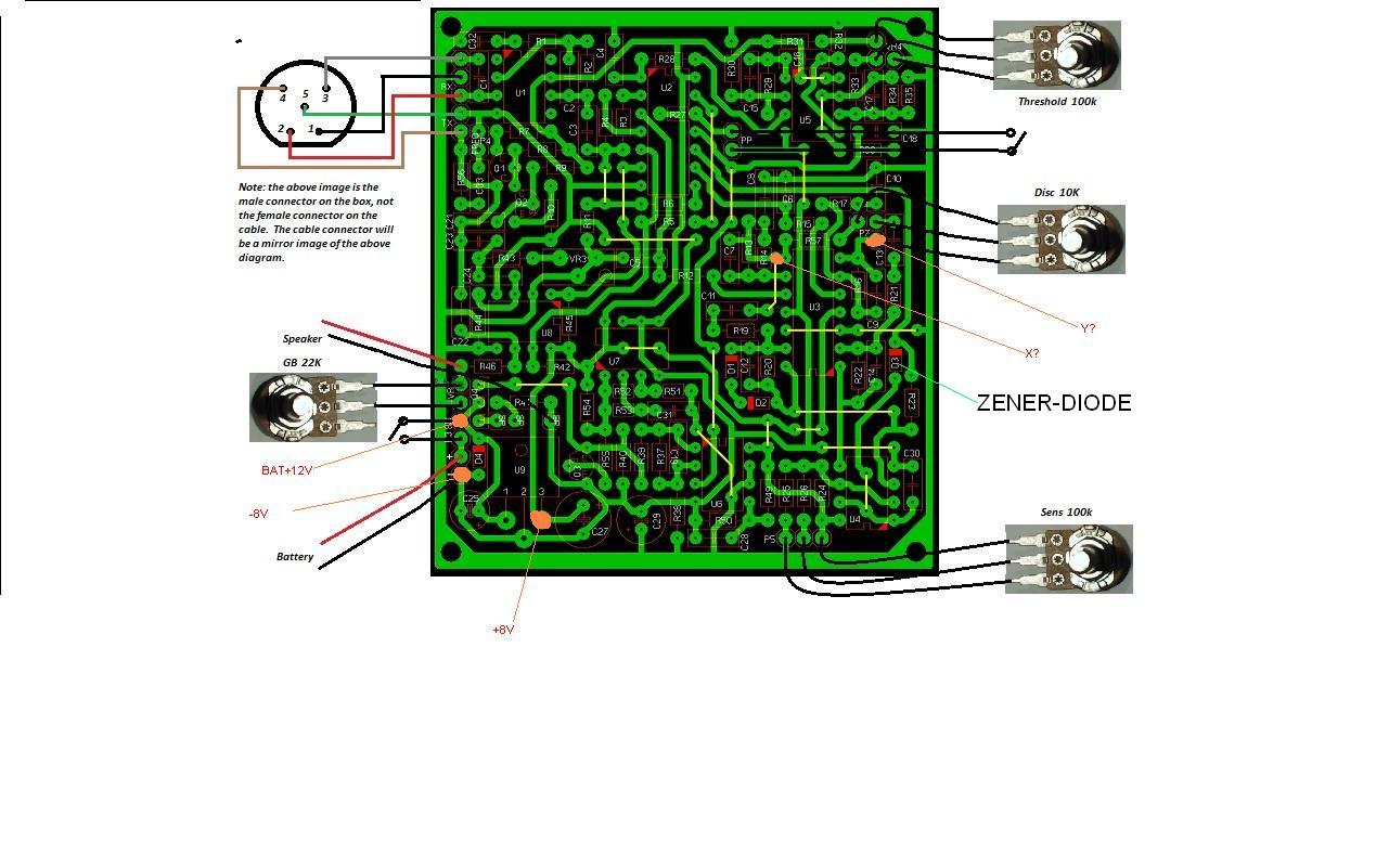

    I disagree with the -8V there is no mechanism to get -8Volts.
    I think at this time, that we get +8 for plus rail 0Volts for negative rail and +4Volts for Earth/0V equivalent.
    Bit confusing this one. Is there a schematic for the kit pcb.
    I know it must work but you always need some detail to get it right.
    Is the supplied 3n3 a problem should I unsolder and buy correct value?
    Should I remove VR3 trimmer and put pot to front panel for GEB?

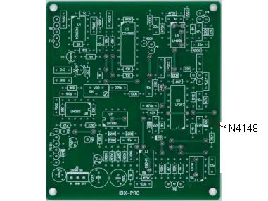

    • Hi, D3 is the wrong way in your layout picture.
      The copper around the pcb edge sits at +4V wrt battery 0v this is correct I think.
      v is +8v
      gnd is +4v
      -v is 0v
      • no, I've made my own circuit board with Eduardos layout.
        but it is still not finished .... must replace a few parts and even a new coil winding.
        someone has written, I think it was eduardo that VR3 can be adjusted to 1kohm ..... remains on the motherboard.
        Perhaps you read again by all treat. there are a lot of questions answered.
        greetings marc

          The position of the D3 is correct. The original was a Zener diode and I replaced by a 1N4148 and so the poraridad Amongst the reverse. You do not worry about that. The detector is working properly. I'll post here again complete with all files updated data.
                      It is true!
                      • Yor useful picture with the pot wiring has D3 one way. ->|-
                        Silverdogs kit pcb has D3 it the other way around. -|<-
                        Both of you cant be right!!
                        Steve
                          Steve
                          If you look carefully, you will notice that the PCB is the same as SilverDog that I published yesterday. The diodes are placed in the same direction. Look at it carefully.
                          • Sorry, my point was Schatnaters post 720 has a loyout image.
                            This image has D3 reversed.
                            Or maybe I dont understand - I think maybe the latter
                            • i hope this can help
                              • Thanks I see now - was a zener. now not. So its reversed on silk screen.
