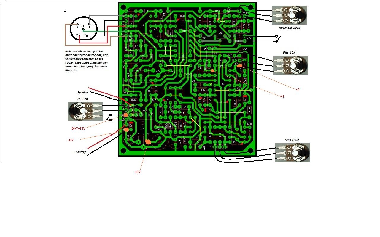

    • Originally posted by Schatztaucher View Post
      Would be super nice if someone would check the connections vdi ....
      Many greetings marc
      Connecting the speakers good? Not the original points soldered?
      • I can not say ..... my circuit board is not yet ... am still in the coils .... but if you don's idx in the video to see and hear, everything seems to be ok .... the circuit board has its of silverdog ..... where the connectors for the speakers are the same
          De ez a kép nem a silverdog féle. Ez a módosított idx. OK. Látom, hogyan gondoltad.

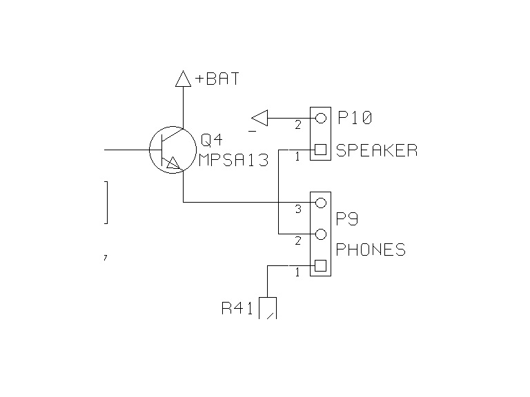

            • Originally posted by szucs_g View Post
              Sorry, There is a mistake on the diagram. The speaker connection is obvious though, right behind P1.
              Don
                The SMD resistor R27, I changed. This makes it easier to position. I've seen here on the board that there is a version of IDX, where you have left it (R27).
                Already completed the PCB, soldered everything. Comes the test. All have taken the IC. :-)
                  Don
                  The original circuit of the loudspeaker and ended in the headphone jack.

                    • yes, now I get the error with the speaker and found ... I had not seen noticed
