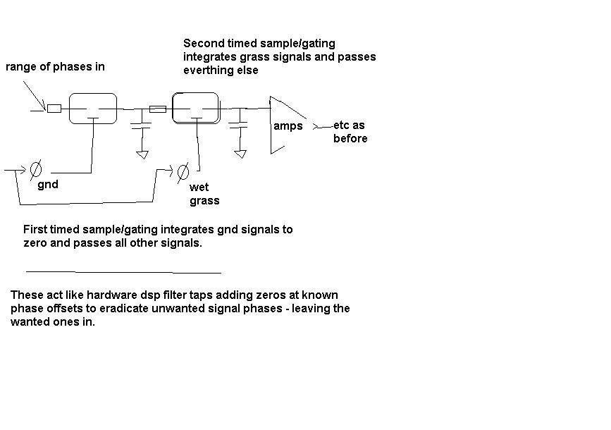

          • Hi Hugo, when the wet grass was mentioned - it was also mentioned that in order to move the problem onwards some more info was required.
            Info such as, was the GEB CH tripping the comparator or was it the DISC. Or Both etc..
            Yes it is good for discussion , but no amount of speculation will eradicate these problems without a structured engineering approach.
            Where are we , where do we want to be, how do we get there, are we there - if so stop etc
            As these simple machines can only integrate out one target phase - eg ground it is a challenge to integrate to zero additional phases of targets on the same channel - eg wet grass.
            I dont know if this has been done, if you had more gating of the Rx signal additional to the existing det - whether this could apply a second chance to integrate out an unwanted target phase.
            e.g.

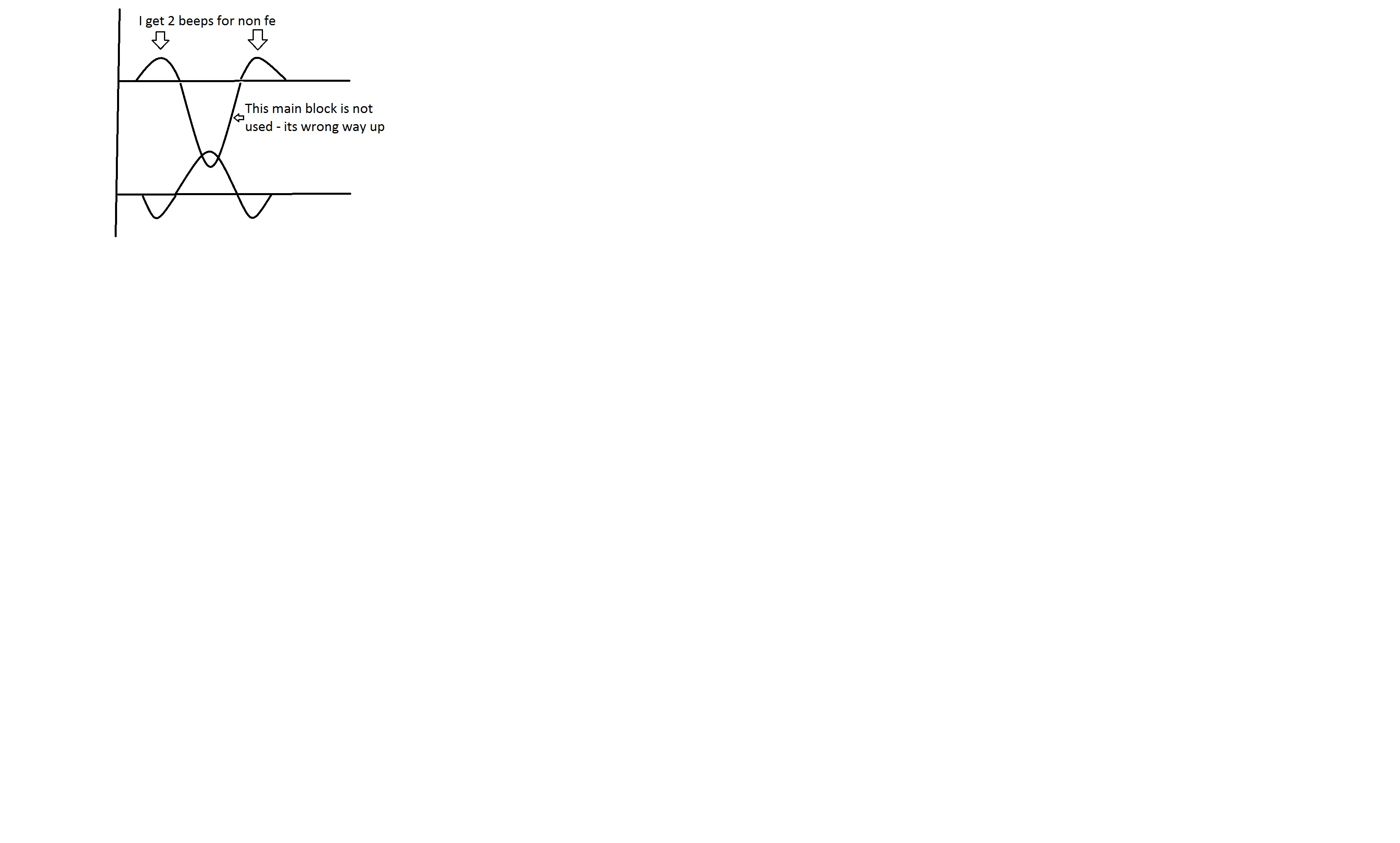

                      • Disc mode
                        I notice the disc and Geb Ch signals are in antiphase.. I thought they should go the same way to trip comparator AND logic.
                        On my unit the Disc Ch signal goes negaitve with a small positive either side - hence I get 2 beeps each way for Non Fe..
                        Odd - is this normal?
                        • Try swapping the Rx coil input wires, that should sort it out.
                          My question is about the pinpoint mode - does it give double beep?
                            Yes he should swap TX or RX leads, depends how he wired his coil.
