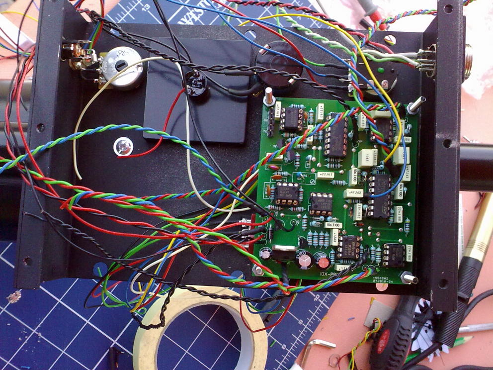

                • I had recently good experiance with my IDX. I had my Rx coil wired correctly - prior to Nulling. - PP was fine, all good.
                  Having fine tuned the null and potted - I never re-checked it. It must mave flipped the other way during nulling.
                  Anyway my PP was toilet and I got loads of Iron beeps and a double for targets.
                  Flipped the other way and the Iron is controllable exept for big iron.
                  I thought my Threshold did nothing - but it does.
                  I added a series resistor in with my GEB pot to get more range.

                        I did a mod to my IDX last night. Not very scientific but here goes.
                        The Tx osc on mine is at 11KHz ~0.44mH L and 470nF cap I wanted to see if there was any room for more Tx signal without problems in use or circuitry fails.
                        I use 3 Li Fe laptop cells 1.8Ah 12V.
                        I wanted to freshen the Tx drive a little, I cut the trace feeding R7,8,9 and added a wire to the regulator input. So Tx rail is 4v higher now.
                        In quick test it does give me a refreshingly clear positive ID on a uk 20p at 8 inches - under my lawn. - previoulsly I struggled with this testbed target.
                        More easy to use than deeper - more crisp and positive somehow - and it didnt go bang !
                        I also found the point on the Disc dial where coke is rejected and non Fe items still ring out..
                        Will try later on farm.

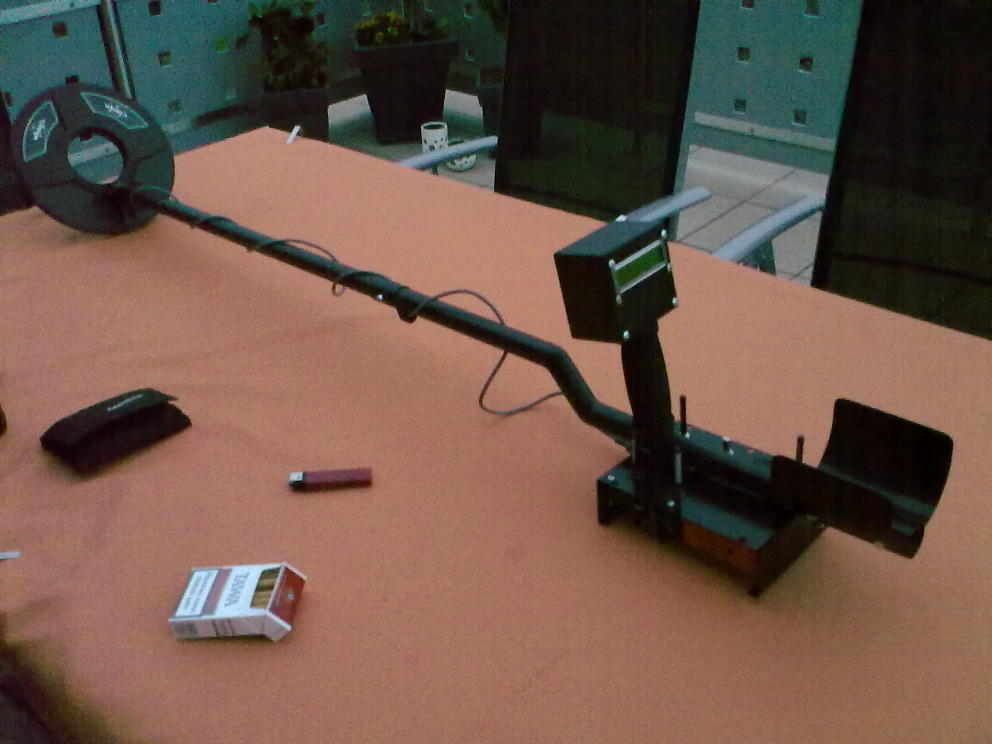

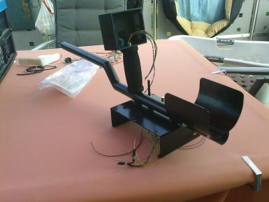

                              • This is my IDX-PRO
                                https://www.youtube.com/watch?v=uaJN...M&feature=plcp
