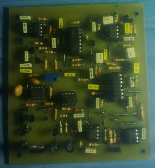

      LM7808.se gets hot and burned by 12v battery charger direct
      • It is best to test your PCB first with all the IC's removed.
        • LM7808.se se calienta y se quema
          remove ic and test voltage joop

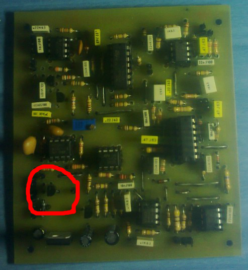

          • MPSA13 misfitted
            Error Error revised thanks joop

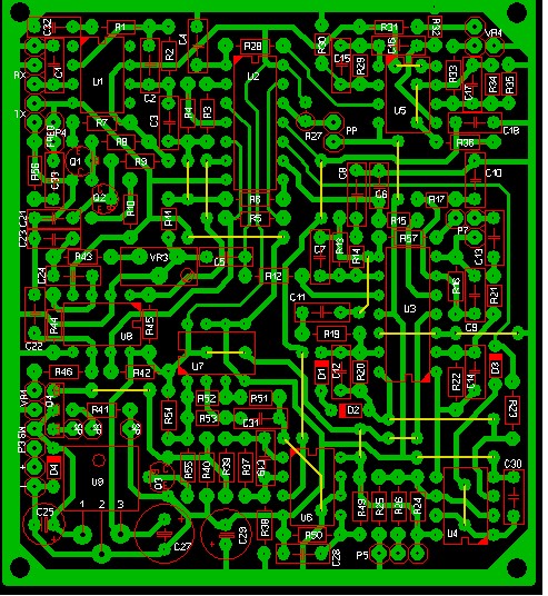

              • I do understand that the MPSA13 is upside down on the original PCB?
                [ATTACH]23695[/ATTACH]
                • the mpsa13 has the right direction. what speaker are you use? i had the same problem with a wrong speaker......i think i read in one schematic something like 50ohm-speaker.....you came use a piezo-speaker, like in silverdog's kit....
                  • was out of place ,regulator is still hot,Classic 2 Speaker
Name:	5-3-2013 19.3.13 1.jpg
                    • another problem It melts BC517
                      solved was a short another problem It melts BC517

                              • my mistake speaker got the wrong cable and invest BC517 is not b
