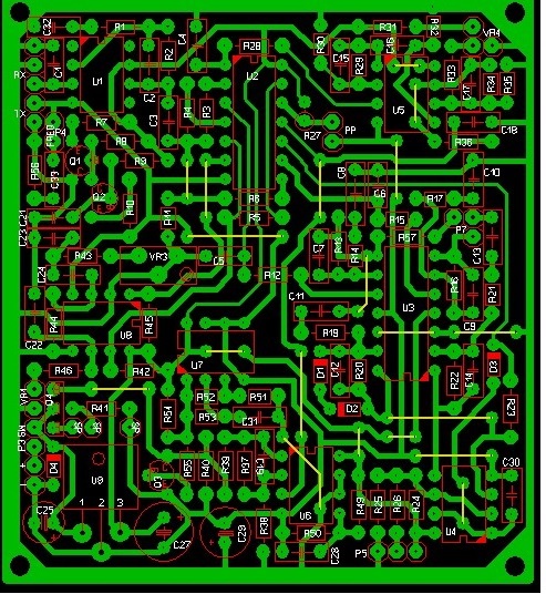

    I see two things that are apparent to me.
    A) The PP ch is on in normal use..
    I recall a few people posting on here saying that they had hoped for more depth from their IDX kit.
    Looking at the schematic there are 3 Rx channels -
    DISC
    GEB
    PP
    In normal Disc use, all three rx chs are in use. ( In PP the Disc and Geb ch are isolated with a cosmos switch)
    The PP ch works by having a response down to dc - to catch responses at no motion.
    As the PP ch is:-
    1)Broadband, it will let more noise though.
    2)DC image from product detector will also be present.
    A potential solution would be to add a 4u7 cap with a switch in parallel with it ( open switch - normal disc useage, closed - PP )
    B) With VR4 up high - for more sens, the IDX begins to loose ability to reject iron...
    This is because the PP ch (which is ON during normal use) isnt gated from the Disc gating but the GEB gate.
    Dont know what to do here.. ?

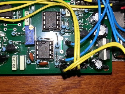

                    • no sound
                      idx no sound
                      Speaker 4 ohm, 8 ohm, 16 ohm, 50 ohm ... value
                      thanks
                      • 8 ohm speaker only responds cloc
                        Originally posted by onuba View Post
                        idx no sound
                        thanks
                        8 ohm 0.5w speaker only responds cloc

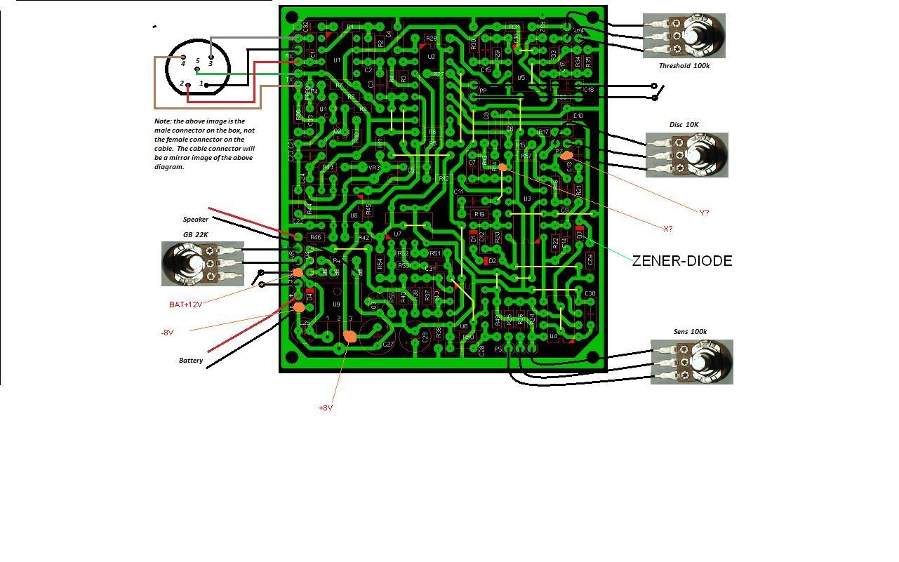

                        • Speakers connection
                          I put it in the sp. sp or is as photo
                          • Originally posted by onuba View Post
                            [ATTACH]23742[/ATTACH]
                            If it's a Silverdog kit they will be labeled SP+ and SP-
                              kit is not Silverdog down photo and d3 is well
