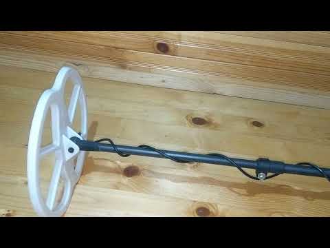

        • Is this max depth of IDX-PRO? Because I read here 60cm for 1euro in the air but I can't achieve it. https://youtu.be/yJzRr4prhhg
          • What depth are we talking about? You can get 1 meter in the air and it's not difficult. Only this meter-high air sensitivity will give absolutely nothing, on real soil and in the soil layer, even worse.
            P/s ...it is better to accurately identify a target by 30 cm in the soil layer than 60 cm in the air, although everyone has their own.​
            • Originally posted by bonchev2 View Post
              Hi. with this device, not everything is so simple. you can overclock it, but this is not very good, it has a large current in the transmission circuit and the device works well only on light soils. in chernozem and clay, he goes blind. here I made this device 10 years ago, for a copper coin with a diameter of 45mm through the air of 65cm. https://www.youtube.com/watch?v=xXyIXFg2pKE
              • Good job, but sounds a little different than mine. What is the thickness of the wire for TX that you use?
                  0,6
                  • that's great
