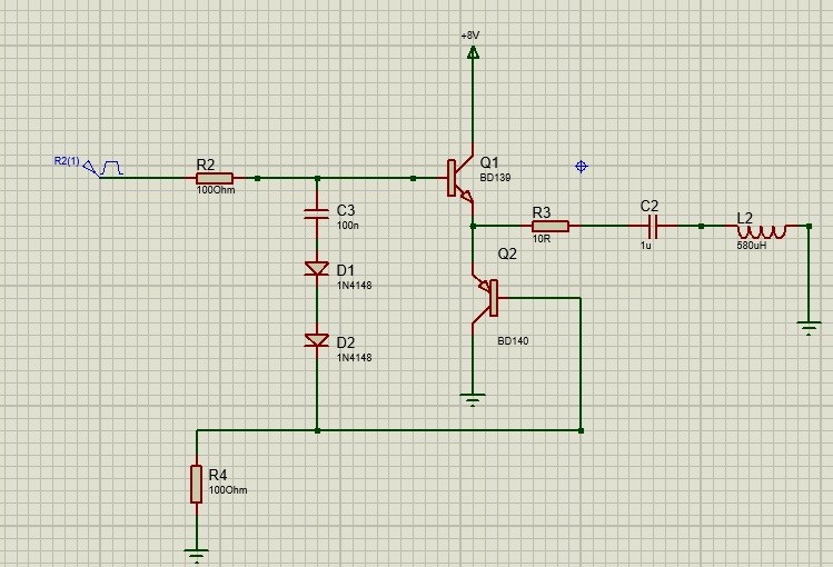

    Click image for larger version  Name:	sch.jpg Views:	0 Size:	121.3 KB ID:	451077
    Coil diameter = 20 cm, key saturation voltage = 0.6 V
    Q - quality factor of the resonant circuit
    F=6,5k
    Q / U(L2)/ I*N / N /I, amp/ R3+R(L2)
    5 / 21v / 5 / 242/ 0,02 / 204
    5 / 21v / 10 / 121/ 0,08 / 51
    5 / 21v / 20 / 61 / 0,33 / 13
    5 / 21v / 40 / 30 / 1,32 / 3,2
    10/ 42v / 5 /491 / 0,01 /419
    10/ 42v / 10 /246/ 0,04 /105
    10/ 42v / 20 /122/ 0,16 /26
    10/ 42v / 40 / 61 / 0,65 / 6,5

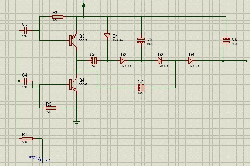

        See attached, i added an extra step for more increasing (20V).
        I simulated, no error. Do you see any error?
        I want to test three voltages in my panel, 8, 15, 20V.
          Yes, the shielded inductor in your link would be perfect.
          Yes, look at the LTX waveform. I would put the circuit in LTSpice to figure out the component values.

            Usually a charge pump is not a very good choice for the TX power supply, try adding a load and see what happens.
            The White's V3 had a "transmit boost" option, which increased VTX from 10V to 30V. It added only 2-3cm of depth on typical coins. As you increase the TX field strength (using any method) the IB null becomes more critical, otherwise you will likely overload the preamp.
