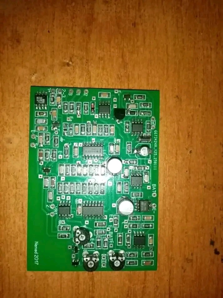

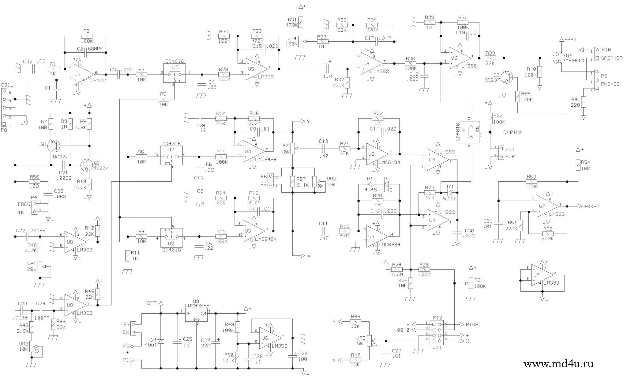

              Either you don't know how to adjust the timing potentiometer, or it seems you don't know how to wind the coil; the one I built—I don't recall if it was 27 cm or 32 cm—had a range of 45–50 cm in an air test. Conditions in the field are different, of course! But if the device picks up the metal well and you watch the LCD screen, it performs quite solidly... And did you move the filter capacitors (located after the 100k resistor) to ground? If you stick to the factory schematic, those capacitors at the output of the CD4066 chip drastically reduce detection depth!

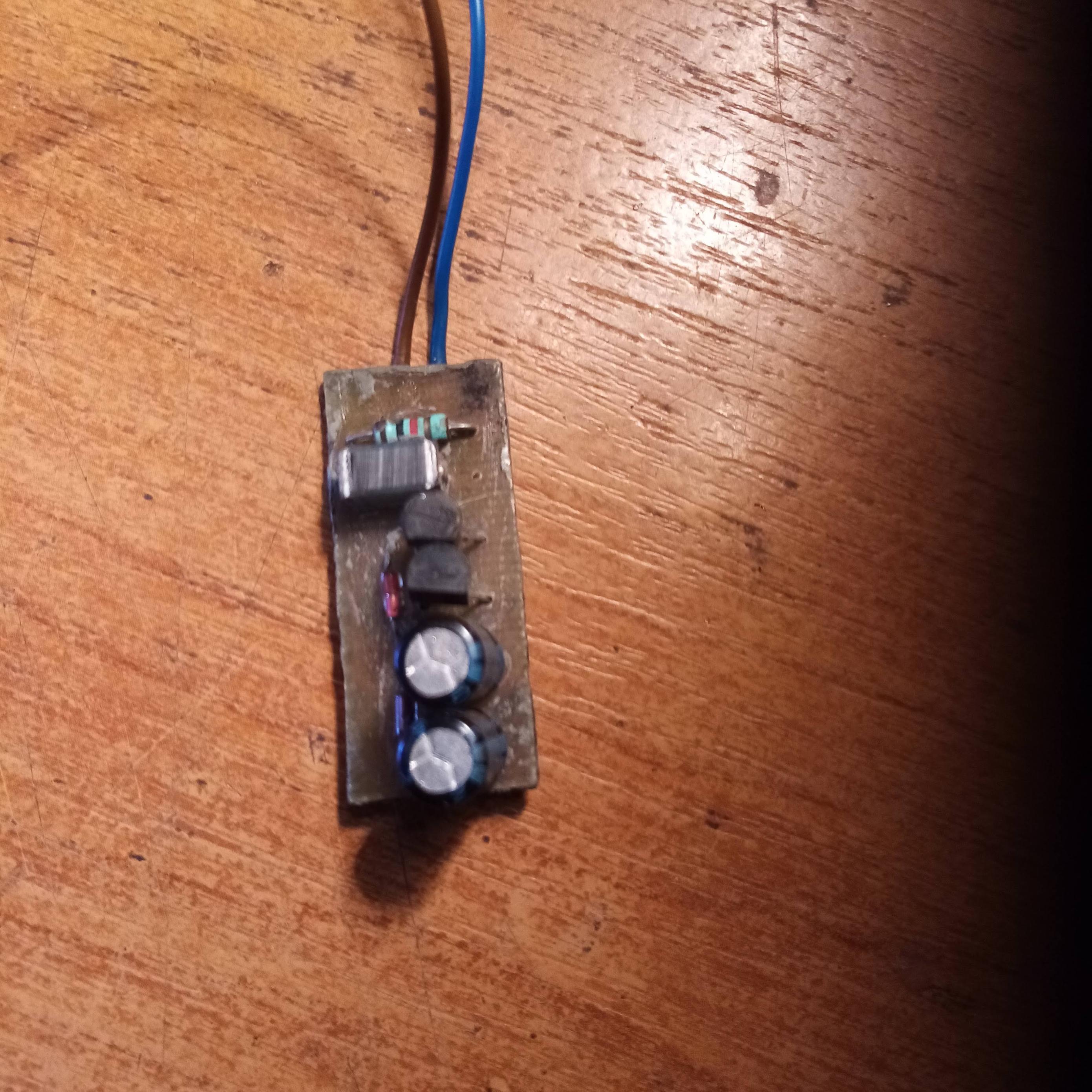

              • The small pcb was taken off the idx that Bill mod finished, it's actually the pump charging schematic, and last time I did the idx was a 00 coil and the number of turns was tx 45 with rx 140, range in air 50cm.

                      • Idx - pcb - smd.. Click image for larger version

                        • Admiral TX, approximately ACV, pumps 12 volts; the system is very different, though.
                            Thank you for your posts.
                            See schematic, is your mean 1uF+22K or 220n+100k?
                            I checked my parts, it is exactly like schematic.
                            Now, my Air depth for a coin (made of Copper, zinc and nickel, 25mm diameter) is 31-32 cm.
                            My coil size is 30cm.
                              Thanks, my Air test was 8V, not 15V.
                              Do you remember your TX and RX inductance, Wire size and parallel capacitor?
                              • First remove C5 and C6 and move the same capacitors at the input to the amplifiers or behind 100k! My TX capacitor is 470 nf with 45 circles of 0.45 mm thick wire and rx 140 circles and 0.25 mm thick.And R25 replaced from 10k to 1k..
