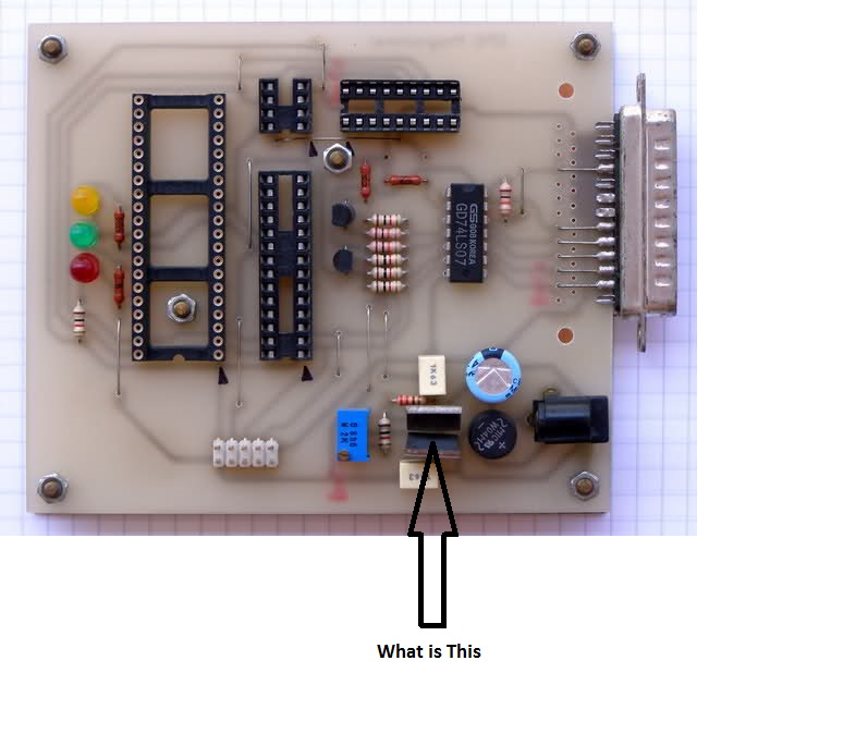

    can anyone explain what is in that picture
    • two fets facing each other?
      • I guess: 7805 and lm317

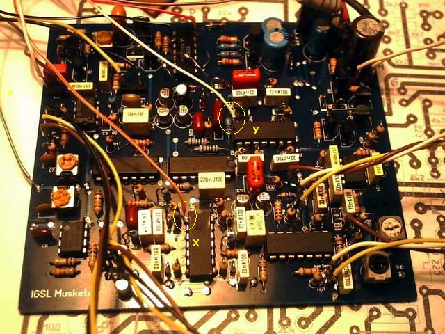

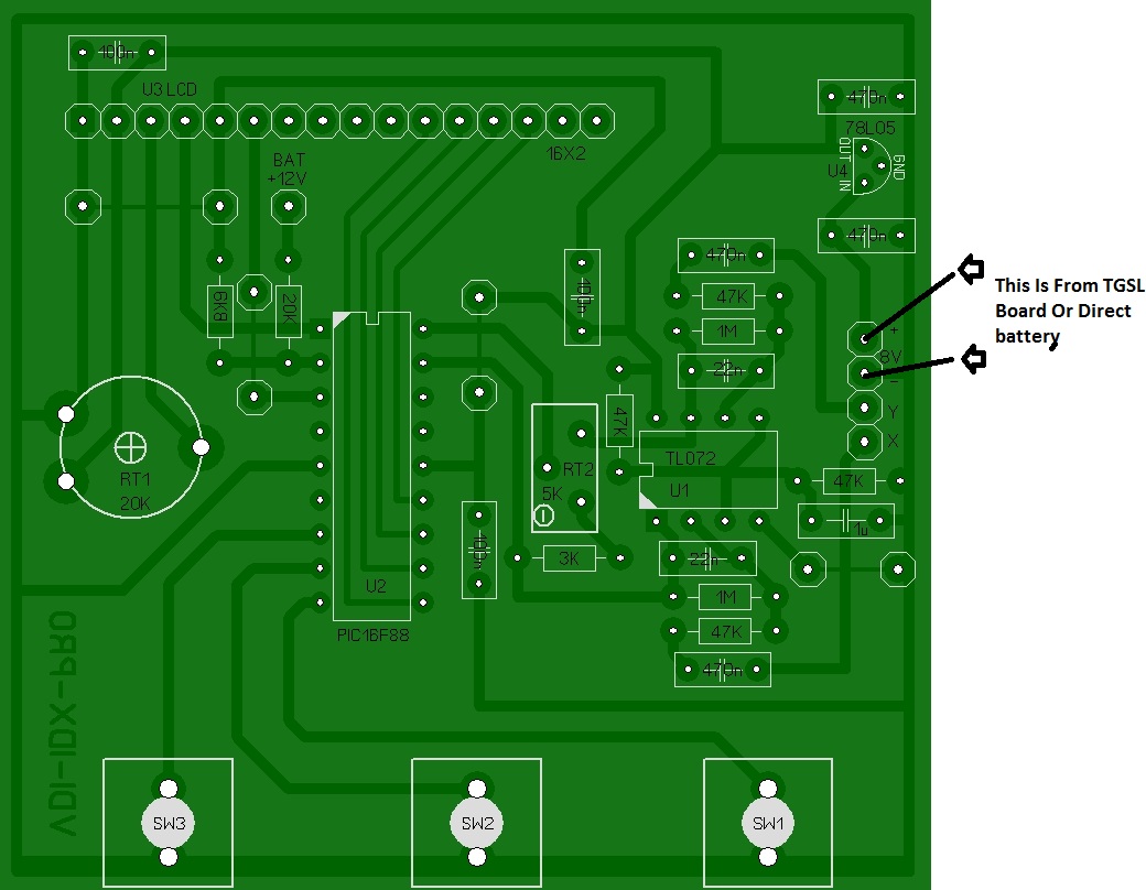

              how to connect VDI to TGSL EDU Board
              • Originally posted by paku View Post
                ivconic can you help!
                • This is IGSL not TGSL
                  the IC is different

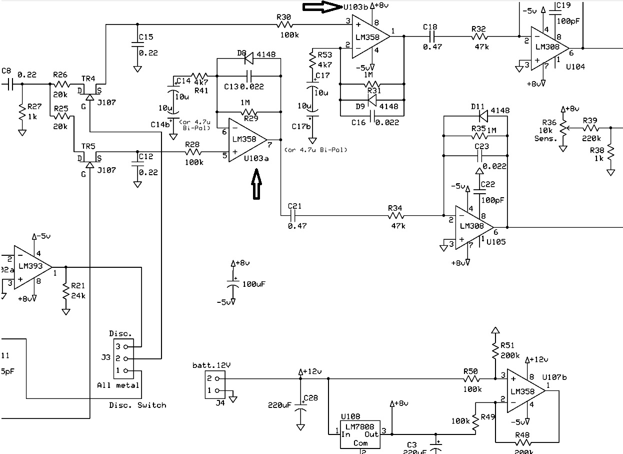

                  • You can try pins 7 (x) and 1 (y) of U103.

                      Ok i Will Try That pins 7 (x) and 1 (y) of U103.
                      so at the VDI board have + 8V - must connect to battery or board on TGSL

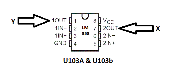

                      • On Schematic TGSL EDU have U103A and U103B so witch one of that
                        • so you are still joking
                          U103 contains two devices, and you need both outputs to feed your VDI.
                          • haha sometime we must have joke bro,
                            so dont make self angry bird hehe
                            I Will Make It Now
                            And What is connection for ( + 8V - )
                              i need two wire from U103a and U103b connect to VDI board
                              From Pins 7 (x) U103a Two wire
                              From Pins 1 (y) U103b Two wire
                              It Is Like That Bro
                              • This is correct. You'll find +8V on the board, and you use it with a ground connection, NOT -5V! Make sure the wire to the ground is the only ground connection of VDI.
