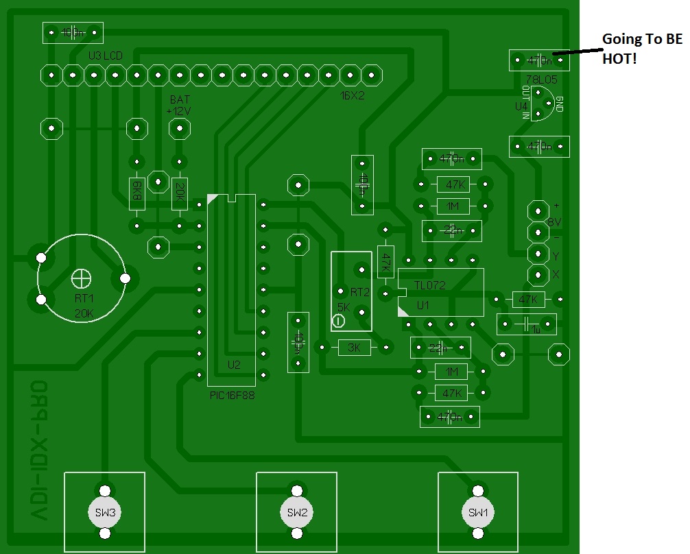

  • at schematic U105 Pins 7 have +8v
    can i use that
    • Sure. At pin 3 you'll find ground.
      • Ok Thanks Bro! You Help Me Full Nice
        Love U Bro You Ar Rock!!!
        • I hope not

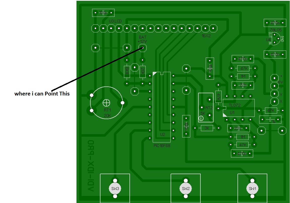

            at the picture have Bat +12V point
            so where i can point that
            is that direct To Battery

              Why This 0.47 Capacitor Get Very Hot!
              • look like reversed 7805 in the silk screen
                • i have follow on the board part placement so i need reversed 7805
                  • Silkscreen shows proper orientation for 78L05 in TO-92 package. It's bigger brother 7805 in TO-220 package has reversed pinout.
                    • Bro my LCD now Its Up and working But What is BAT12v+ point an the lcd don have backlight how to make backlight up
                      • Guess what - there's also +12V on your board
                        • BAT i think stand for battery so maybe you need to hook it at the battery paku
