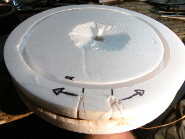

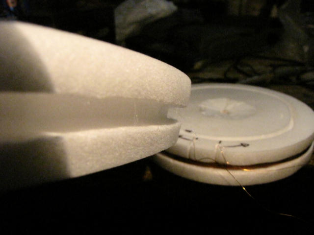

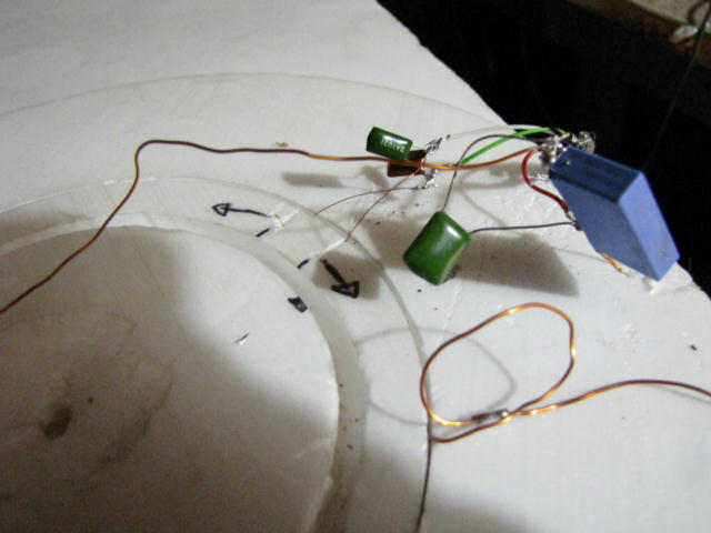

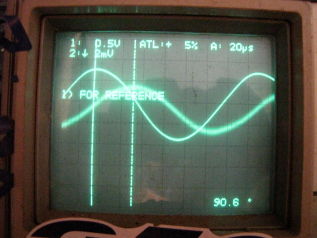

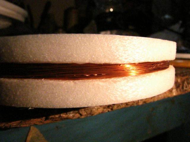

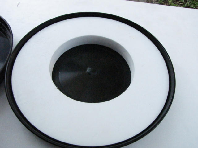

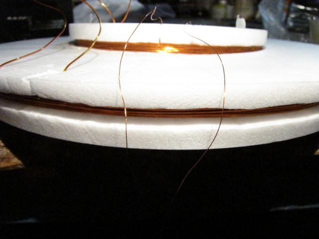

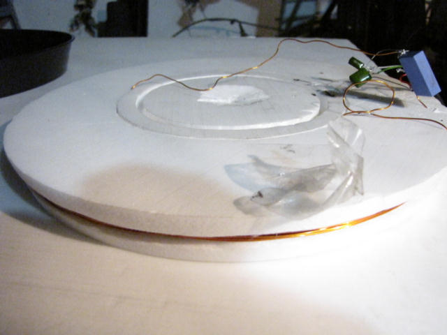

      • I`m still no luck there.
        tryed with concentric coil tuned tx at 6.54 KHz 24 cm 0.70 mm about 33t rx about 260t 0.20 33nf at 4.6 KHz and bucking is 10t 0.70 direct over rx coil.
        putting a 22nf cap in rx increases a lot residual tx and made the coil imposible to null below 8mv but increases 3 cm target distance.
        i tried increasing rx preamp gain whitout success.
        1 e coin at 24 cm in air.

          • Gustavodigitales,
            Hmm, nice effort there. I really would like to see your project come together. I have the luxury of matching everything to a White's BM600 coil so I just made resonance the same for my project and the White's manufactured coil.
            Now, if I'm not mistaken, 35mH together with 33nF = 4.68 kHz using this calculator:
            http://www.whatcircuits.com/lc-reson...cy-calculator/
            That's why I was questioning the specs posted elsewhere. The coil is pretty picky as to how it's tuned.
            Do you at least have access to a White's coil for reference? We need to cut your problem in 1/2.
            • Gustavodigitales,
              Something is not right with your RX coil, Your number of turns seem way off. If you use the coil calulator in the forum, it shows that for a 35mH coil it should be almost 450 turns. That's assuming that your RX coil has a 44mm radius. 260t might be about right for a 27CM DD coil.
              Don

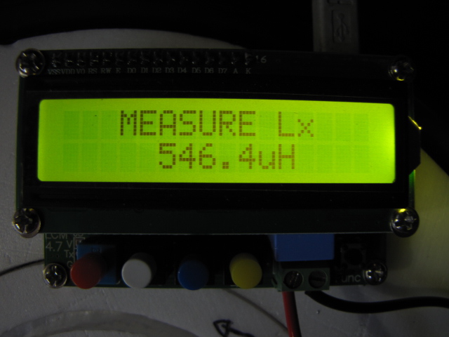

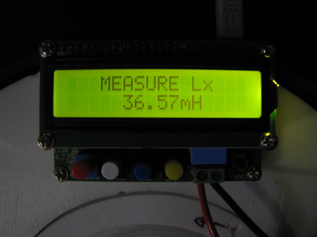

              • Sorry is 360t 36.5 mH 12 cm diameter 0.20 wireClick image for larger version
ID:	334542Click image for larger version
                here is my measurements for both coils .
                i`m very confused why not........
                other thing now i`m using a usb cable 4 conductors plus full shield.
                i gonna try changing the 4066 ic.

                  • Apparently you are using some sort of resonant LC meter (similar to mine) but this type of instrument can introduce significant errors when used to measure large inductance coils (RX coil) due to large coil self capacitance and variable frequency used for L calculation. Try to verify coil inductance by other means using different method or instrument, RX may be slightly detuned.
                        I tried building an Arduino inductance meter featured on youtube. Like you said the lower inductances measured close, but not the larger inductances. My Rx coil was measuring 50mH, when I knew that it was only 35mH.
                        • Typical problem with similar instruments and air coils. Reason for this is very small value of reference capacitor used to resonate measured L, only around 1nF or so. This is OK for large inductances made on some core or ferrite, but air coils have large turn numbers and larger inter winding capacitance added to reference one, producing larger freq. shift and wrong L value calculation, can be routinely 10 or 30% off, even more. I allays check exact coil tuning with oscilloscope and generator. Naturally, true fixed frequency RLC bridge can fix this, but not for 37$.
