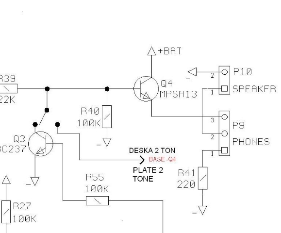

                  • I've try to make SMD schematic version of IDX with Eagle , DO NOT USE to make pcb may contain errors! there something to fix also about some points R18 'Y' side has no termination same
                    as 'X' , i am newbie bout cad design hopesomeone expert fix it so iwill make the pcb,passive components is 1206 smd size so esasier to soldering.

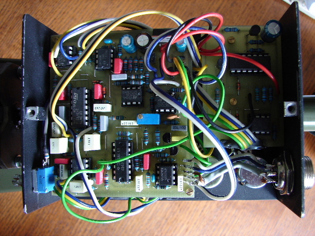

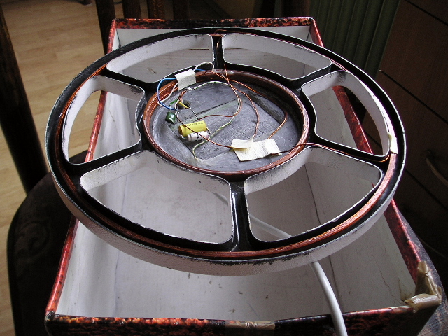

                            Coil update:
                            Without a doubt, best coil I ever made!
                            1) This coil with Silverdogs IDX kit hits all of them loud and clear in DISC mode and is more stable and deeper than my 9" and 10" homebuilt DD coils.T
                            2) My TGSL MIGHT hit the first one on a good day with a 10" DD coil
                            Hi Don, what is your stock coil on your IDX? Is it the 10" DD?
                            If so, and you have both coils available, is it possible to do a coil swap comparison on the same afternoon..??
                            If the small concentric is better than the larger DD I would make it my next coil project - If I could get a shell !!
                            S

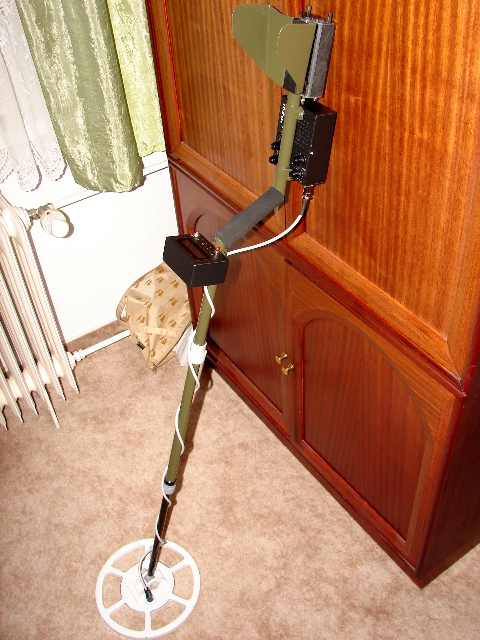

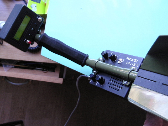

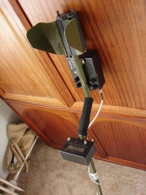

ID:	334578I'm sorry, I did not know. It was the first attempt. My knowledge of the English language is 0. Prefer to leave it
                              • Wooow man it is the beautest IDX I have ever seen, really great job! What kind of shield you use in that coil, and what about wett grass problem with two tone mode is it ok?
