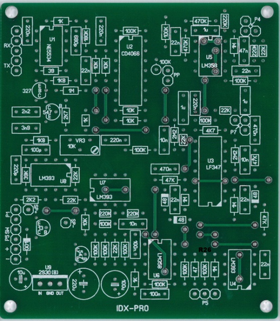

  • Hy Edouardo , I notice that on your pcb r26 resistance is 470 ohms, I have used a 47 ohm as mentioned in the partlist. what is the best value among these 2 resistors? thank you

      Hi, I think the 47 ohm is what is on my kit. It enables the user to set a lower Threshold to detect.

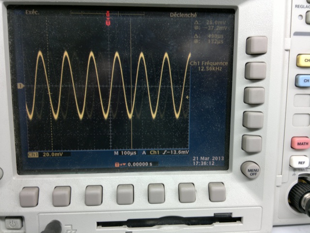

          • hi Edouardo , I leave a video of preliminary small problem I meet the threshold for permanent sound. maybe that is the environment in which I use the detector. can you help me thank you. This pics is Rx signal
            • http://www.youtube.com/watch?v=BH1s4weggVk
              • Originally posted by ashefr10 View Post
                For threshold tone discrimination mode, you have to eliminate the resistance of 470 ohms, and connect a 4K7 resistor between pins 6y7 of U4 (LM393). This way you will get a nice tone threshold discrimination mode. The threshold tone level is adjusted with the potentiometer sensitivity. Greetings. Eduardo.

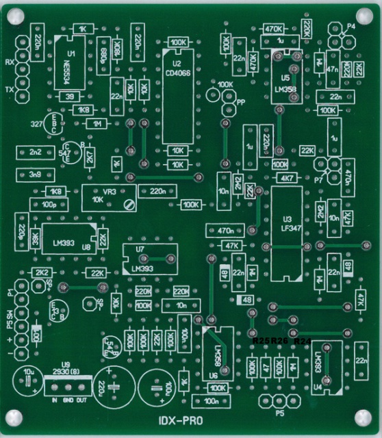

                • ok ,but where is the resistance of 470 ohm? I have a 47 ohm resistor
                  R25
                  • R26
                      R25
                      47 ohms resistor. (R25).
ID:	335547R26 is the resistance of 100 ohms on my card and not 470 ohms.
                        • Hi, your detector is oscillating - this can be from using long wires to the GEB and DISK pots. You may need to get a better NULL, 100mV isnt great.
                          Check there is no metal beneath test bench.
                          You may have phasing issue from Tx sig to Rx sig - often the delta betwwen these two is quoted as 20degrees or less.
                          In PP it can be noisey with the pot turned high.
                            [ATTACH=CONFIG]24036[/ATTACH]R26 is the resistance of 100 ohms on my card and not 470 ohms.
ID:	335548For values ​​of R24, R25 and R26 I put values ​​on the pcb as in pics
                              • What voltage should I have for nulling? 4 mV?
