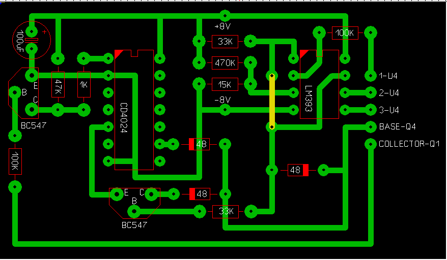

  • Is this PCB for 2 Tones correct??
Name:	2 Tones.png
    • Thank you ,

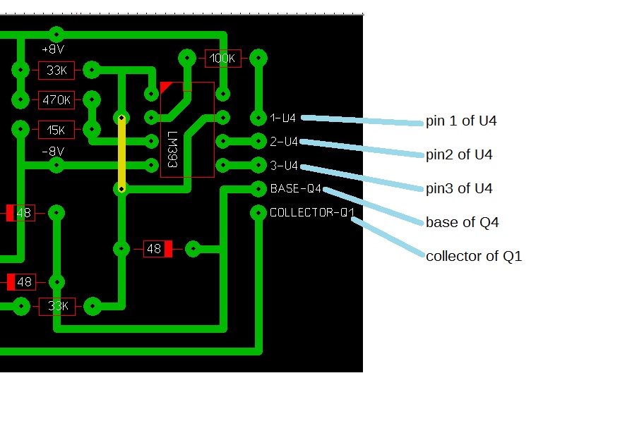

          • I am just having some trouble with the two tone board connections mainly the u4 connections 1 2 3 what ones go where?

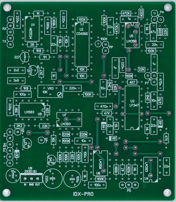

                              • Originally posted by Schatztaucher View Post
                                [ATTACH]25696[/ATTACH]
                                Do I need to remove somting from IDX-PRO PCB?when i connecting 2 tones board??
