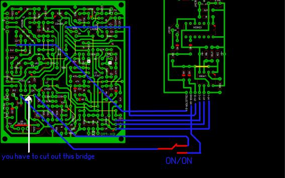

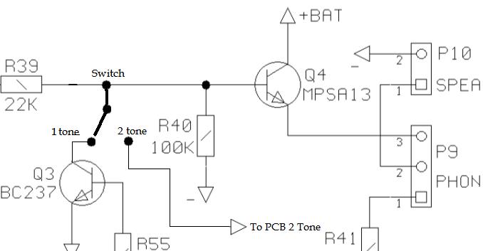

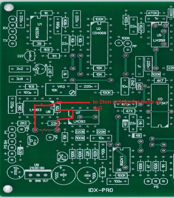

      • Originally posted by seadoggy View Post
        [ATTACH]25709[/ATTACH]
        Do I need to remove somting from IDX-PRO PCB?when i connecting 2 tones board??
        no....
        but you can build a switch between 1ton and 2ton....in the thread you can find more informations...Click image for larger version

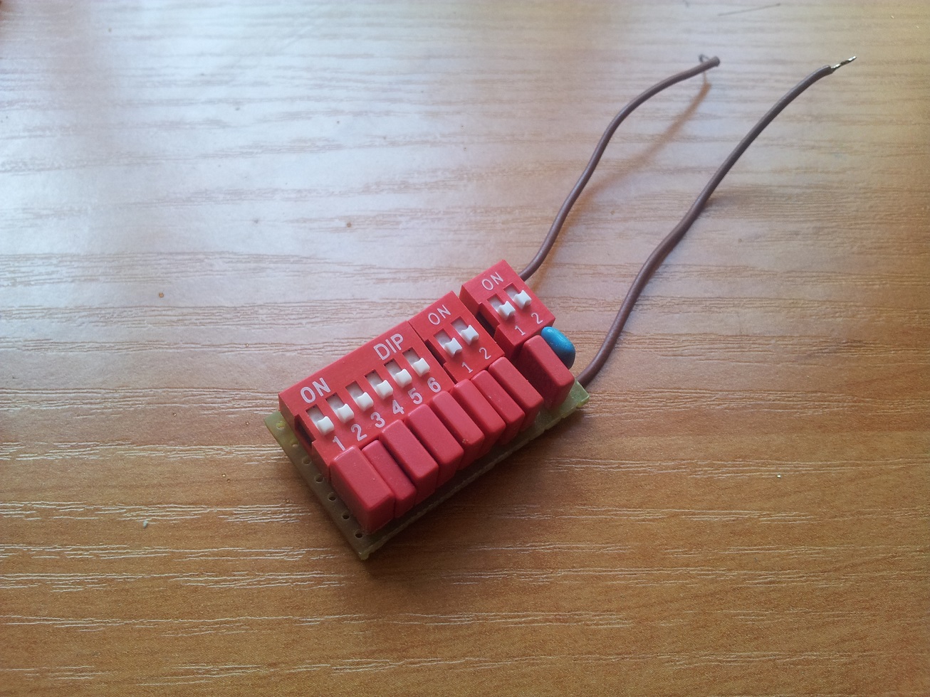

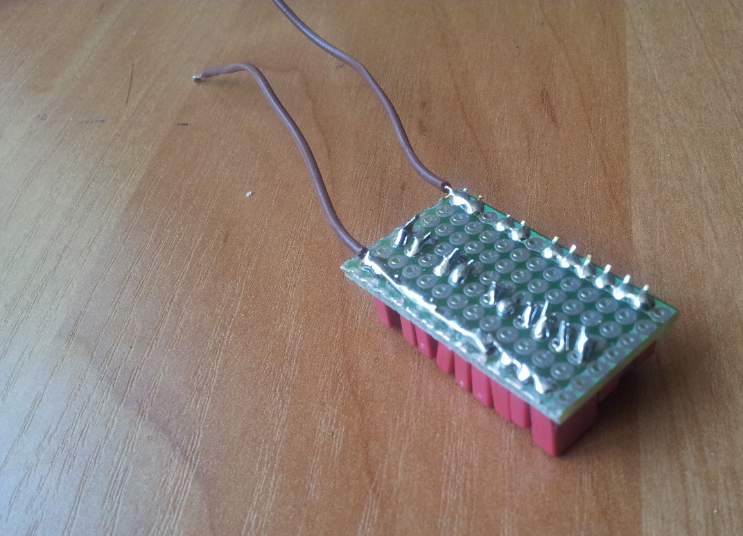

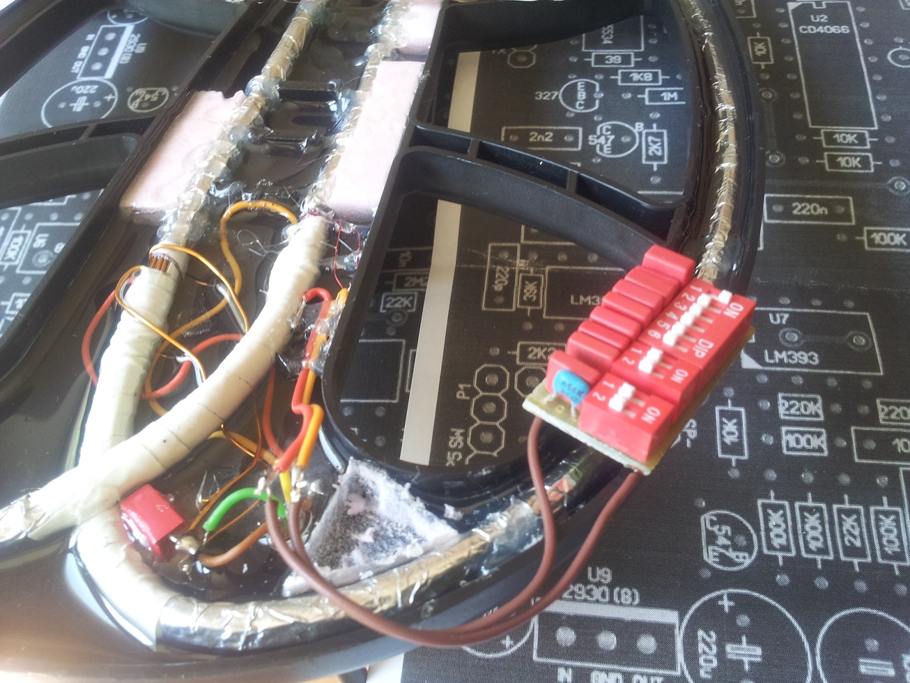

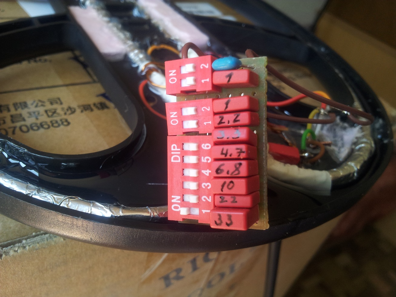

        • Guys, if you are tiered like me to solder and desolder capacitors, when you tune up the coil you can try my invention :
          • Originally posted by Schatztaucher View Post
            no....
            but you can build a switch between 1ton and 2ton....in the thread you can find more informations...[ATTACH]25722[/ATTACH]
            Can you make Pic mate to see how you connect 2 tone whit switch??this is very good!! do I need have switch ON ON,or ON OFF??
