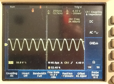

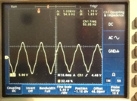

      I have a dual channel scope but can only get one channel working at the moment so here are some shots of the TX and then RX U1/pin 6. Do things look Bad?
      Max

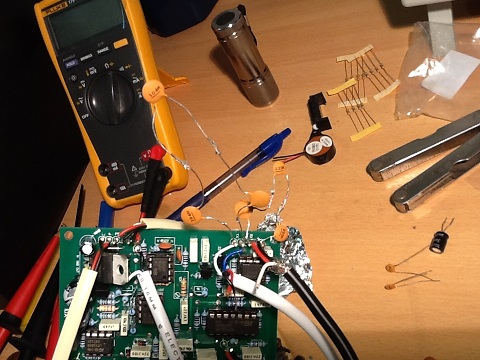

              are you refering to the caps in parallel with coil connections (image) or C1?
              I have tried many combos for parallel caps.
              Max

                • Hi Max - you appear to be transmitting on 24kHz
                  This design is for approx 6.5kHz - Add about 1uF see where you go.
                  When you get Tx right it may get easier.
                  S

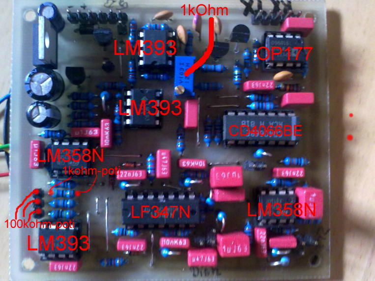

                      I wonder if I miss a change. idx of beeps. but not as it should. I miss a change? can someone tell me how I set the idx in the beginning right? (i mean the potis)
                      maybe one of the procedure-running.
                      first: switch on
                      secound: ....
                      third: ....
                      etc.....
                      • I might have to change R24? 1mohm to 1.5 mohm ? as in the circuit diagram?

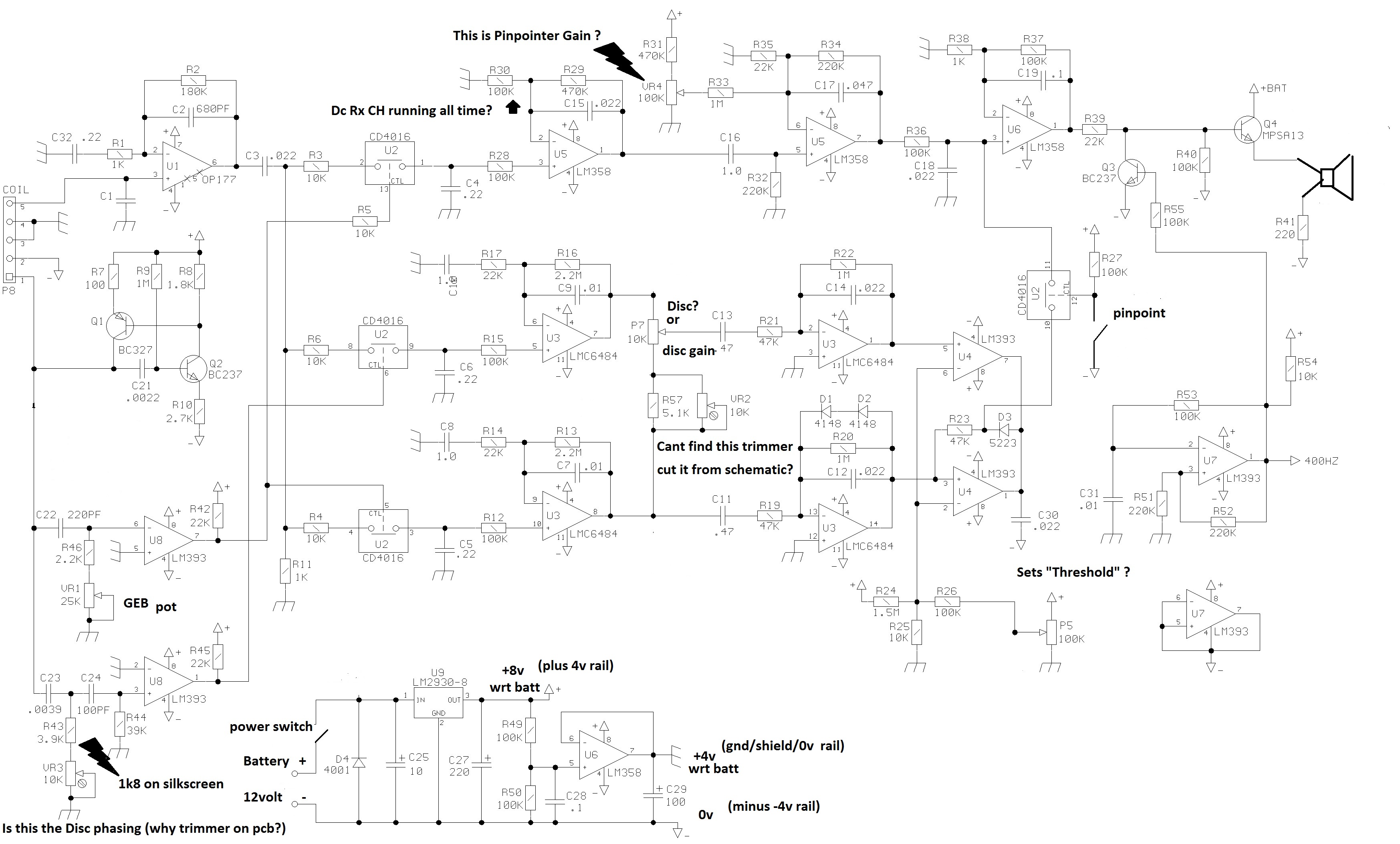

                        • Trying to assenble the IDX last night. Some discrepancies on the schematic vs PCB and assenbly photo on post page 23
                          on the assy photo - The Red Speaker wire appears to go to a circular pad - it doesnt.
                          On the schematic, have look I deleted what I dont think is there.
                          plus questions.
                          eg why is what I call the Disc pot a trimmer? (low LHS)
                          Whis is the Pinpoint channell on all the time - just Disc CH goes off for pinpoint on button.
                          etc
                          s

                            • Hi Golfnut,
                              Thanks for heads up about frequency.
                              That has solved most problems. Legend!
                              I set it up at 6.5khz with 90deg phase angle but found that I couldn't adjust gb anymore so have settled somewhere aroun 7.6khz with 120deg phase. Scope looks heaps cleaner at 6.5khz, maybe I'm missing something in the setup procedure or can adjust a component to bring g. Into range?
                              I too have notice dicrepencies with schematic.
                              Eduardo has suggested to remove vr3 pot and use 1k res. Not sure what it does either.
                              Vr2 is gone but what was its purpose?
