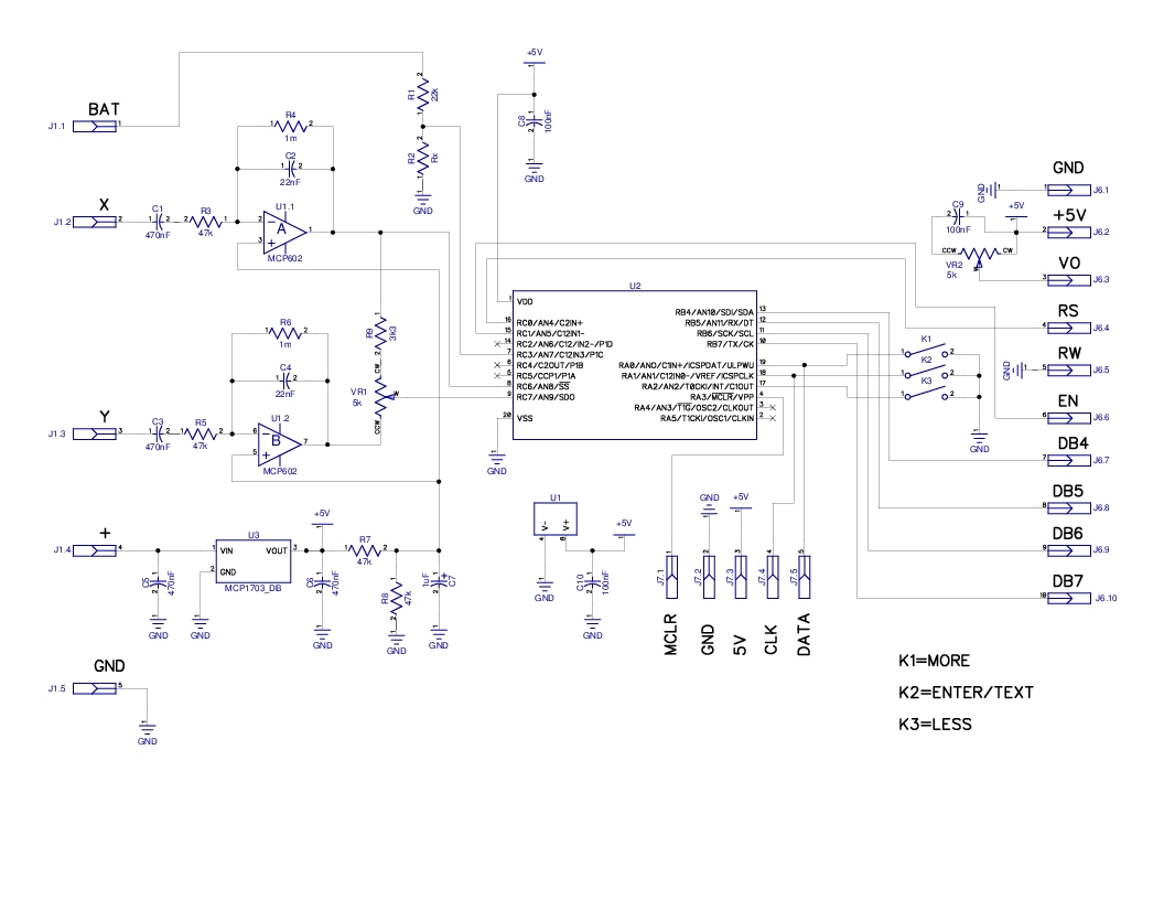

      • VDI 690 layout
        Hi all.
        I have done a layout for vdi 690 NB not built or checked.
        It features SMD for the 16f690 and the MCP1703 regulator. The other components being leaded. I post first schematic , Holyuser please check to see if it is correct and make comment. Your help greatly appreciated.
        If all looks well will post board layout.
        Maurice.
        • Congratulations for hard work, but there are already published version of the VDI board based on SMD PIC16F690 here: http://www.md4u.ru/forum/download/fi...7f9b66a5964b33
          • Hi Holyuser.
            Thanks for your reply and posting the link.
            It looks very good but I have to make my own boards with single sided PCB.
            They have a few links but everyboard is homemade.
            If someone needs my layout I will post.
            Best Regards
            Maurice.

                Excellent work Maurice! everyone who builds their own boards from scratch is well aware of how much work it takes to make a well layed out board that works. In my opinion , your work is greatly appreciated! thanks - please post layout.

                  • VDI layout
                    Hi and Greetings
                    Here is my layout. I have not made provision for a little heat sinking around the regulator. Perhaps a little tin profile soldered on may suffice.
                    This is my first time for using smd parts.(PIC and REGULATOR)
                    There are 8 links. Included in zip are:
                    top jpg
                    bottom jpg ( reflected image )
                    both
                    diptrace source files.
                    Any quires and I will be more than happy to help.
