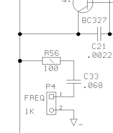

                      • Like i mentioned earlier; it should work in range 6.35 to 6.95 kHz.
                        At some versions there is also feature to adjust freq. (trimmer and few components, inside).
                        Here too, with P4 you can pull freq a bit if needed...
