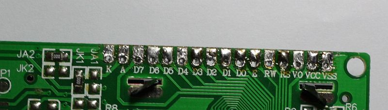

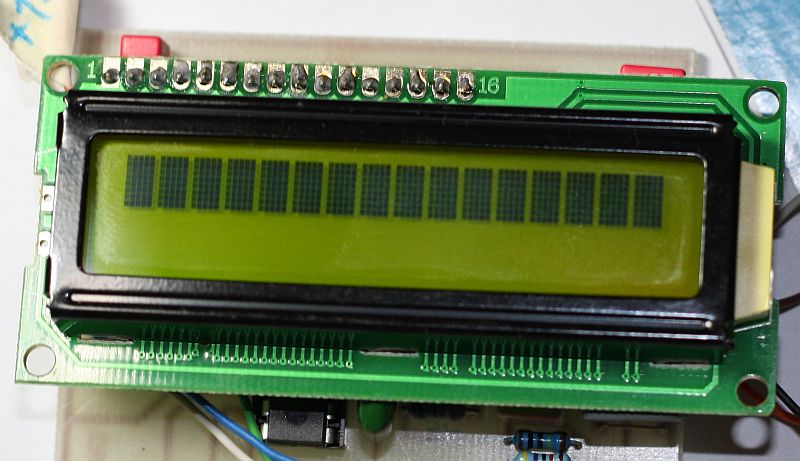

    • Dear freinds , i connect the lcd but i only see this !
      whats the problem ?

      • Originally posted by ahmad View Post
        whats the problem ?
        This usually means that the LCD contrast adjustment is set too high on pin 3.
        • Ty holyuser. I thonk i can see at least words on display. I solve LVP programmer i make one easy JDM programer and ok for High Voltage.
          However the same i See one line 1x16 full black blocks. My code is ok i`ve tried 7 pics, circuit ok.
          Same problem exactly like ahmad LCP jpg.
          To see full blocks on pin 3 = 0v If I turn the RT1 20k pot , pin 3= 5v and LCD nothing.
          I try diferent LCP panels, diferents PICS, programmers,.hex“s, i`ve checked board,components,voltages, but dont know.
          My DVI conect to main board to bat +12, +8v, GND(0v) and x,y.
          If I adjust Pot only blocks appear or disappear but no word to see :S only these blocks ever...

          If there are the pic or not on the socket i see the same blocks as the image above from ahmad.

          i use differents software to to program all ok i compare buffers code all ok. differents pics same, if i remove pic LCD same :S
          Its firs time programing pic and running lcd so i think its the problem .
          One thing i can understand why my idx gnd is 4v my gnd vdi board is 0, lol.
          Surely i“m learning on here
          thank you.

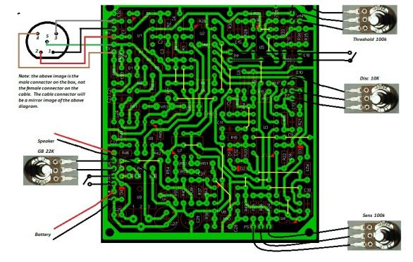

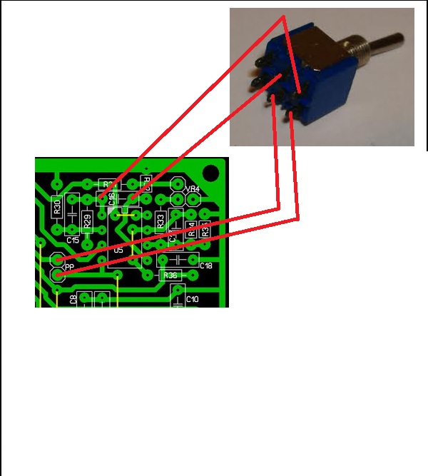

              • @ gulfnut
                i have made your pp-mod...pinpoint is better now....but now i lost my threshold-sound....can you tell me what i did wrong?Click image for larger version

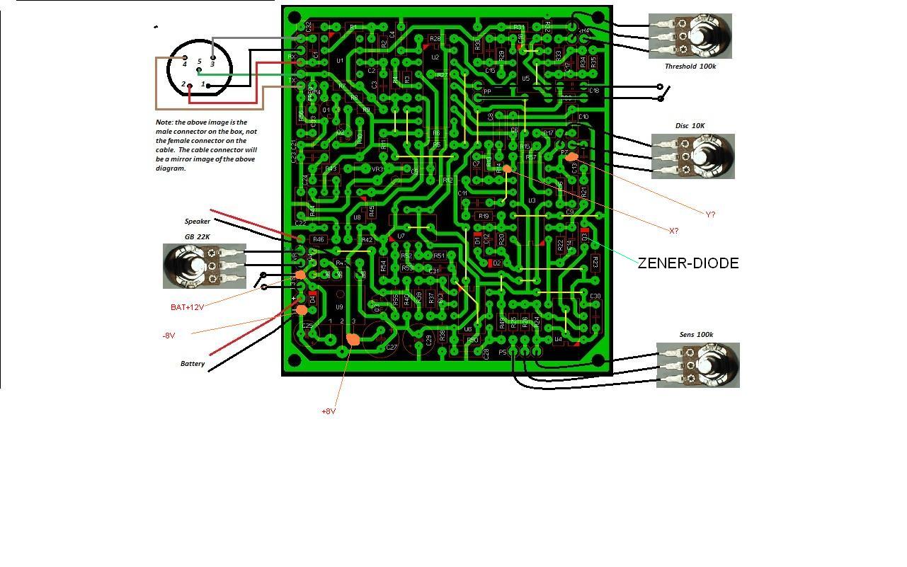

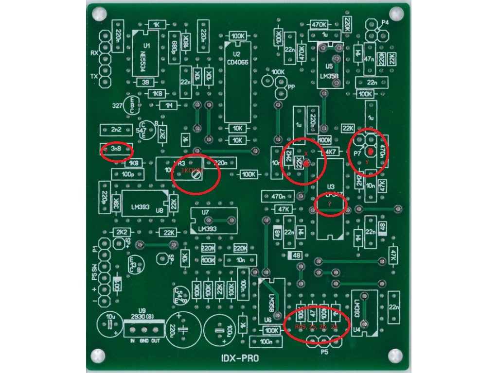

                      • is it important, that the Vr3 have 1 kOhm? if yes, between which pins ?
                        By the way, the direction of the "Zener" Diode is in wrong way in this layout!
                          the zener is over properly. if it`s an `48, then it would be wrong.
                          • Hi,
                            the value of my resistor VR3 was first 4,66 Ohm. I have it changed to 1 kOhm, but what should be better?
                            Note:
                            The 3n9 is on my Board a 3n3
                            • Ok i solve all mi pics, programer etc problems with DVI . Was a board defect. PIC hadnĀ“t pin 3 to 6(LCD) continuity. Was easy but headache with the problem.
                              Thank you all. Im goin to test the coil with vdi output
