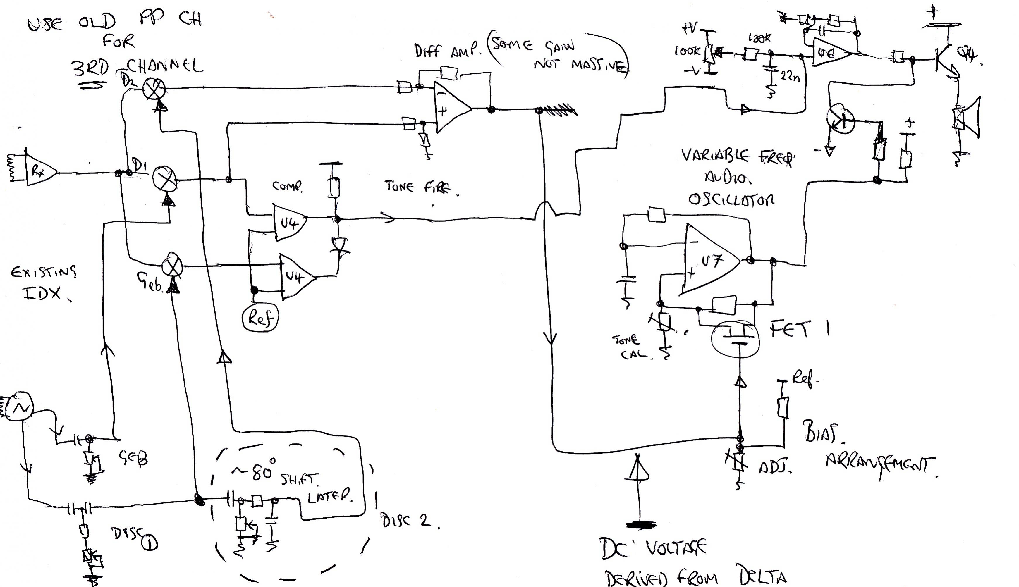

                • Been playing with a nel coil on my IDX - working ok now. The Nel Hunter ground balances real well on saturated lush grass (something my coils wouldnt do). I got the one for a Tesoro Tejon/Lobo etc Im running around 13kHz ( Tx needs cap in Box unit)
                  As coil is Hunter 8x12" its less deep than the 10"DD - to get back to my old depth Im going to have to use ALL Metal.
                  As I dont wish to dig a thousand nails per session I need to get an idea of what the alloy phase is without too much design effort time cost..
                  I may try a mod to reuse the PP Channel as a second Disc Chan.
                  Then I have a dedicated 3rd CH offset to listen for later stuff e.g. out towards silver.
                  Inorder to assess the relative amplitudes on Disc1 and Disc2 (without AtoD's, processors, code etc) - I would amplify the deifference between them a bit and use the result to biias a fet.
                  If done right the Fet would be a variable resitor - shunted across one of the resistors forming the audio Tone frequency.
                  Fe could be low, Au/bronze etc mid, and Silver Hi tone or the other way around as you like it.
                  Preliminary sketch..
                  If the pot up near U6 was adjusted to one extreme the tone would be on all the time - i.e. like squealer mode, sometimes make unit and user very sensitive to small targets.
                  error -- Fet needs to be on the Top resistor to affect the RC time const of the RC , or just use fet in place of resistor?
                  S
