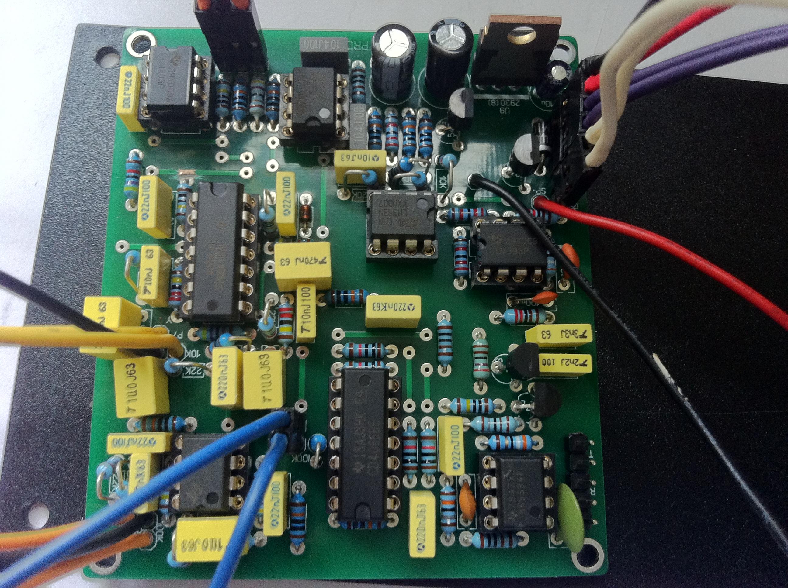

      • there is too much fraud
        This Is My DoG PCB
        I have Test Voltage
        RX 2.7
        TX 0.00
        That PCB I Buy From silverDOG

            Without an oscilloscope you are going to find this extremely difficult (and I mean "extremely difficult") to debug the problem.
            What do you mean by "I have test voltage: RX 2.7 and Tx 0.00"?
            You must supply more information before anyone can provide assistance.
            Between which points were these voltages measured?
            Which schematic are you using?
            What about the coil?
            What are the wiring details from the coil to the PCB?
            Does TX=0.00 not look suspicious to you?
            There are so many questions...
            • Show me the simple where is the test point for oscilloscope
              i think i don't getting wrong about my coil
              the rong is the board because there are no voltage on TX
              Show how to fixed the board

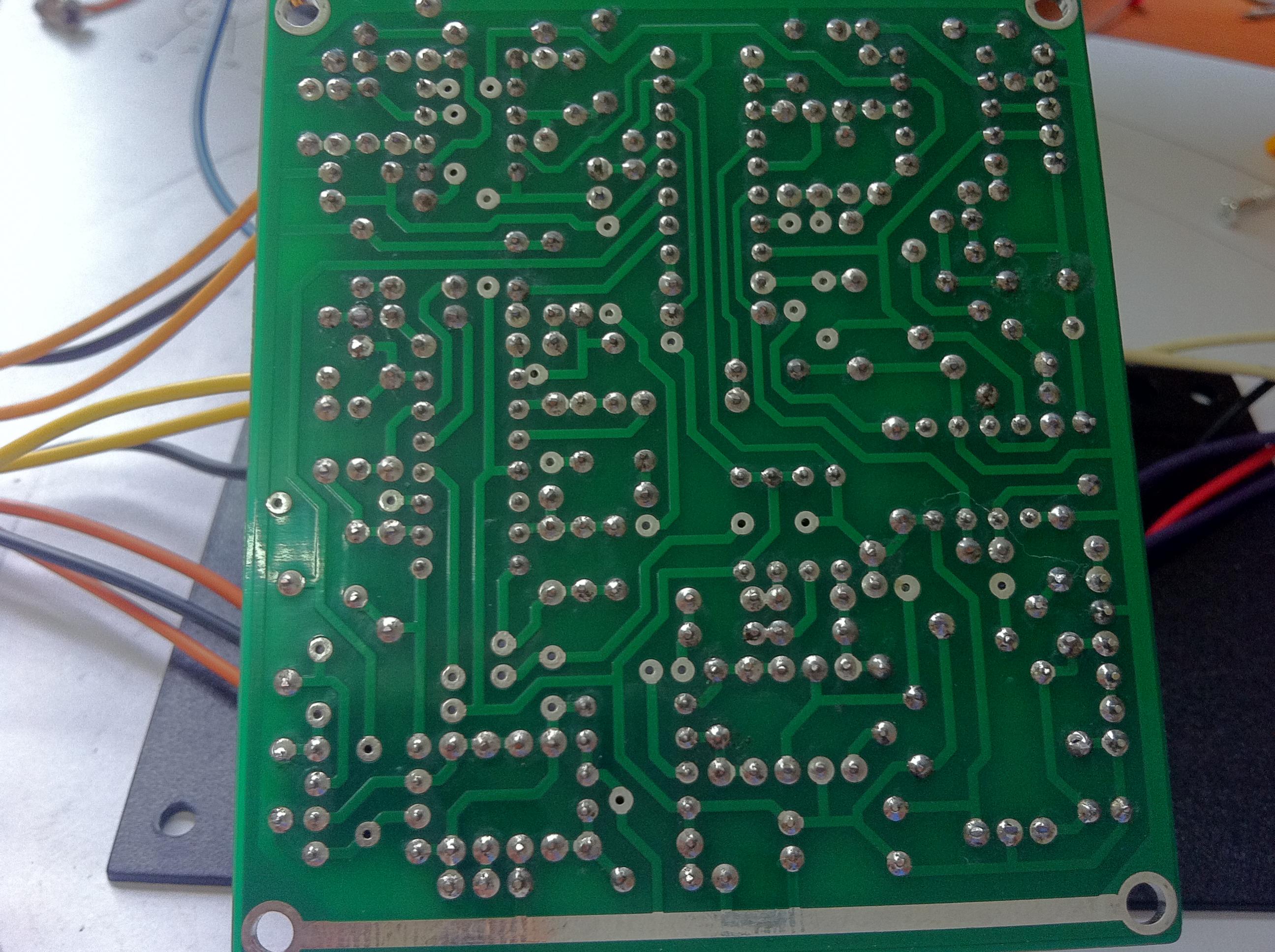

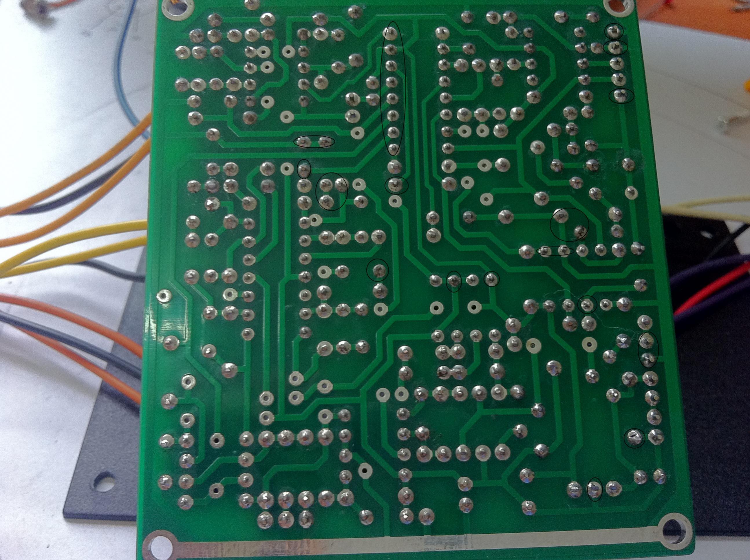

                    • We will help you PAku but be respectful. Your pcb had a short - you cleared it. Now you have a working PCB - you have now no argument.
                      The Build you did looks to have the right parts on, placed on the right way.
                      My observation from your pcb is check the quality of the soldering. It may be a trick of the light, but there are some low quality soldering there.
                      I have ringed some examples - you may need to ZOOM IN - especially the connector pins to top right - two of these look DRY

                      What battery did you have on this?
                      Do you get 8V out of the regulator?
                      S
                        [ATTACH]25971[/ATTACH]
                        S
                        i use new 12v battery pack
                        i just get 4.75v from regulator
                        i will take new picture for that pin
                        thanks golfnut

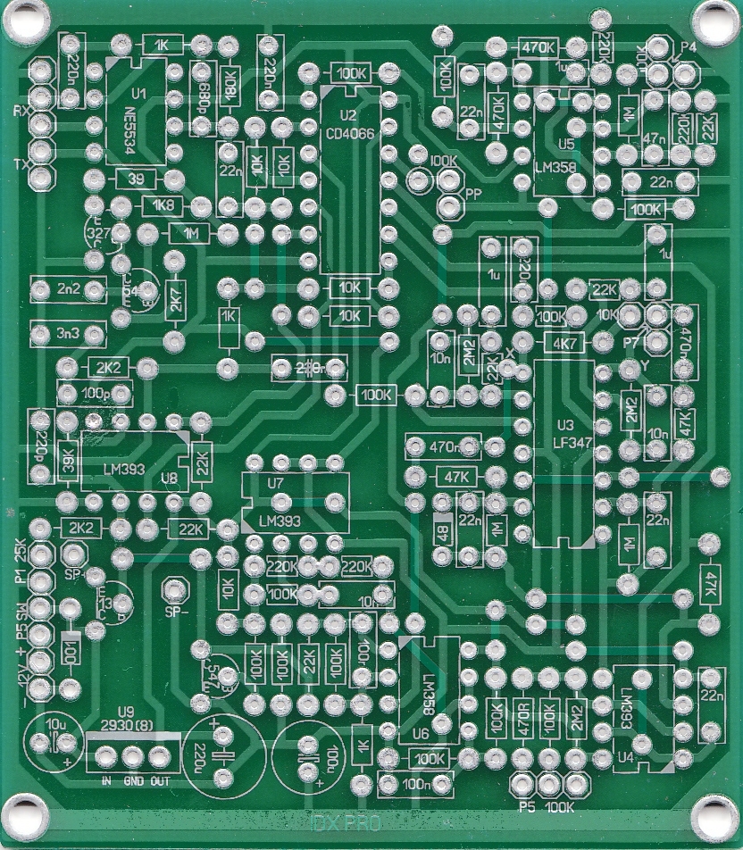

                          • I dont know all of the facts, as Quoazi also says - it can be difficult to debug for all concerned.
                            When you test the Tx coil needs to be attached - this is the only condition the Tx can work properly.
                            There is a thing with the supply and ground on these designs which is not obvious and it is this.
                            The pcb ground around the edge of the pcb is not 0V.......... it is at 1/2 of the regulator output +8 / 2 = +4volts with respect to the Battery negative -Ve terminal..
                            So try this with your meter on DC volts. Attach your Tx coil and battery - switch unit on.
                            Place the -Ve black meter lead on the Battery -Ve terminal
                            Place the +Ve red meter lead on the Input to the Regulator --------------- should be +12V while the unit is ON.
                            Place the +Ve red meter lead on the Output of the Regulator --------------- should be n+8V while the unit is ON.
                            If good move on.
                            place meter black PCB edge ground copper..
                            meter red to Regulator output .................................... should be +4volts
                            meter red to battery -Ve terminal ................................ should be -4volts
                            If good move on
                            Put meter on AC volts
                            place meter black to PCB gound copper edge
                            meter Red to either of Tx coil pins TRY both - ............ one of them should read approx 10 to 15 volts
                            • Merged top and Rear copper traces - like Xray - for debug.

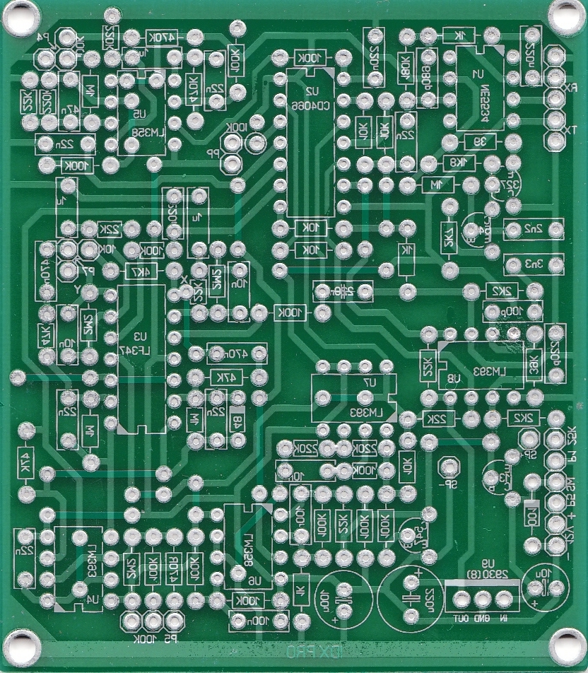

                              • And for completeness .... Viewed from the rear side..
Name:	viewed from rear Merged top and rear tracks.jpg
