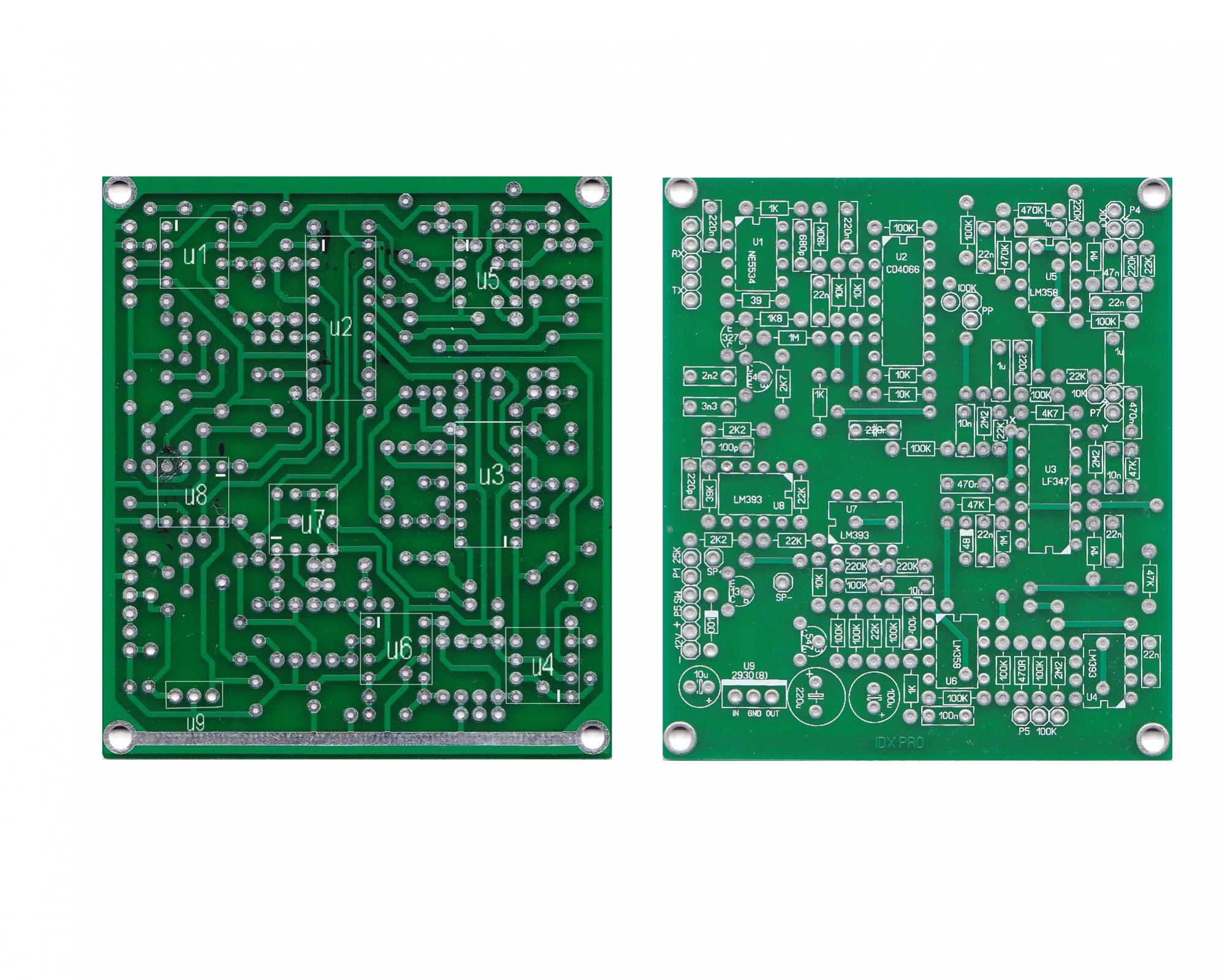

          • IDX pics to help debug from top side and trace signals thru... SClick image for larger version

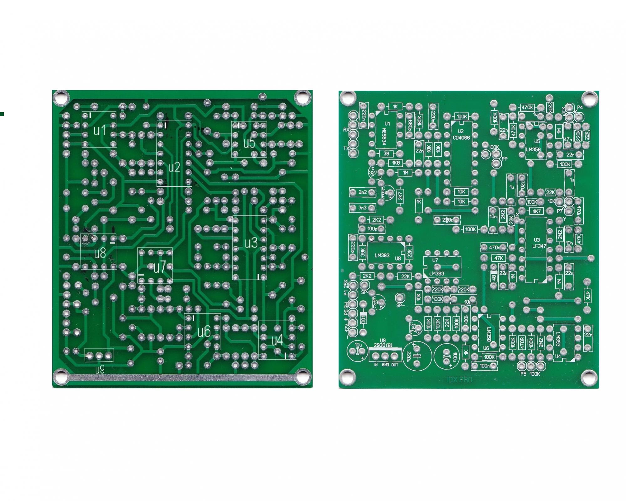

              • U2 outline tweak this is betterClick image for larger version

                  • Can you post a picture of your idx board?
                    That would help a lot.
                    • Is it possible you have an IDX board with the short circuit on? you need to look at the IDX thread here ( http://www.geotech1.com/forums/showt...PRO-VDI/page54) and check your board carefully.
                          golfnut
                          have post the picture the board dont have trimpot dont have 3 Diode
                          you can see the board from silverdog picture http://www.silverdog.co.uk/shop/imag...t-1024x768.jpg
                          that its not same like there ar post to me
                          • post a picture of YOUR board..
                            i will look at it and compare with my board that works..

                              Hello Paku. Sounds like you had not read the entire thread. Clearly, in this version missing trimpot diodes and there are also different values ​​of resistance in the control sensitivity in other versions.There are three or four versions of Eduardo's circuit! (Which is different from White's original diagram) and each of us tried the different settings (or new ones) to make the IDX work to our personal taste.
                              I personally chose the Silverdog PCB configuration (though my PCB is made in house) and everything works fine.
                              Post some good pictures of your board and your coil and so surely the most advanced forum members can help you (if there IS a solution for your problem)
                              Fabian
                              • yes i have found the short circuit on that thraed
                                PCB from silverdog. It is short circuit X and Y signal
