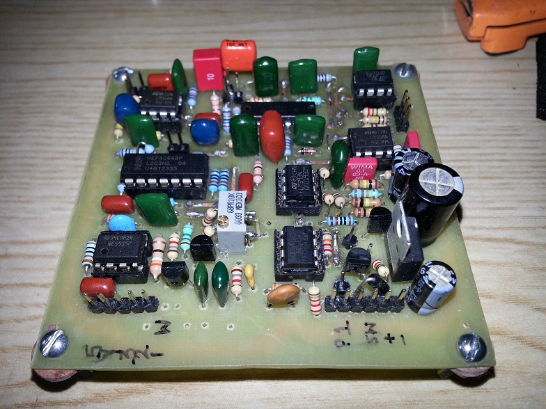

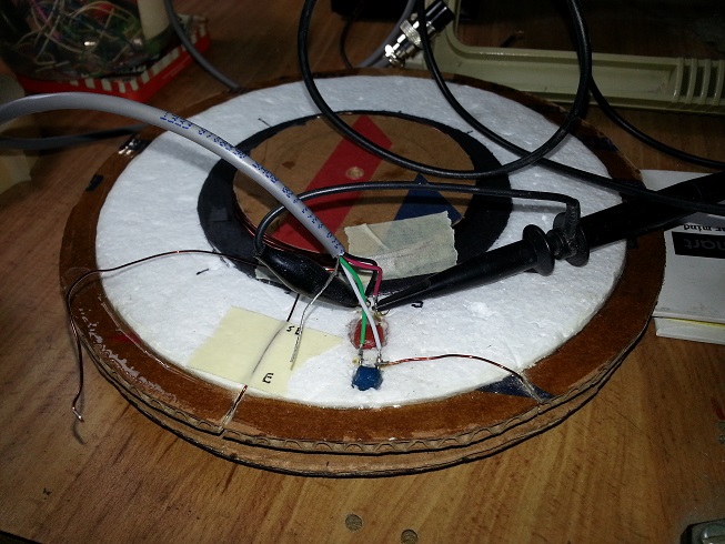

  • Hey koala & all.. I finally finished the pcb and Don's coil and not getting results - not even close. Uhmmm help?
    1) the mpsa13 fried (despite an 8ohm low watt speaker) so I replaced it with a 2N6039G and heat sink - the heat sink gets hot after a while - is that normal?
    2) am getting aprox a 6.5khz signal out of the speaker and about the same across coil caps. I need help nulling.
    otherwise .. hey, nothing exploded (beside the mpsa13) so I can't complain.
    • MPSA13 should be cold something is wrong. Check all resistor values with meter only two measure wrong because they are in parallel. Make sure transistors are the right way round especially if you have used equivalents. Post a good quality image if you can't find the fault.

        you make CC coil ?
        if make DD coil all my friends and gurus help me just read last posts
        • Originally posted by Koala View Post
          I'm going to reinstall the mpsa13 check for faults and upload pics. Its good to know the 13 is supposed to be cold.. thanks.

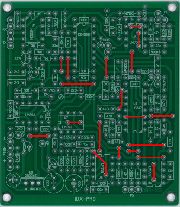

            if you can not find error, make mirror print (180deg) of this pcb and check with your pcb to find any error in teragets (copper lines on your pcb )
              Thanks.. already did that. Click image for larger version

              So far I've found 2 shorts and 1 incomplete trace.. good grief. Anyway, I'll be back-tracing from Eduardo's final pcb - the one without the diodes.

                you should remove one of them
                and i put for one of them 2.7zener ,careful 180deg turn it .
                i sure make mirror print (180deg) of this pcb is very good for find the errors.
                and you can change another values in last posts of this pcb.just remove one 4148.

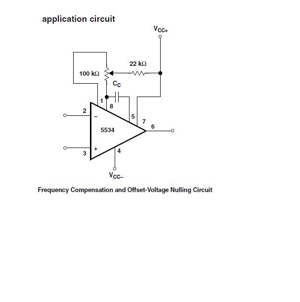

                  i add Attachment 26873 and in this i put for C , 100n( between pin5-8 ne5534 )and my nulling figure is 650mv(ne5534-6)
                  then :
                  i put the SENS on the max depth then find the best caps for the RX coils (stability and best depth near 32 - 33cm for 2000Rial )and it is for me 22n+22n+1.8n+1.8n

                    ill give this a try
                    I got it working marginally, detected aluminum and copper .. the signal is weak. If i turn up the sensitivity its crackles - saturation?
