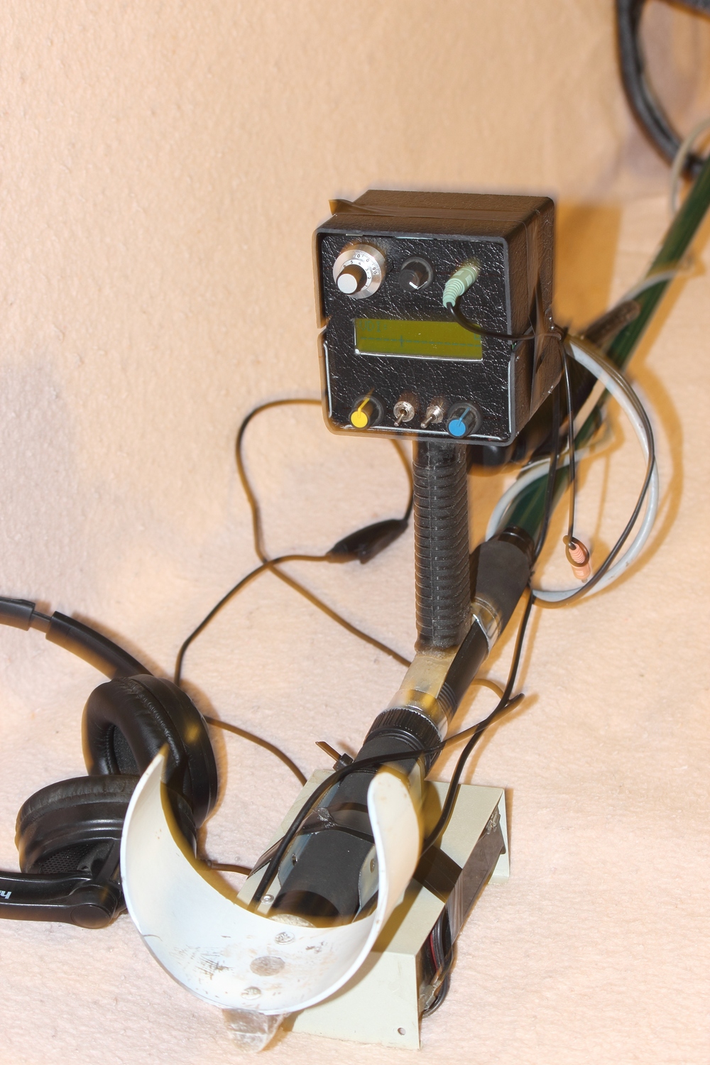

  • hello guys I was looking at this project, are not practical electronics, but according to you and 'feasible to do? I have several months of free time and I wanted to build it, buy the kit and 'this true?
    http://www.silverdog.co.uk/shop/inde...product_id=124
    as is' I can mount it or is there 'to make some changes because' functions?thanks
    • Do it as it is in the kit.
      • That's a good kit. Build it as it comes. The coil will be a bit more of a challenge.
        Maybe look for a used White's coil online? That will guarantee success!
        • yes, I have seen on youtube who used a White's deep scan 950, so I'm saving all my hair
          • My idxvdi

              guys, since I have a coil garrett EUROACE (350) I do not use, do you think there would be a chance 'to make it work with this project?
              • hi barry this is worth a go if you have not built it already,VDI_02.zip

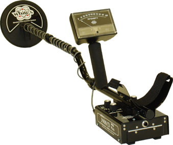

                  • hi barry i put a bounty hunter coil on my md6006(cheap china), and its like a different detector, i built the vdi for the hell of it(my idx is original), i figured if it breaks i can replace it with my home made.
                    i also planned to put it on my whites 3900 proplus(commercial detector) but thought better of it when you get 2 years warranty only a fool invalidates it, it has an analogue meter but its great an exellent detector for 235 pounds brand newClick image for larger version

                        i also planned to put it on my whites 3900 proplus(commercial detector) but thought better of it when you get 2 years warranty only a fool invalidates it, it has an analogue meter but its great an exellent detector for 235 pounds brand new[ATTACH]28849[/ATTACH] in fact since i got it i have not used my idx.
                        HI S./USER ,, Great looking detector that Whites nice big analog meter as well ,,..
                        OK on the MD6006 fitting a alternate coil,I will try to build a coil for my elcheapo as well MD3006-GC1006.. maybe same as yours ???? mine had a omega-7'' coil ,3x tones etc etc I like the meter on it ,would like to adapt similar to my IDX ..
                        A friend of mine just gave me 2x Fisher-Wands with coils but No Controls I have adapted one to my IDX 12''x6'' ,the inductance was all different ,but played with caps & got it to work ,GEB etc OK ,,.not quite as sensitive as my last H/made 8'' But maye on ground who-knows ???

                            hi barry as long as you get a coil near enough to you china cheapie you can make it work, you need to test the khz, some of the detectors like ours are 6.5khz for those old bounty hunter, fisher even some old whites 6khz work better than the stock chinese coil, you know how to tune using caps so your laughing.
                            but if yours is one of the 14khz versions then there are old coil swaps that will work, but you have made a coil for idx, so for a 14khz coil i think you would be better winding your own coil dd or concentric, that will still out perform the stock china one.
                            i'm winding a 14khz coil for a detector at the moment(small dd), but i'm very early in the process.
                            by the way the 8" concentric bounty hunter coil i got was 10 quid off ebay sure its old but it works and was as cheap as chips, and detects 3" deeper than the china coil(8" total on soil, 9" dry sand, 6" wet sand).
