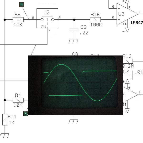

          • Hi,
            I've build my own IDX from Silverdog and also build a searching coil.
            TX dia 23 cm (9 inch), wire 0.7mm (21G), 0.587 mH and 1μF cap
            RX dia 10 cm (4inch) , wire 0.18mm (33G), 35.6 mH and 58nF cap
            When I try to set up it then the sensitivity is very poor.
            I checked the winding directions it's OK,
            I measured a very interesting thing when I used 1uF cap in TX coil the RX has totally same frequency about 6.5 kHz
            and then when I used 2uF for TX then the frequency of TX and RX = 4.6 kHz.
            I don't understand it...
            My DISC gate signal shape is similar than golfnut's (thanks a lot for it )...
            What did I do wrong? Where I have to start the investigation? Any idea?
            Laxi
            • Originally posted by LAX View Post
              Laxi
              The RX and TX should have the same the same frequency it's the phase that changes with a change with a change in RX caps
              by tweaking the RX caps trail and error you should be able to increase the detection distance but don't go too far that ground balance or disc fails. Also if tuned for max depth in air test the coil can become unstable over real ground.

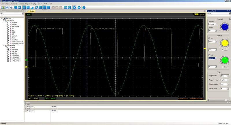

                    • Hi Lax, you Disc Gate wrt Tx should be more like this.. S
