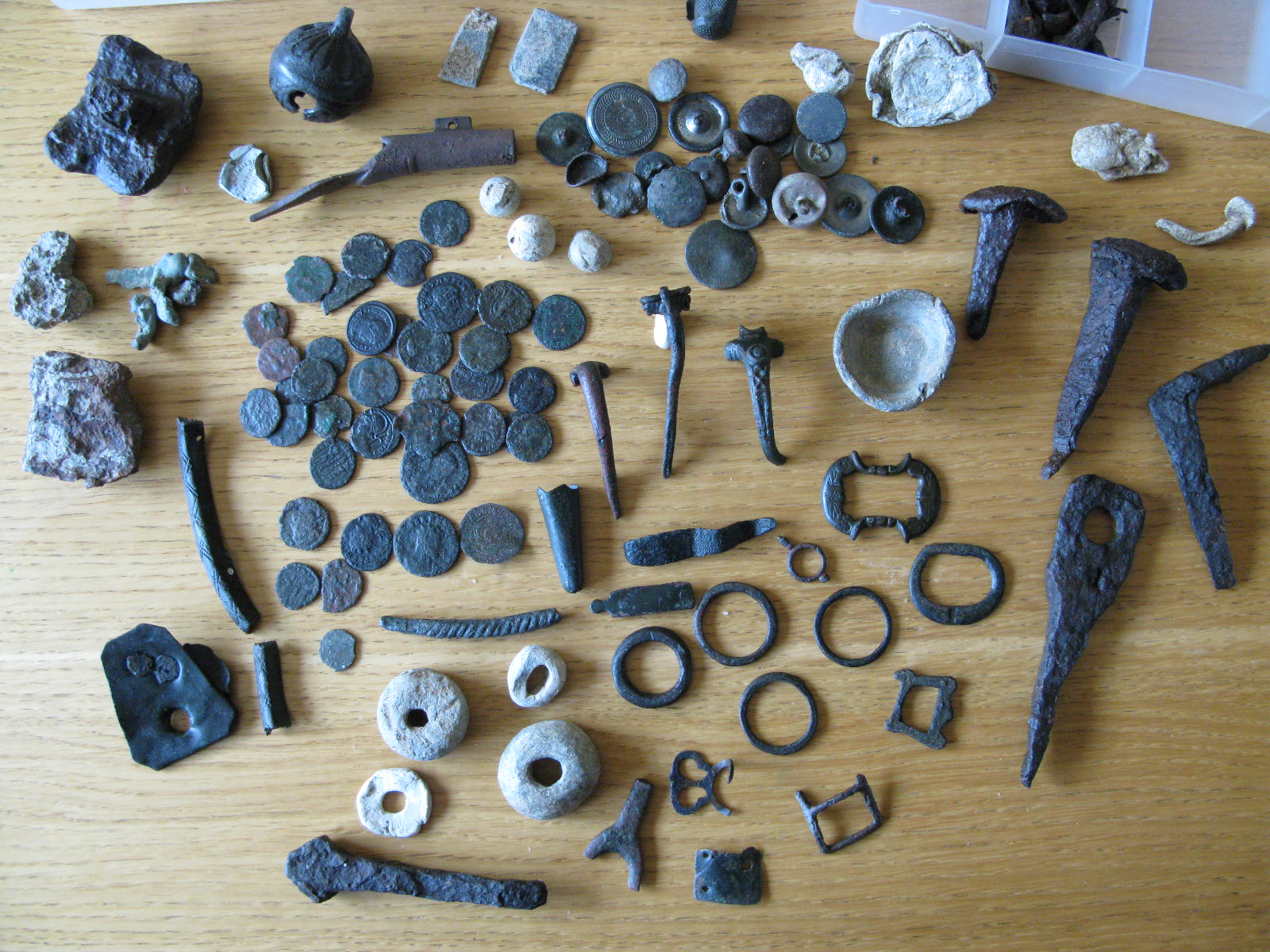

      I used my IDx at 12.5kHz on homemade coil and found these.

      I used it at 14.5kHz on a NEL Hunter coil and found plenty.
        [ATTACH]32175[/ATTACH]
