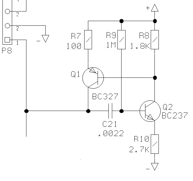

          who can explain me simple discrimination in schematic on IDX?(just know which parts work to this and how?)
          • You have 3 channels in IDX: All metal, motion GB, and motion discrimination channels. Of these the All metal is used for pinpointing in a quasi non-motion way.
            GB and discrimination channels provide actual discrimination. To grasp it you have to picture a diagram with metal targets responding to a sinus signal stimulus. All metals will have a response somewhere in between 0 and 180° from Tx phase, but ferrous will have it in 0 to 90°, and non-ferrous will have it in 90 to 180°. Both motion channels are used for discrimination which happens in comparators that perform AND logical operation. There is a beep when both GB channel and disc channel provide positive signal at the inputs of comparators.
            How it goes? Say you adjust discrimination channel phase at 90° sharp. GB channel is aligned with the soil response which is in vicinity of 0° and it goes positive if response is in 0 to 180° range, and discrimination channel goes positive when response is in 90 to 270° range. It means that both channels will give positive responses only if a target response is in a range between 90 and 180°.
            If you want to exclude aluminium foil from detection, you simply adjust discrimination a little over 90° (say 100°) and your discrimination range becomes 100 to 180°.

                  Hi my friend, trust me, it is not complicated.
                  1-the R axis corresponds to GB channel. It has a zero response only for ground response, and ideally for objects underneath a coil it has positive response for all metal objects imaginable. X axis is equal to Disc channel, and it has positive response for non-ferrous, but negative for ferrous objects.
                  2-you can use any frequency you wish, and the same principle works, but the coils are well balanced for a range of frequencies, and some Tx oscillators are not working if coil Q-factor is below optimum for a given frequency. Many devices have audio synthesized from Tx frequency. So everything considered it is much easier making a device for a single frequency. Square wave Tx and somewhat different front end makes it possible to extend frequency range, but that is not IDX. IDX is a device optimal for relic hunting, and frequency is chosen accordingly. Changing a frequency within one octave will not make significant difference anyway.
                  3-preamps in VLF have a much easier, but completely equal role as in PI detectors. They are never turned into saturation as in PI, but everything else is equal - they have to improve input S/N

                          first analysis TX :
                          i see 2 bc237, what do these?(say better for why?)
                          and then lm393 do disc and GB.then 4066 (is switch) how work? Rx when amplifier by ne5534 go to 4066.how 4066 switch?(what parameter is important to switch)
                          excuse for my English

                                this is my analysis fo this pics:
                                when TX coil send waves to targets and find any metal , so this part protect the TX or i am mistake ?so better say if we delete this part how tx work
