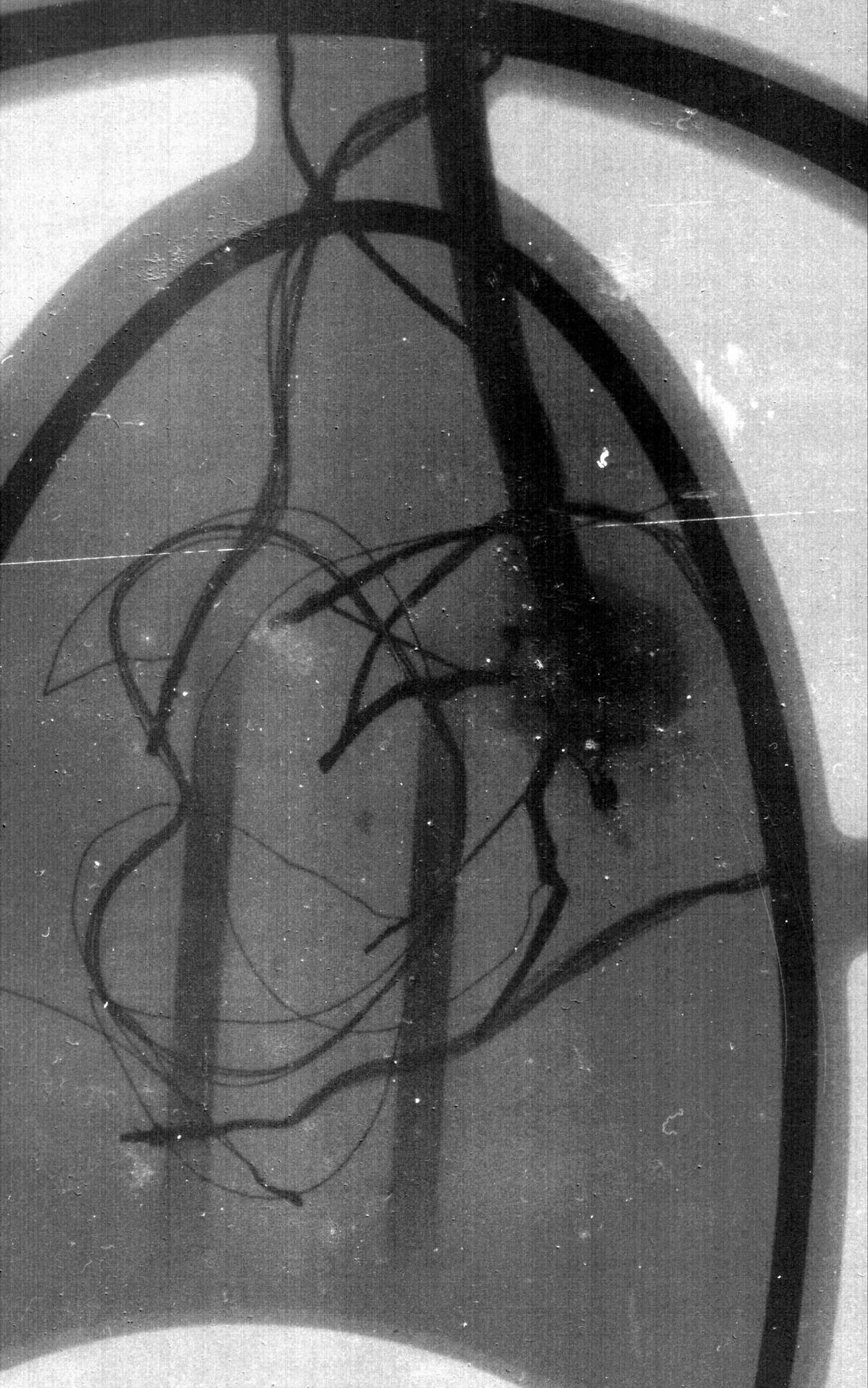

      • hello, this is my first post I have made IDX from this topic and it works well ,. I would like to thank Mr. Eduardo1979 and all members of the forum ,. any question,.. I made a concentric coil model. what is the ideal resistance of a shield of graphite powder, ?? I mean centimeter, I have mixed the liquid pine tree sap with graphite powder and got a random value from 4 ohms to 13k because the powder was applied unevenly, .. sorry for my writing #Google translation

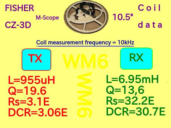

        • Hello to everyone,
          TX-26cm 0.70
          RX-13cm 0.20
          CX-13.5cm 0.70
          coil inductance values at original scale.
          tuning and resonance,
          not in the navel.
          as seen in the video
          how should i solve the problem.
          Yours truly

          • Originally posted by santos View Post
            Should be 1.5k per square cm...
            • Originally posted by CDI View Post
              ???? why? take any antistatic pocket you bring HD and measure resistance. you will see there is no resistance, infinity,
              while those pockets we know are best.
                thank you for the answer, I will try to get it
