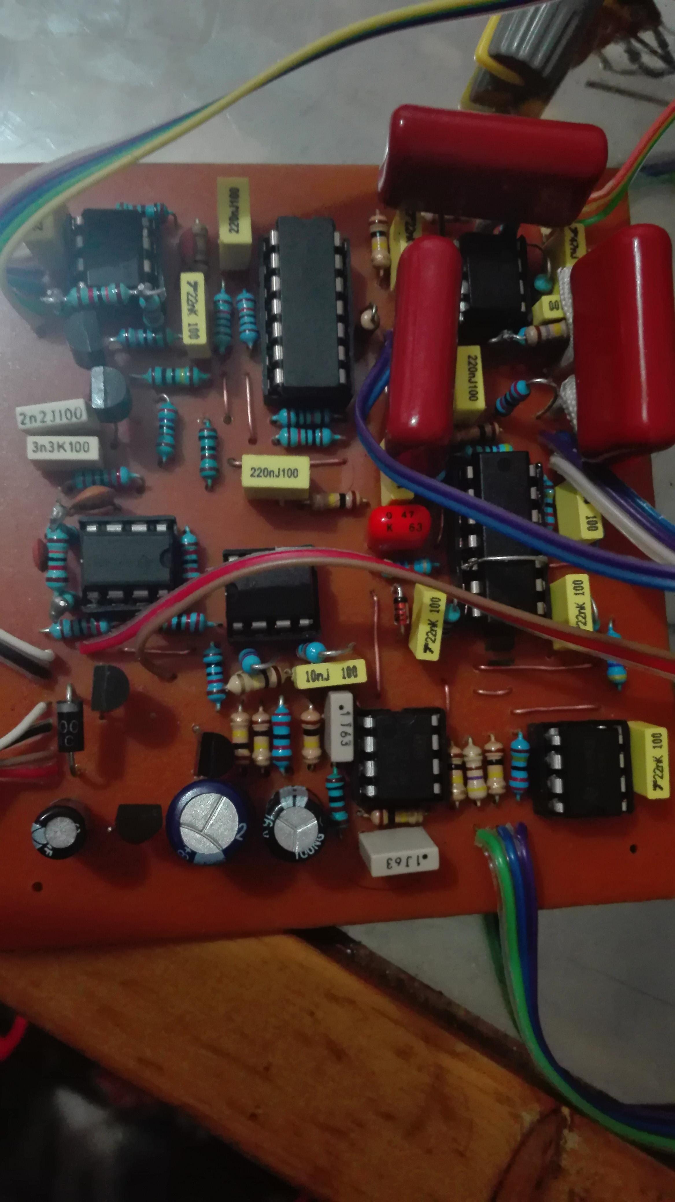

                  • hi , i have just finished my idx but it's not work properly,it just beeping in pinpoint mode without sensing any metal.
                    and only GB pot change a little this beeping.it has low ac voltage on tx connections
                    please help what should i do?
                    this is my idx photo:

                    • i solved my problem by using 39 instead of 39k hahaaha,, (stupid mistake!)....
                      now it works but Tx has 4.5v~ and detecting depth is low, should i check or change anywhere???

                        How are you measuring the peak to peak. My fluke will measure very low where as fine on a oscilloscope

                          Tx must 8-9 be volt's, depending on which voltage stabilizer you are using.
                          Try to change one by one IC. Next thing you can try is to change frequency.
                          Use 330N for Tx and 8-10N for Rx stage.
                          Also, R32 can be little raised, instead of 220K try to put 370 - 470K for slower reactivity, this will give you more depth.
                          All this can't help if coil is not nulled optimal.
                          • i measure Tx voltage with multimeter, turn it to rage of 20v~ and attach red probe to tx connection(when tx coil is on) and other probe to gnd ... unfortunately i dont have oscilloscope...

                                Probably fine on the Tx
