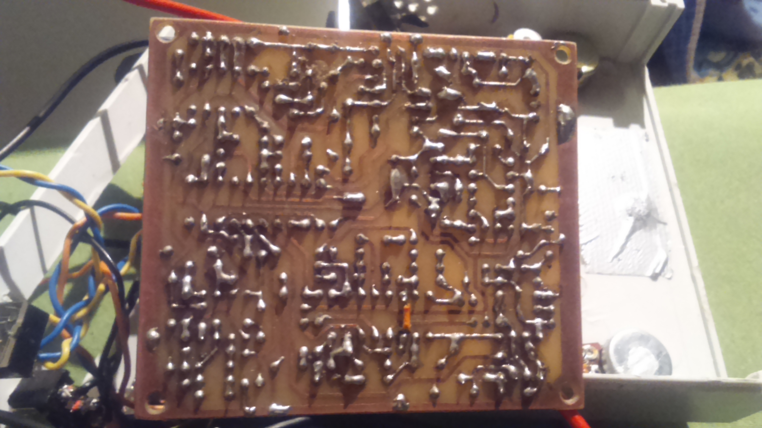

        • Why I have continuous square sound from 400 hz from U7? With all other iCs removed I still have that sound. Please for help.
          • Originally posted by kaligula View Post
              yes, be cause U7 is a square generator. used for modulation of DC slowly shifting level so you could be able to HEAR THE sound in speaker.

                Thank's dude... I expected your answer.
                  But is it OK to hear that sound on the speaker or maybe transistor q3 is broken? And other voltages are not ok, please tell me where what to measure
