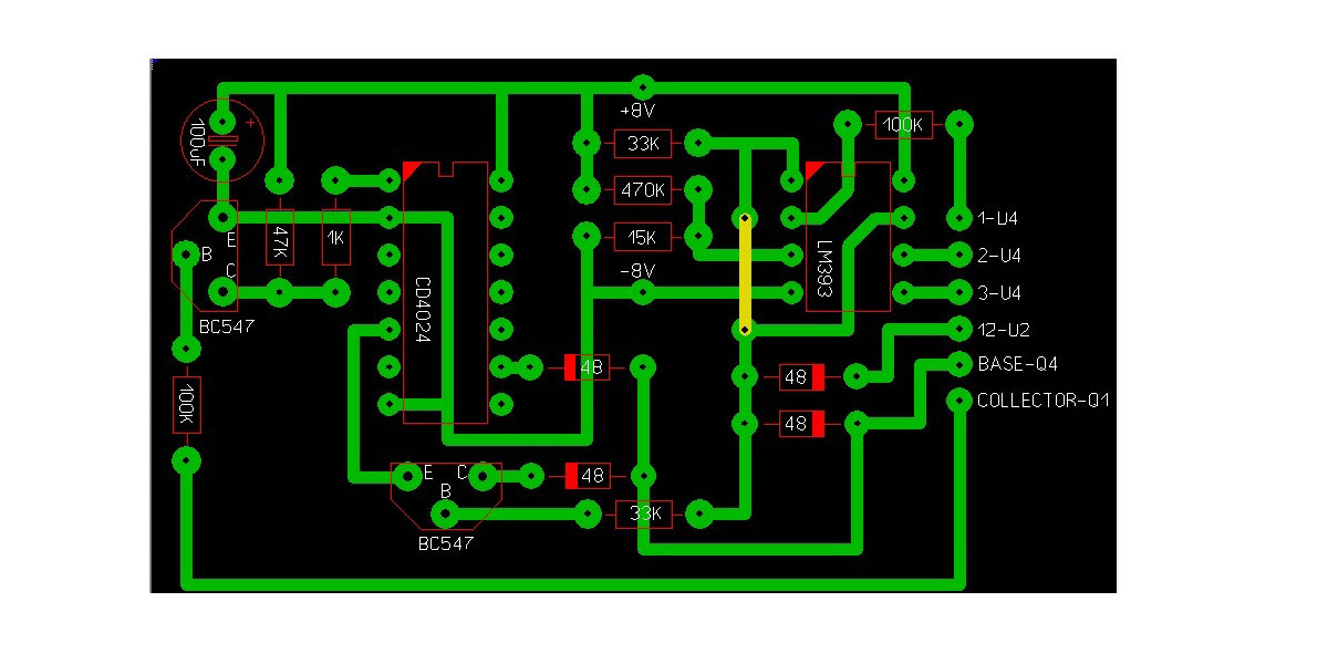

  • Can somebody show me connections for 2 tones pcb?
    I have idx version with 3n9 capacitor and phase trimer, not last ver with 3n3 and without phase trimer.

        Which two tone did you make there are several versions and they connect differently.
        • Originally posted by Koala View Post
          This one...

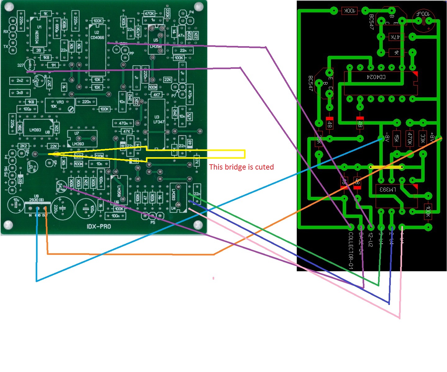

          I tried to cut bridge near mpsa13, connections are several time checked, but there is some weird buzzz sound when board is attached.
            My connection's.
            Is this right or not?

              You only have to cut the bridge if you want to add a switch
              http://www.geotech1.com/forums/attac...1&d=1374934038

                  • I did not make the two tone and haven't checked but it was the connections that were posted when people were interested in the two tone. The reason the switch was added was so you could disable it and use the detector as normal as the two tones don't like wet or long grass. You will obviously have to tap the power lines as well.
                    Two tone faded out for quite awhile as it disadvantages in stability out weighed any benefit. After all if you use minimum disc and high impedance headphones you can tell the sharp crack of iron compared to the soft rounded tone of none ferrous.
                    I will have to look back at the two tone properly as one version you had to remove a transistor
