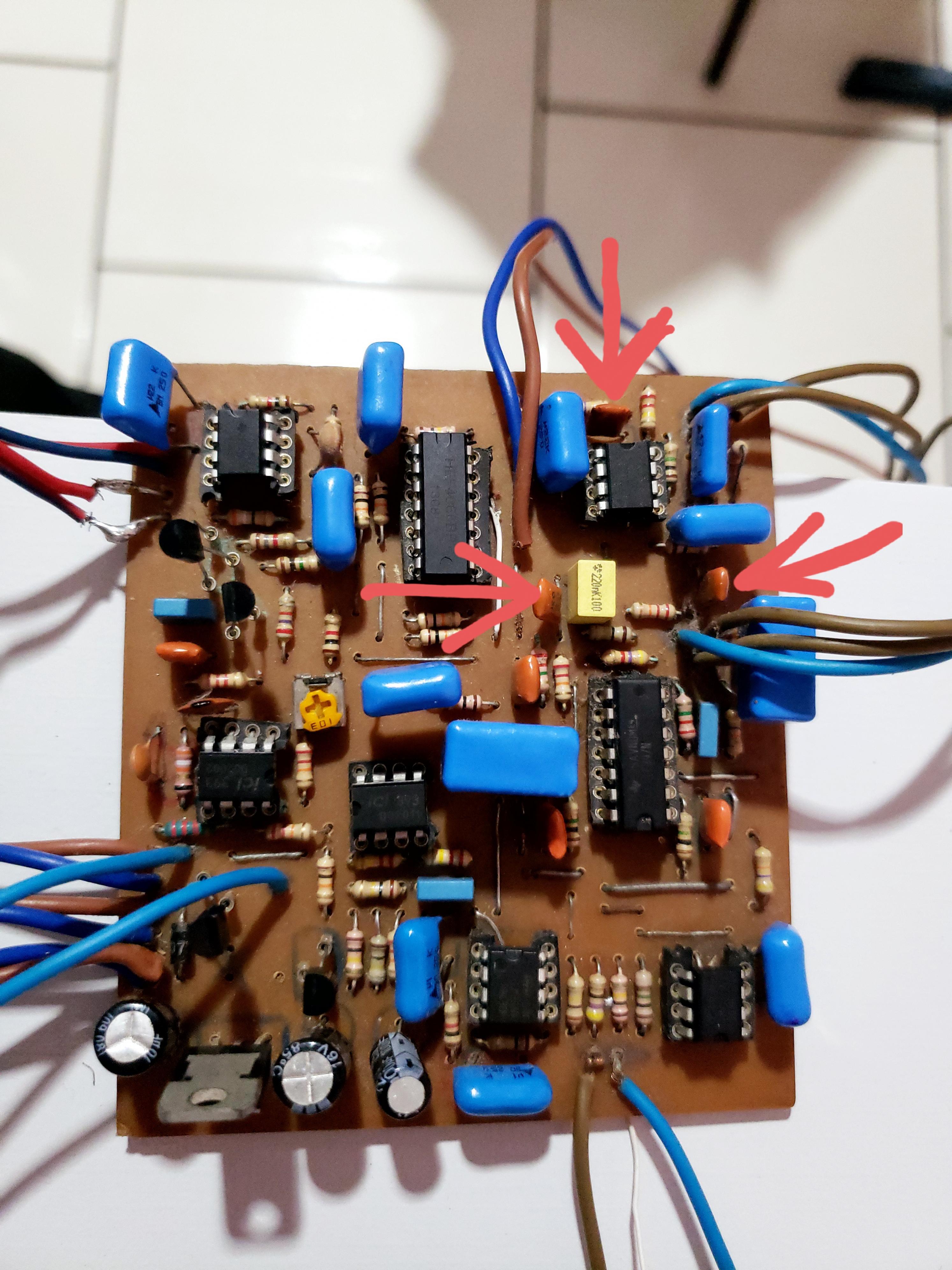

        good night I adjusted my coil at the null point it is at 8 millivolts it has improved the sensitivity a little bit it is taking a cell phone at about 20 centimeters but it still continued with the crackling sound like it was passing some object on the coil
        • I noticed that removing the U4 lm393 integrated circuit from the board it stopped bibaring and it worked normally, but with little sensitivity
          picking up a cell phone from 20 centimeters I have already put another new lm 393 in its place, but when I put it on the sound starts to crackle again

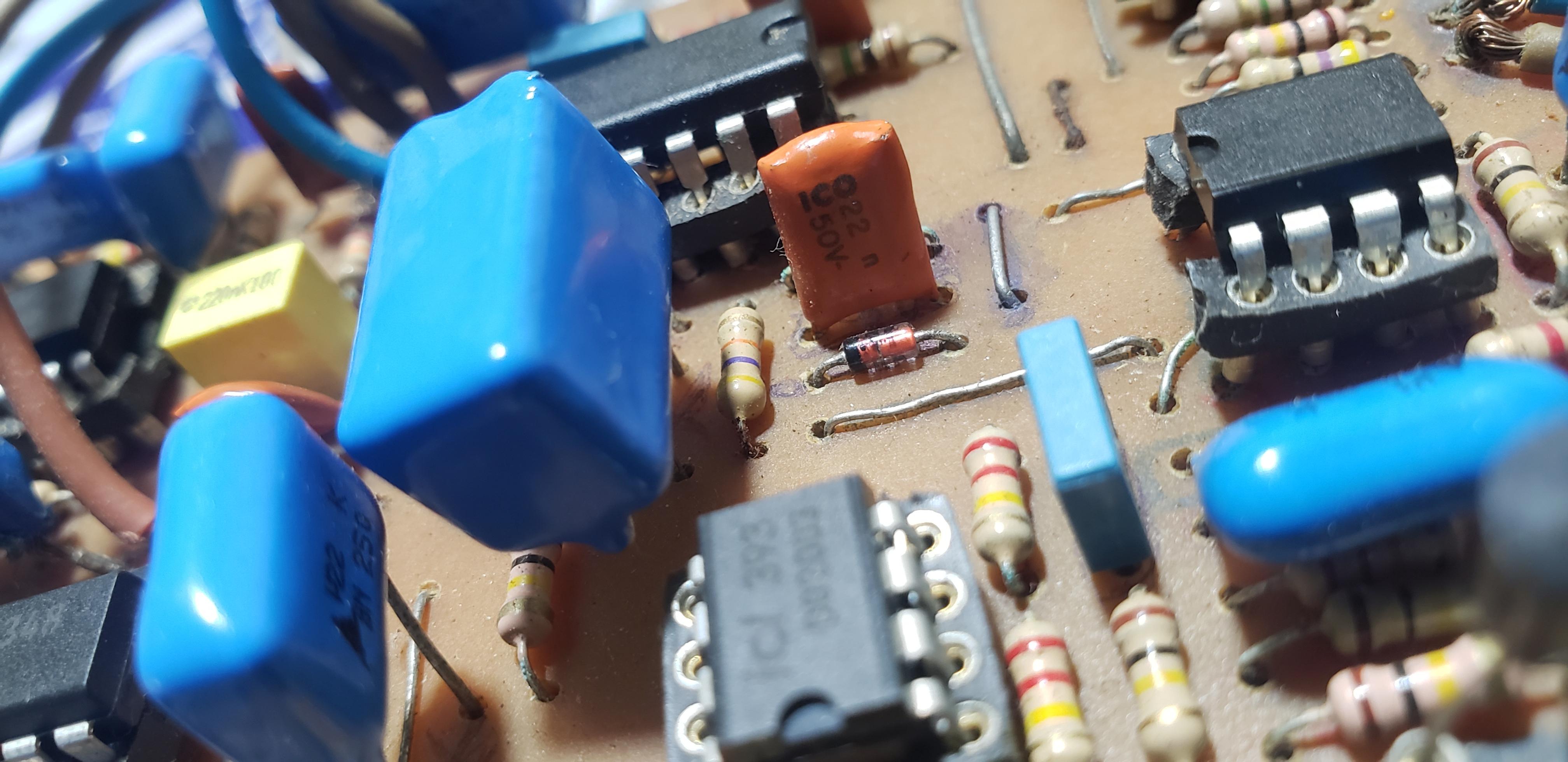

            • I think I put this capacitor wrong in the picture it shows 22 n this space means 220 n I think
              the correct capacitor is 22nClick image for larger version

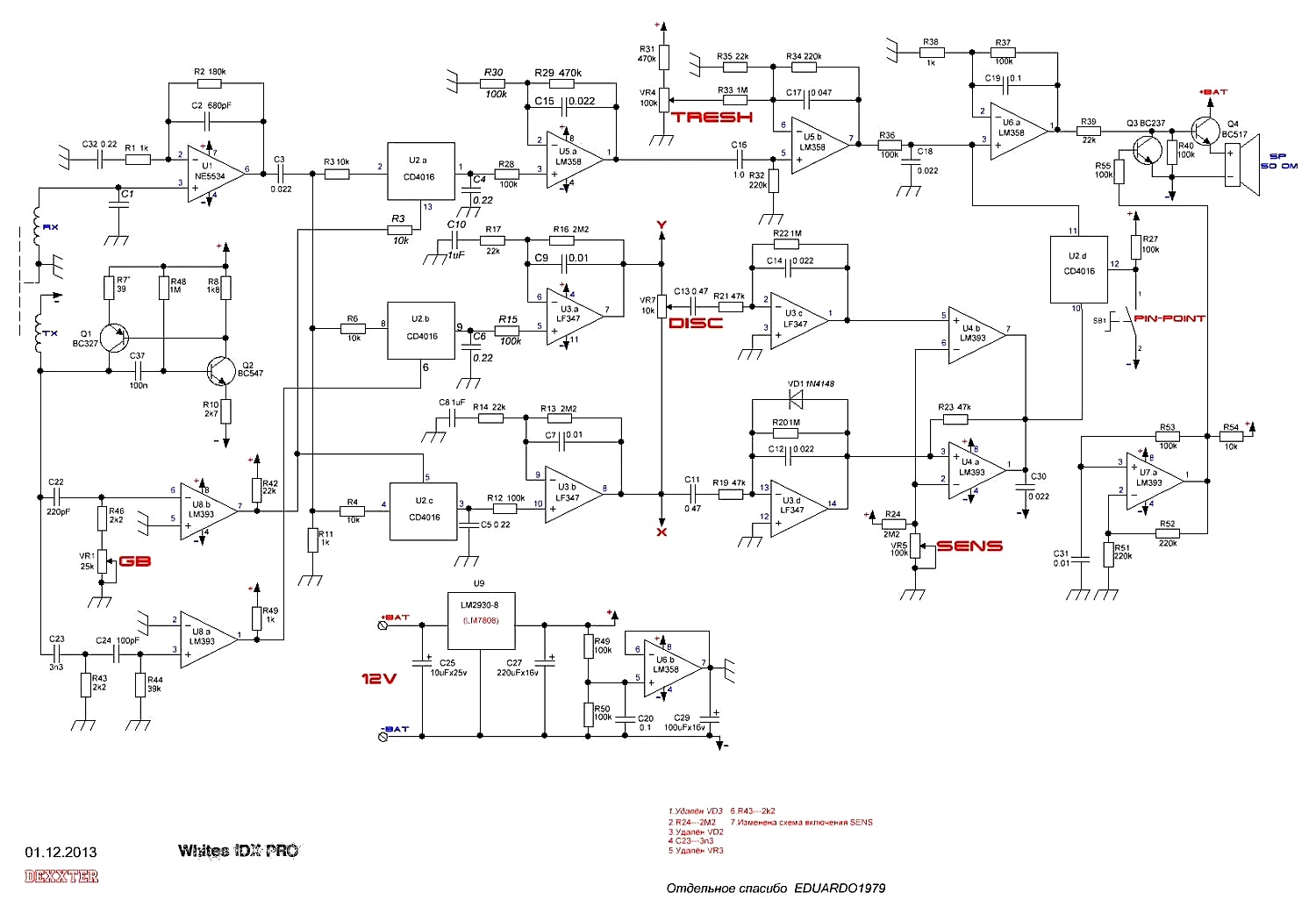

              • what is the function of the 10k VR3 on the board
                    good morning I found 3 more wrong capacitors, these 3 marked in the photo I put 1nf and the project is 1uf I think this is the biggest mistake
                    • Originally posted by Uiliam950 View Post
                      [ATTACH]56175[/ATTACH]
                      Can you post a copy of the schematic that you are using?

                          C8
                          C10
                          C16
                          they are 1uf capacitors and at the time of assembly I got confused and put 1nf capacitors
                          • After replacing the capacitors, is the board working again?
                            • I'm waiting for the order for the capacitors to arrive

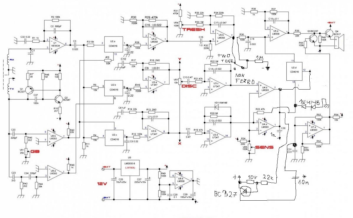

                              • Whites Classic 3.Two tons of discrimination. It's easy. The three channels work together. Click image for larger version
Name:	whites two tone.jpg
