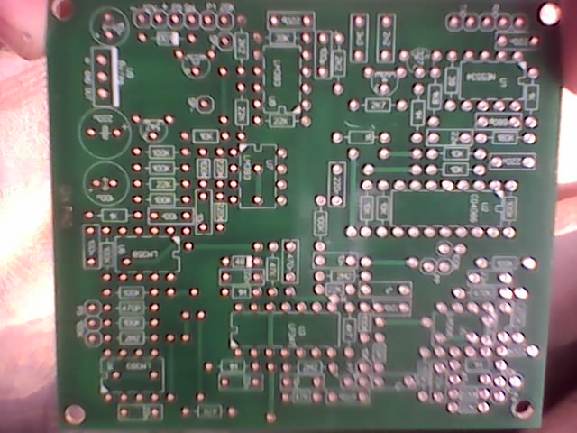

    • Refering to my Silverdog pcb :
      The siverdog pcb does not include these mods below:
      What is the purpose of VR2 and P6 Button mods ?
      The Diodes D1 and D2 are only a Single diode on my Silverdog pcb.
      Why are there 2 Diodes on the schematic mod ?
      And, what is diode D3 for - which is not on Silverdog pcb either ?
      Last, What are VR1 and VR3 for ?
      Also, not yet added mods.
      What do these calibrate ??
      Could THESE Missing Part Mods - be part of the Noise issue ?
      • the reason! that is NEW Board of The last version no need to add any trimpot on board just figure out you board to be stable first
          i would go for 7,8 keep the measurement of linear signals, the vdi wont "see " small targets (same as a deus)
          with 1,14 the geb on 14 is will be non linear due to diode feedback. so the integrity of the phase relation gets lost.
          Would Pins 1 and 14 be usable if the Diodes were Disconnected ?

              VR1 = geb Balanse of land, rechaso ferrita.VR3 = for phase change

                • Originally posted by onuba View Post
                  These sound useful, especially VR3 would help a lot for Tuning,
                  Will definately add these Mods !
                  - Thanks.

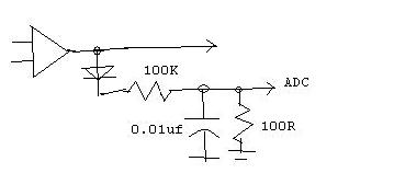

                  • I see a lot of mixed numbers in my VDI output.
                    Maybe the outputs would be better buffered ? :
                    - Like from the OpAmp Outputs, to a Diode to a HIgh Impedence Resistor then to a Parallel small Cap and Res to Gnd ,
                    before feeding it into the Arduino ADC Ports ...
                    Something like this :
                    - Click image for larger version
                    - Or some values, I am not sure, need to test.
                    Enough to pad the output Voltage average SUM into the Cap to have ready for the ADC, say for 1/100 Second Period storage time (RC=100Hz).
                    So, ADC input will have the Average Voltage for the last 1/100 second.
                    Do this, instead of taking an average of Pulses by 85 ADC Readings on the Arduino.
                    I think the Arduino VDI is reading Highs and Lows from the Input Wave - and getting too much random data ...

                      • I tend to agree with everything you say here, the one bit that isnt great is the series diode in the drawing.
                        Signals < ~650mV would never be measured due to Vf on the diode
                        You could try an opamp sample and hold - activated by the user, during target hit with manual reset..
                        (one per CH)
                          (one per CH)
                          The assumption is that the RC Hold circuit is after an OpAmp amplifying each Channel.
                          The Diode is needed because the Voltage would usually average to Zero between Positive and Negative Wave Peaks.
                          Of course, I am probably just approaching an OpAmp Integrator Circuit anyway ...
                          Attached is a few Integrator Examples.
                          If Input Frequency is about 6.5KHz, then I would probably aim 6.5KHz in the Integrator.
                          • Originally posted by ampirate View Post
                            If : Chold=0.1uf=100nf and Rhold=9K giving Freq=177Hz-1.7KHz ;
                            Then say : Chold=20nf and Rhold=10k for 1KHz-10KHz .
                            Which would give reasonable values sampled at 1KHz.
                                "But all signals are too small to break thru the diode" You may try an opamp presision rectifier here, elliott sound products website has good one of these"
                                [ATTACH]30316[/ATTACH]
                                "" attachment wont open ""
                                "" no, after the mixer or sychronous detector, the I.F. or baseband has signals relating to sweep speed and are centred around 8Hz ""
