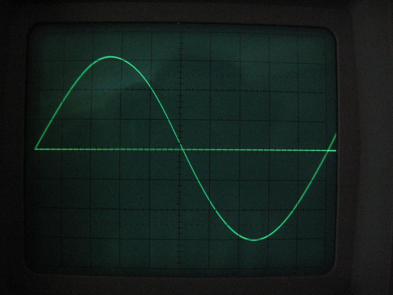

                  • You need to adjust the overlap of you coils to get lower amount of signal at preamp output.
                    ( Your preamp is saturating - signal heavily clipped ) You do this with scop attached - on preamp output.
                    Your Tx looks a touch triangular - which is a new one for me... Normally look like this .Click image for larger version
