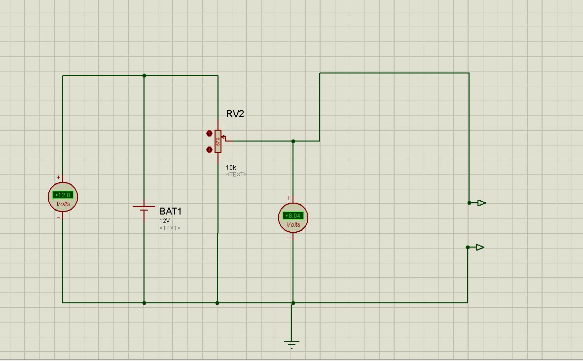

                • Originally posted by paku View Post
                  now im using 12v battery to run idx can i use 18v battery for my idx
                  Hi you can use this shema for 8VClick image for larger version
                  Or you can use regulateur to reduce the votage lm7808
                  http://www.kounooz.com/up/do.php?id=1084

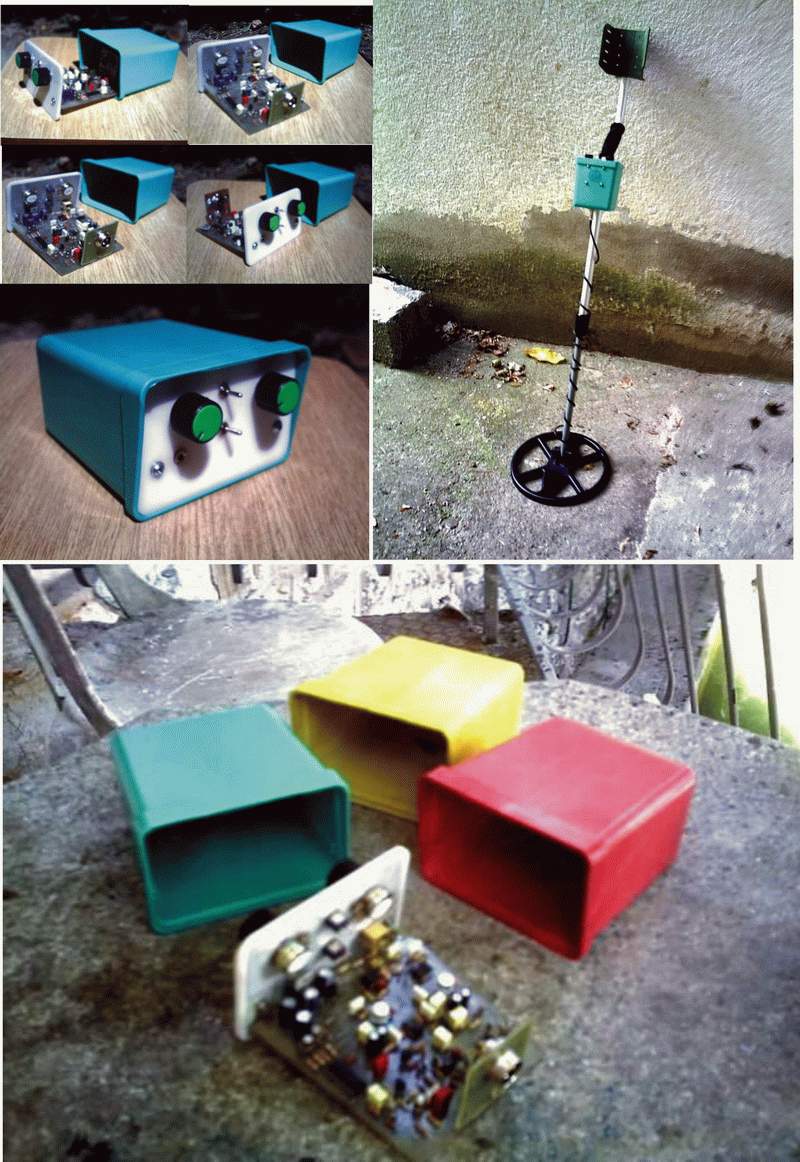

                      where can i get this plastic enclosures like this
                      • sorry no idea

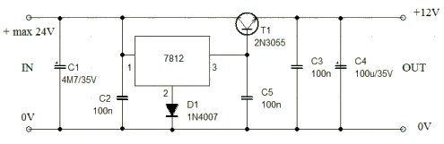

                            can i use this converter schematic for convert double 9v+9v battery to 12v on idx
