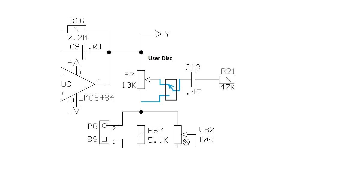

                              Try a toggle switch like this.. search all met then toggle to disc and see if it goes or stays the same.
Name:	disc toggle.jpg
                              Switch as drawn, is user defined DISC setting.
                              Switch down is ALL Metal - simples
                              S
                              • Thanks again much appreciated for the help.
                                Some of it has been user error
                                Been practicing with items I have found. One mistake I have been making is swinging far too fast. By slowing the swing right down and sneaking up to a 6" rusty bolt that overloads the MD I can easy see 2 pound coin 2" away with a nice clean tone in disc mode.
