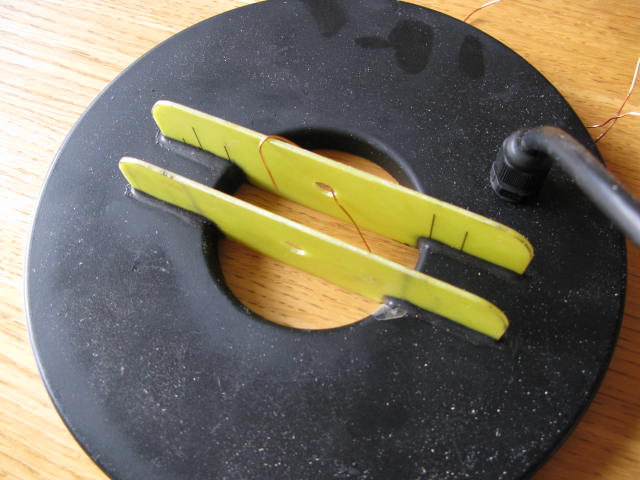

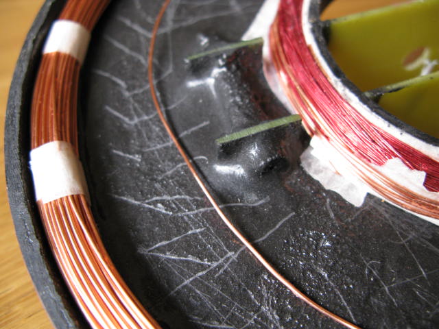

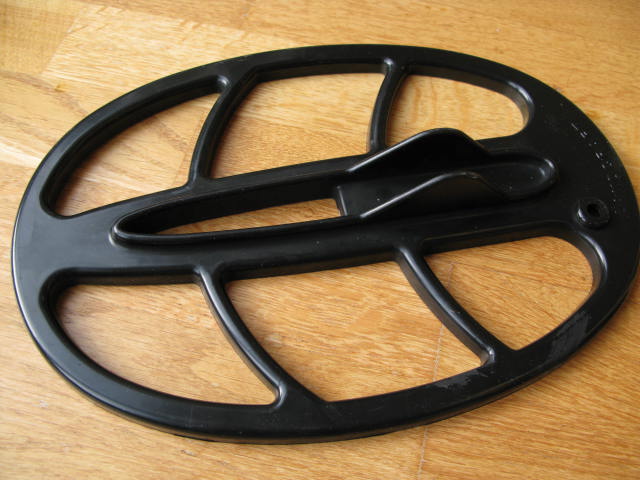

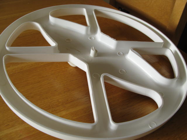

  • Hi, yes Barry, making one in a scratch cover is do able the hard bit is getting the mountiong lugs/ears done . I did a write up on here somewhere I made a concentric whith a whites 8 or 9" - quite thick plastic actually - rigid.
    Ive casted one in glass fibre and resin on a plastic camping plate one time, Ive made small monos on a kids table tennins bat - and pulled roman coins with it! Would not recommend - fiddly and heavy
    Georgi on here does a black 27cm DD shell and they are OK. - but often to get free post you have to buy 10 I think - check his terms in buy/sell section..
    There was a web shop in eatern europe the does shell too. .... here
    http://crazy-tech.net/index.php?rout...&product_id=53
    I have one of these in white if your interested - they are a touch heavy when potted as the central area is voluminous... I tack in loads of closed cell foam blocks and offcuts to reduce mass. Also the cable entry is right on the centre of these and looks a tad odd to me..
    The same site does an elongated DD type which Is in two bits a bottom plate with a lip and top half - which is more akin to regular shell. If you used this, you may be able to pop it open again and re mod if not happy with performance - just a thought, Bit like a teknetiks shape ... http://www.tekneticst2.com/

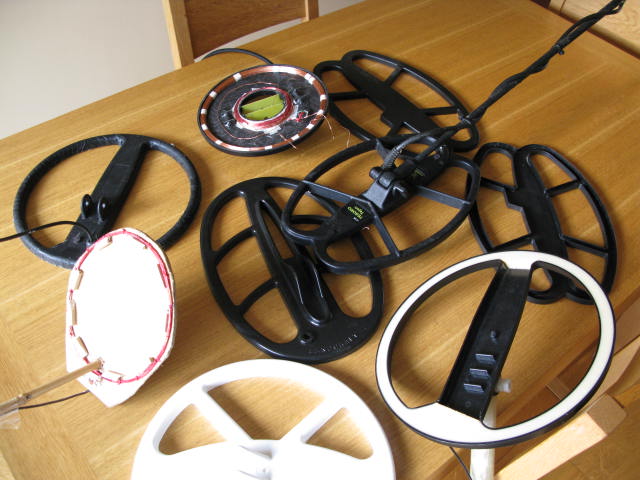

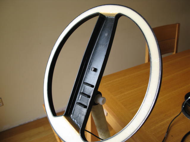

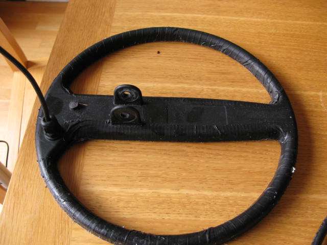

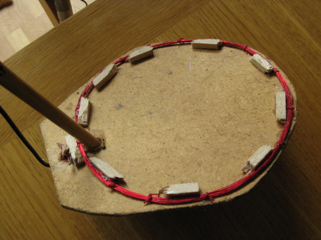

    • A few coils and shells for ideas

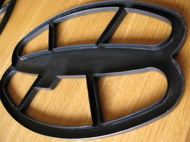

      • What has your experience been with the "butterfly" coils? I haven't tried making one of those yet.
        All kinds of things to consider when building. Pin pointing, ground coverage, ground signal cancellation, EMF cancellation, depth, maneuverability,
        weight, buoyancy, target separation. All coil geometries have their merits!
        Don.
        • Your right Don 2 bits of required info are, what do you want to hunt and what are the conditions like.
          I was using a 27 DD and it was fine - general purpose. At 12khz Tx 8khx Rx - to see smaller items.
          The butterfly is not a depth beast, its use is ground coverage in record time... - mine is 13"? long but only 8 wide.

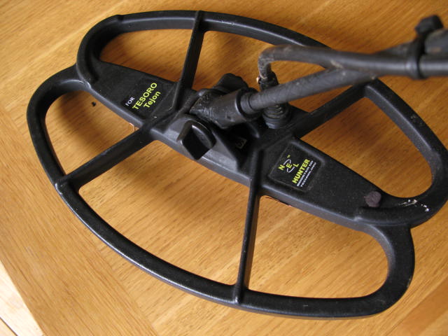

          I wanted to cover a little more ground per unit time, I went for a NEL Hunter ~ Not the deepest- but handles europe clean soil well. This also doesnt like wet grass.
          I got a high frequency version designed for a Tejon. It has no caps in the coil so you need Tx and Rx cap in box.
          I messed about with the cap values to give me phasing / some depth and a usable null. 12k Tx - I pull small silver to 6" reliably with it - the photo earlier of roman and medieval was from this NEL. Its cable has 2 coaxes. in shotgun, one fro Tx and one for Rx.
          The depth is about 90% of the smaller dimension, from experience.
          Lots of uk guys put a dual ellipse / butterfly on a 250 and do real well relatively. ~As the original 250 coil is a bit lame.
          I have a modified 250 that takes my nel hunter and runs 15,5k Tx - needs some work though.
          The Deus lads rape it, they all have bad knees, as theyre always on them digging finds while spectrum and rapierII owners wander aimlessly.
          Steve
