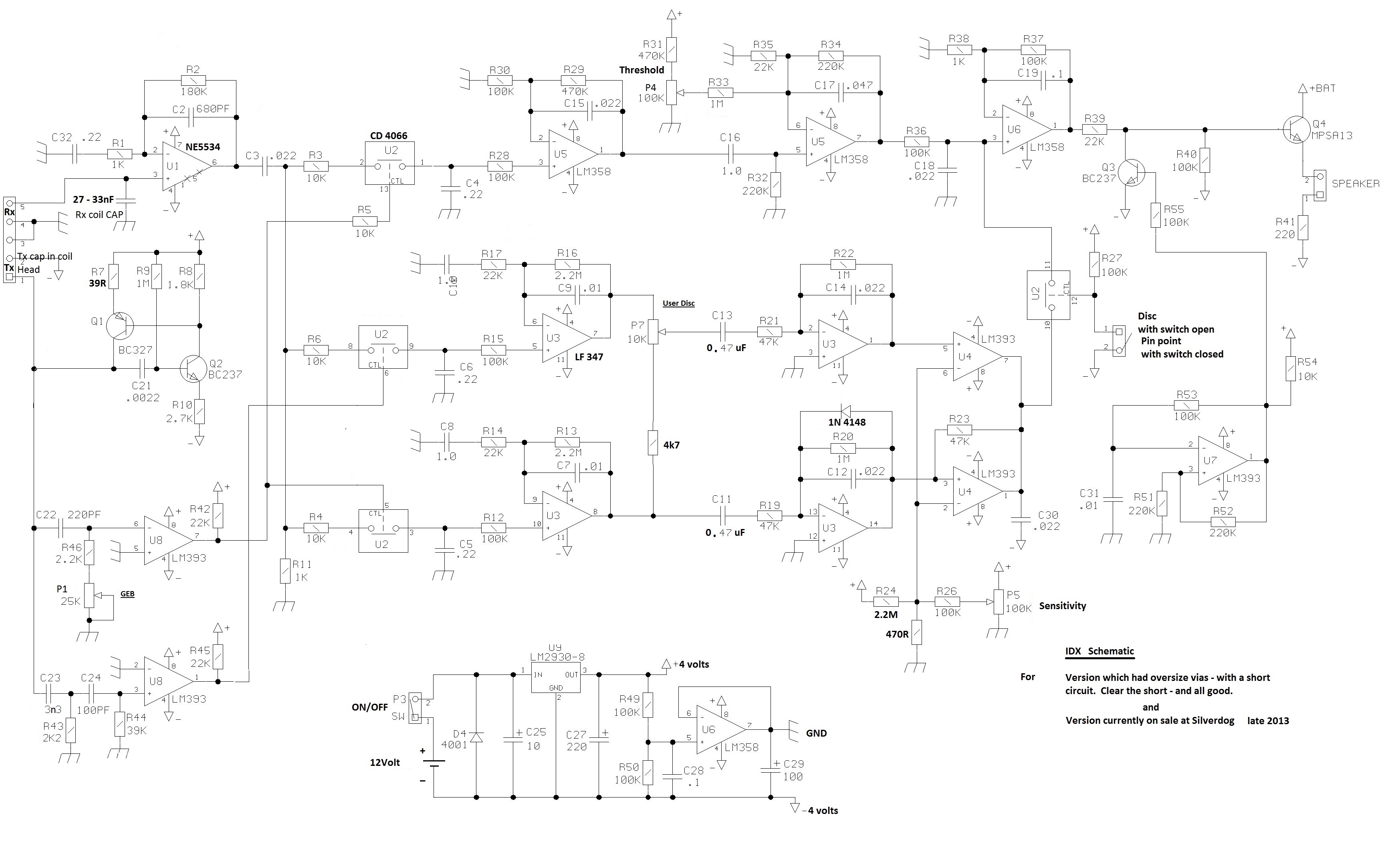

  • This is the best schematic there is to the current pcb.
Name:	IDX schematic - late 2013 and pcb that had short cct.jpg
Name:	IDX Pro latest rev MASK.jpg

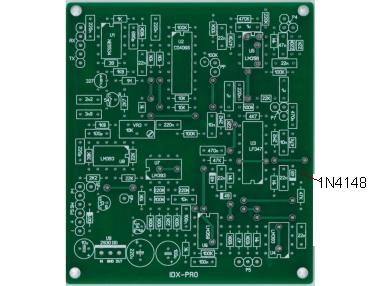

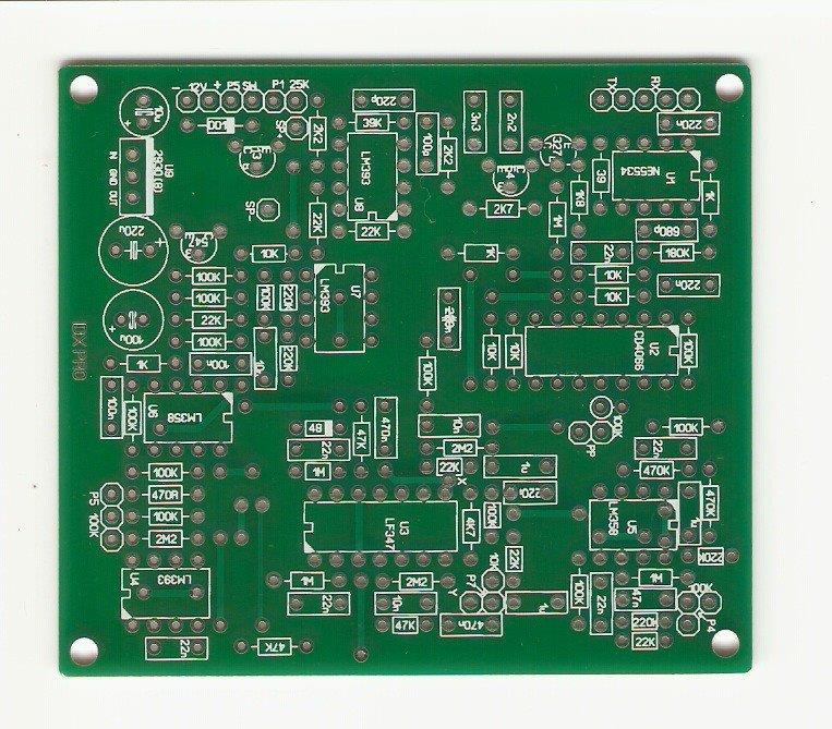

      Is this one you made or a kit from silverdog?
      I made this board using the Modified Mask here to Etch the Boards.
      I am finishing a second board in the next day or 2.

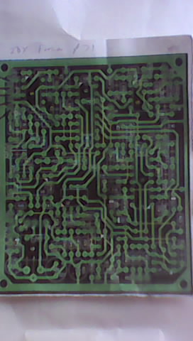

      And that Attachment that you just posted is a Board image and Not ther MASK.
      Also, it does not include FREQ connector.

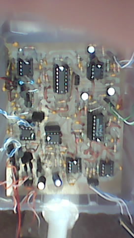

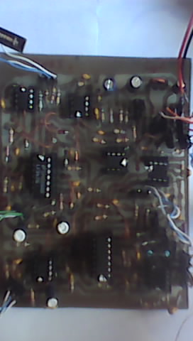

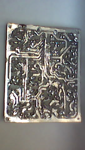

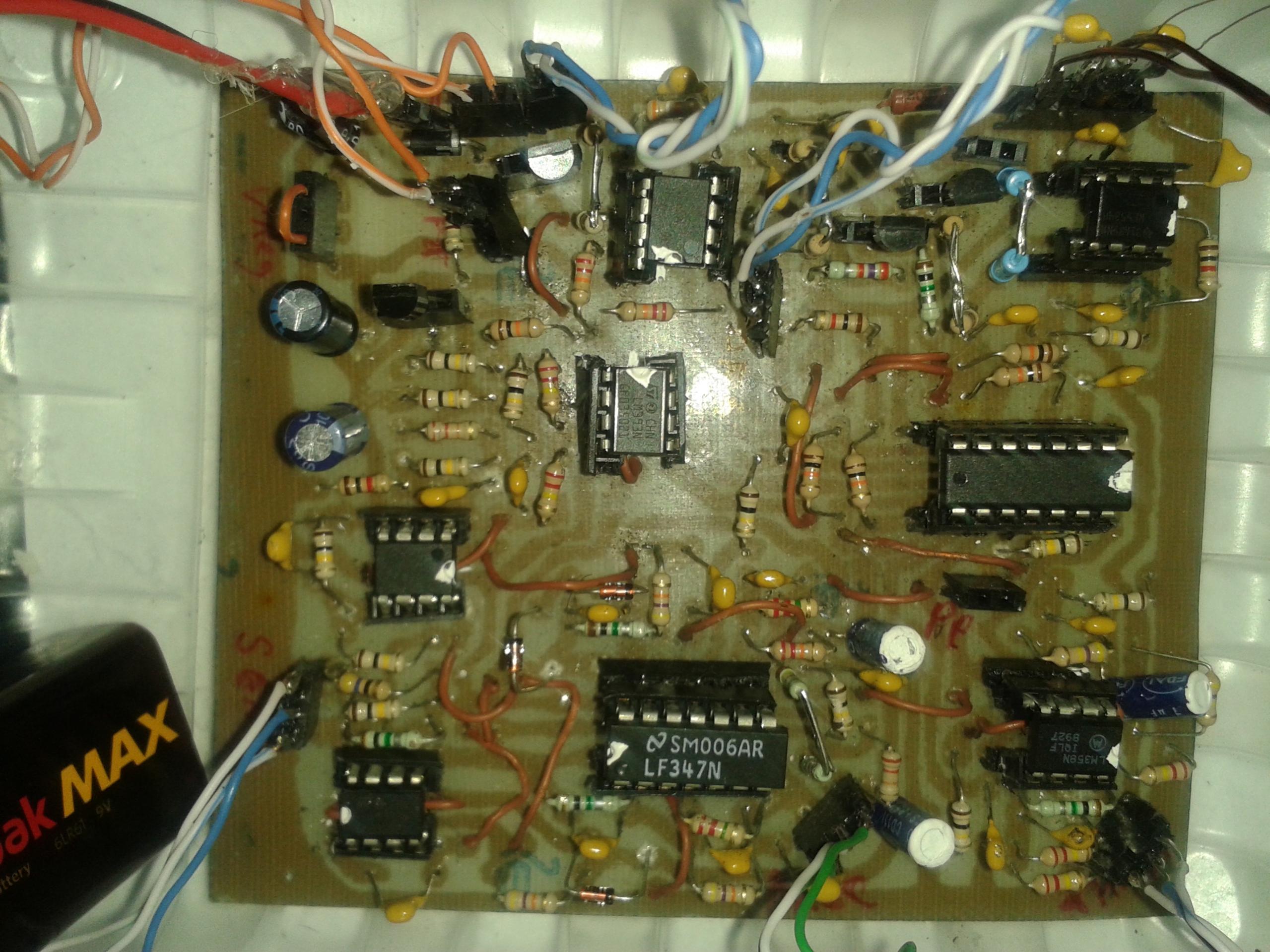

      • BOARD Images
        Attached are photos of my 2 Boards, same Etching and Parts :

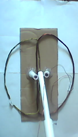

        • And, below is the Coil :
          Questions:
          I find my MPSA13 overheats and the 2-inch range drops out to zero often.
          Which Caps need to be Poly or Mica ?
          - I only see directions for the 1uF Caps as Poly
          - but Board Images seem to use all be Poly or Mica Caps ...
          - I have only used Ceramic Caps so far - with intention to replace as needed.
          • You have clearly worked hard on this so far and Im sure one day you will get going.
            The images are not good enough for anyone on here to help you.

              Posting #2401 is a Top Board image - NOT a MASK - NO Traces
                [ATTACH]29668[/ATTACH]
                [ATTACH]29669[/ATTACH]
                hi dear golfnut
                you send before these image here , and so why these values are diff ?
                and about CC coil , can you teach us , please.

                  MSPA13 should be cold. Wrong component short or wrong orientation. Had a quick look at your photos lot of work there but can't see enough detail to check for you
                  • Okay, found 1 problem:
                    - Speaker was plugged into GND instead of 220R resistor - which overheated the MPSA13 and drained my batteries.
                    - I did not realize it; the mistake was assuming the diagram was correct.
                    - see: Page 30 Posting #734 - IDXPCBFRONT-1024X768.JPG
                    But, I still only get about 2-inch range.
                    I carefully adjust the coil to a hum,
                    then a Coin waved within only 2-inch range - causes a Buzz and Beep.
                    While all the Pots still seem to have no effect high or low: DISC, SENS, OFS, GEB.

                      for your attachment you can use 2.7zener just turn it 180 deg.
                      and if you have problem check all part and careful dont have short circuit . print of your pcb in paper then check with multimeter , it can help you more.

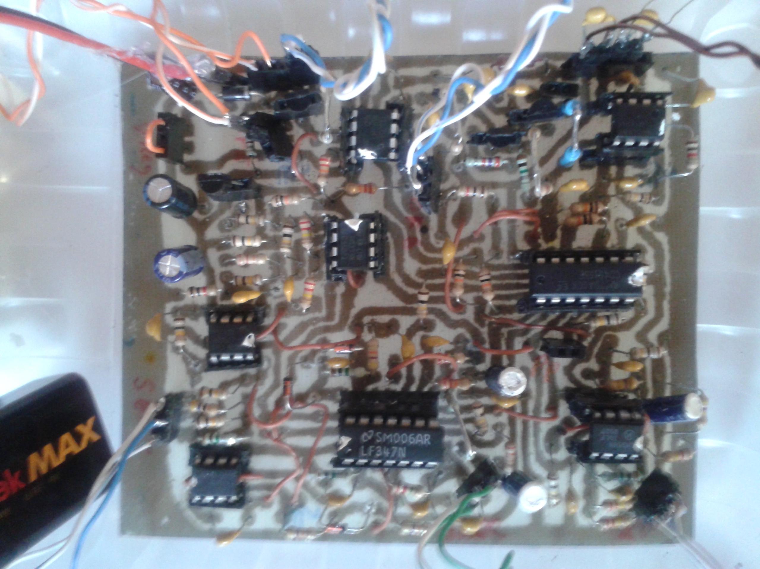

                          Attached are better Images of the Board :

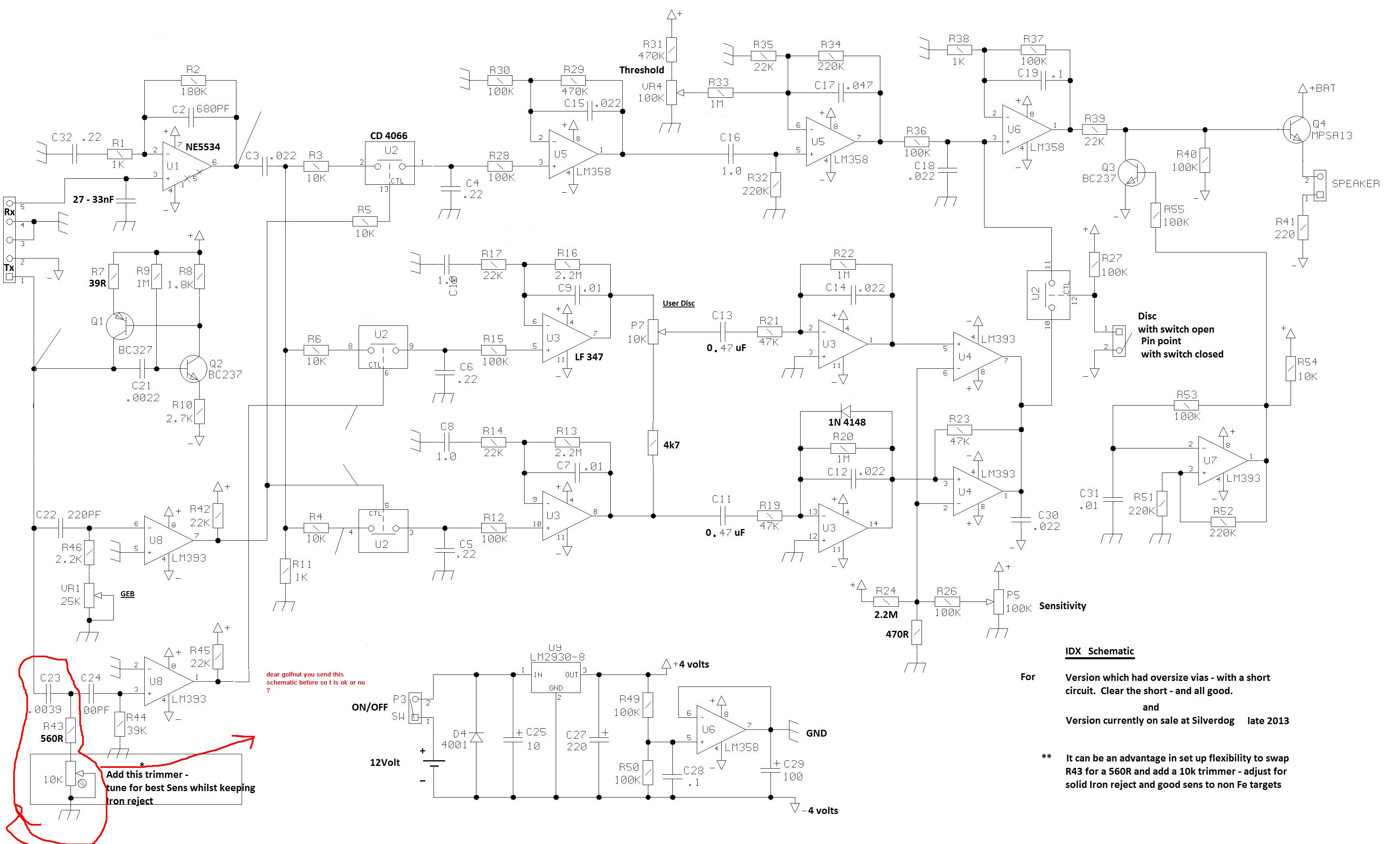

                            hi dear golfnut
                            Adding the trimmer gives user flexibility to cope with variance in coils - try this if you like
                            The pcb/schematic in 2401 is as supplied in the kit
                            both work, neither is wrong, you choose.
                            • Do you have osilloscope?
                              You need to measure Tx coil ac peak to peak volts...This is start point or non can work - in range 10 to 20 V pp
                                Golfnut,
                                My scope is showing me from TX pins (with COIL and Cap 1uF) clearly a SIN at about 300Hz of 2V pp.
                                I am using Q1 BC327 and Q2 BC547 - this should follow spec.
