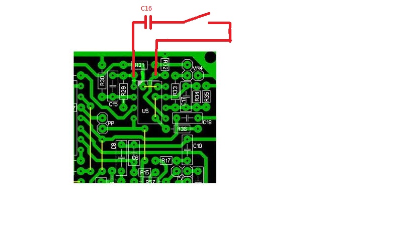

                • PP
                  Some people mention that although the PP works on IDX even with a DD - they have to move their machine a bit to get a PP fix.
                  This is because the PP CH is not DC coupled right through - it has a 1uF cap in seris with it.
                  So in order to get a signal thru the cap you have to generate one my giving the machine a rock about.
                  To make a true non motion PP which reponds to phase rather than frequency you need to short C16 out during PP mode.
                  I use a DPDT switch - one to turn into PP mode rather than the push button in the kit and the other switch to wire out the cap.
                  Another option is to put massive cap in like 100uF that can pass small phase changes more easily.

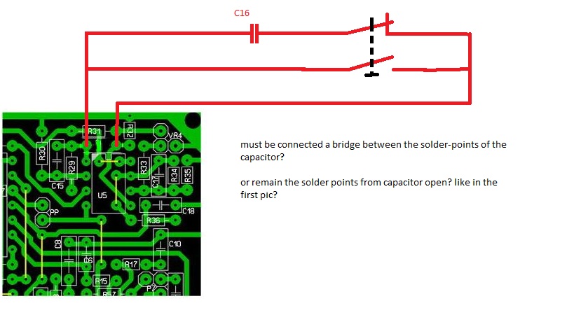

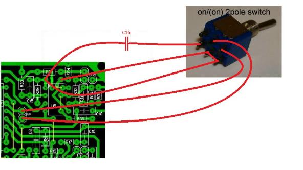

                      • hi at all,
                        hi golfnut,
                        take a look on the pic.....is that ok? or I have to pay attention to something?Click image for larger version

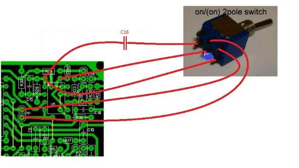

                        • oh, a mistake.....so its right i think....Click image for larger version
                          • Why you join two of the C16 feet at the time of the usage of the pinpoint? He functions properly without this at me.
                            • Originally posted by szucs_g View Post
                              Some people say thier IDX PP needs a small sweep to help PP.
                              To make the PP a true non motion PP C16 needs to a) have a very large value or b) wire it out - short it out with a switch.
                              I used a DPST one for shorting the cap out, and one replacing the push button.
                              It gives you ability for very accurate PP without having to rock the head about.
                              If your happy with your PP as it is - then do not attempt this mod ..
                              S
                              • hi gulfnut,
                                now I'm confused a little. I again thought about what you meant. sorry, my english is not that great. only school-english;-) my graphClick image for larger version
ID:	333621Click image for larger version
ID:	333622 is ok? or the new graph is correct? Please, just look at it once .....
