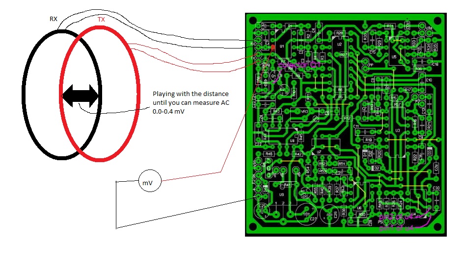

    I am beginner in this and electronic so I made yours idx pro and I dont know how to adjust coil and set it to work good.
    I make rx to operate on 6,5khz but I dont know what values to set potentiometers, phase, oscilloscope settings and other thinks. I assume that you know what I must do to set this coil. Can you tell me what to do or show me post where I can see?
    Any help is valuable for me!
    Best regards!
    • hi konan,
      what do you want to know? perhaps you take a look in the manual.....have you build a coil? if yes, you have to nulling the coil. if you made a DD you have to play with the overlapping of the rx and tx coil....you have to measure AC 0,0-0,4 mV on ic1 pin 3......VR3 can be replaced with a 1kohm resistent.

      • Yes I made DD coil but dont know how to nulling coil and set phase and what else I must to set and measure to make it well.
        Thanks for tips Schatztaucher !
        • NULLING:Click image for larger version
Name:	für konan.jpg
          • DD Coils
            Konan,here you will find all necessary information on the DD coils. It is very well explained. Read it and so will you learn as a coil cancels and phase as measured with the oscilloscope.

              • Thanks Eduardo1979, can you tell me what to measure in this case with dual trace oscilloscope? What IC and what pin?
                • Originally posted by konan View Post
                  For the cancellation of the coil connects the oscilloscope on pin 6 of U1 (NE5534).

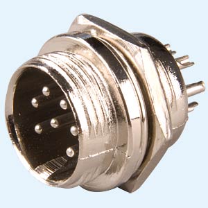

                      • Hi,
                        i want to use the original Whites Black Max Pro 950 Coil for my IDX Pro Project.
                        Does anyone know where i can buy this Coil socket to connect the Black Max pro directly to IDX Pro ?
                        Firebox
                        • you can take this.......with a little mod....you have to cut 2 of the 7 pins......

                          • Hi,
                            do you have a Model name for this socket? or a link where i can order this one ?
                            Many thanks
                            EDIT: I ve found it !
                            http://www.on-radio-shop.de/eshop/pr...roducts_id=409
                            right one ?
                            • Hi,
                              do you mean this one fits to original Whites Searchoil connector when i cut these two pins ??
                              • ok, thanks!
