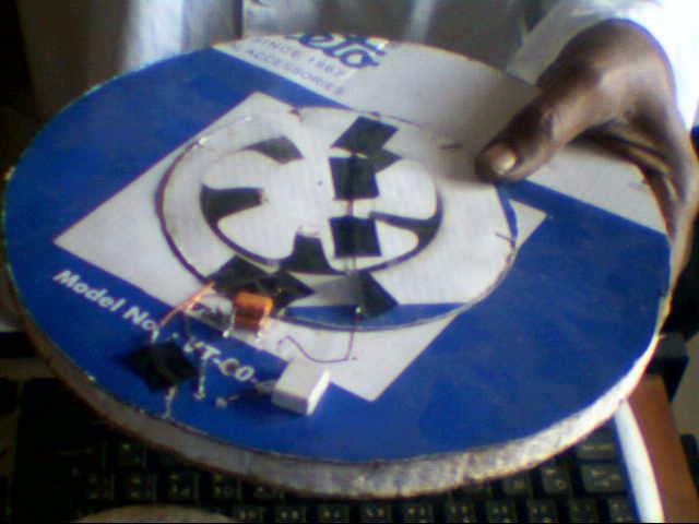

    hi don for tx coil you used 22awg seems a low gauge and will give high resistance
    Yes, this is true. I still get 15V PP across the coil though and works just fine with 22 Gauge.
    Dropping wire size to 26 AWG will cause noticable drop in amplitude to about 12V PP.
    Increasing wire gauge to 20 AWG does not increase amplitude but adds more bulk and weight, plus much harder to work with.

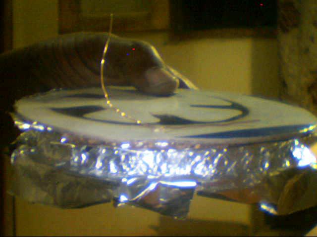

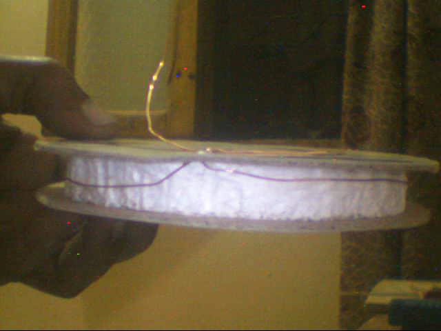

    • hi dfbowers i used .7 for tx and followed yr nice way using foam and white glue and have a resistance of 1.6 ohm. i used alu. foil for shield
      surrey unable to post pictures.
      • Originally posted by kabier View Post
        .7 mm looks to be between 21 and 22 AWG depending on insulaton but I think a bit thicker than 22 AWG. If you can find a way to share pics or video of your coil I would like to see it.
        BTW. I am just about finished a 10" concentric for IDX using similar wire and construction methods. It is working very well on the workbench. I need to form a pair of shells yet but will post up some pics soon.
        don
        • hi don am surrey 22 awg is ok get confused with American gauge.

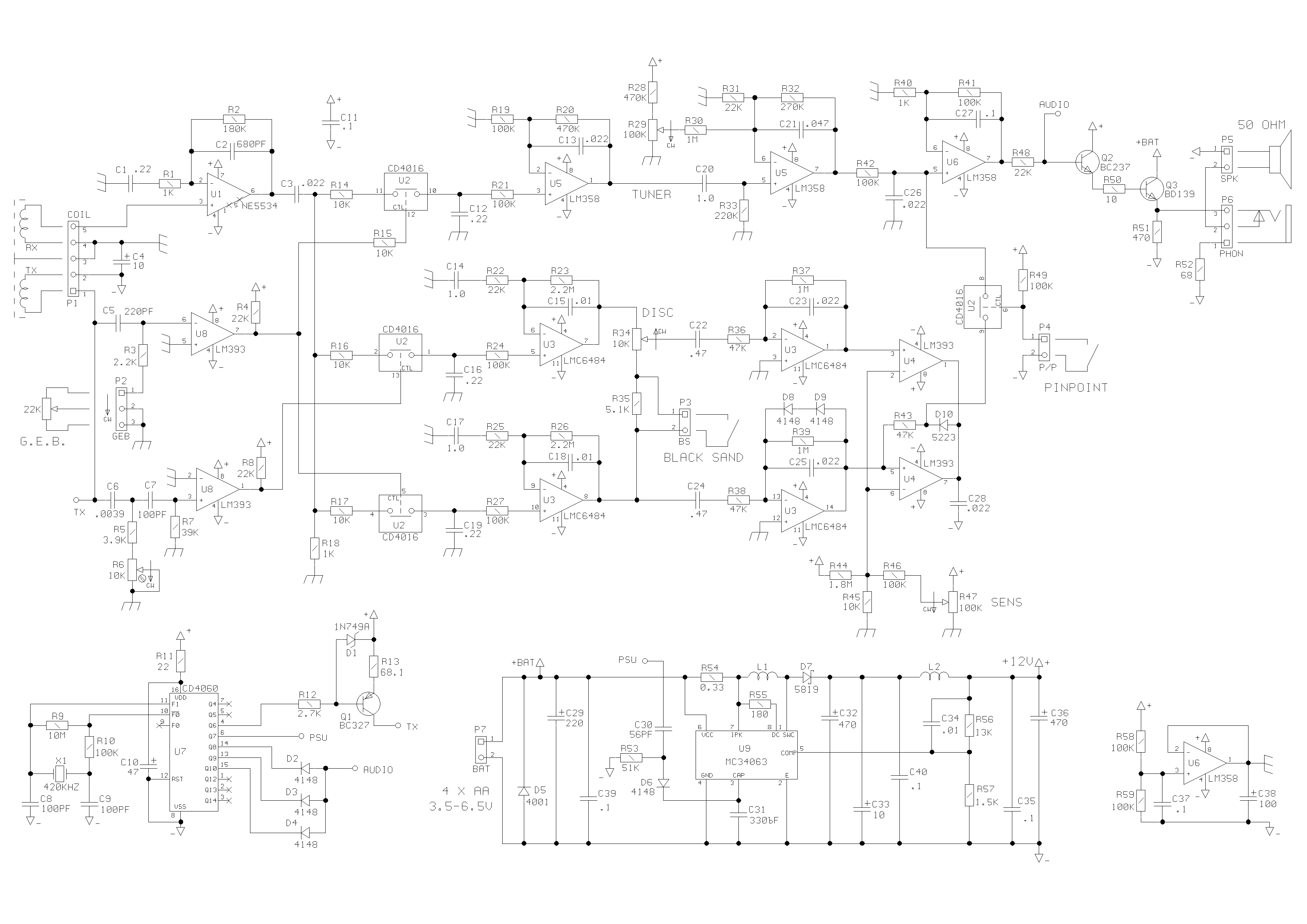

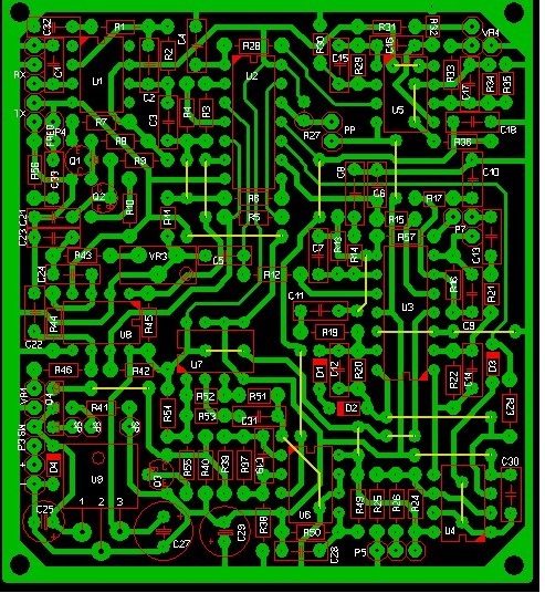

            • this circuit is correct speaker and d3

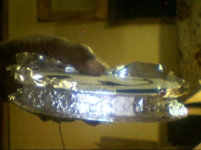

                • hi don above is the alu. shield after winding the coil the foil is folded over the coil and pressed by foam and white glue.
                  • aid ... Q4 BD139in this circuit MPSA13 no

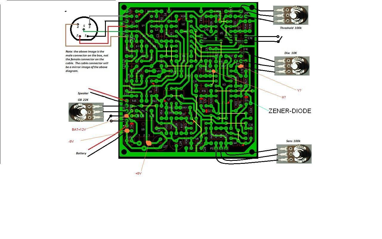

                    • I have a simple question concerning VDI, how to correctly set up "THRESHOLD" at VDI options? It is always have to be at max "10" or it depends on something?
                      • :wall:wall speaker how many watts does it have
                        • merindo only hear a small cloc to the speaker, another pcb, this has many errors
                          • what is best replacment for LM 2930??,bee cuz i cant find in my country!!
                            • good morning are what I must link up the negative demarcation with the demarcation assemble? at the level of spools or are that these 2 points owe etre independent and ; or link the switch all metal t-on / discri thank you ? for the speaker 50 ohms or 8 ohms ?
                              • Originally posted by seadoggy View Post
                                Hi seadoggy
                                You can replace that by a L78L05
                                Best time
