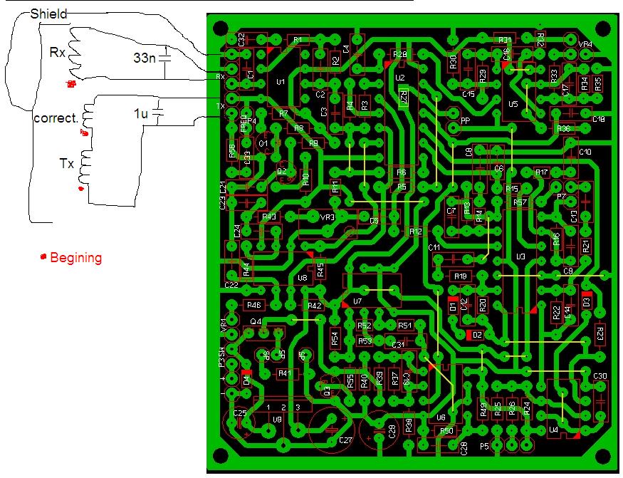

            Your problem is the coil. The cancellation of the coil must be below 4mV. Mine is THE FOLLOWING: TX = 34 turns with wire of 0.60, more 1uF capacitor in parallel. RX = 260 turns of wire of 0.20, more 33nF capacitor in parallel. These measures are for a plate of 27DD. Measurement with AC voltmeter in parallel with the RX coil is 2.55 mV. The cable you are using, too much influence. I use a 4-wire cable plus a shield.
            • TX Coil = 0,580mH = 1,7 Ohms.
              RX Coil = 34mH = 92,1 Ohms.

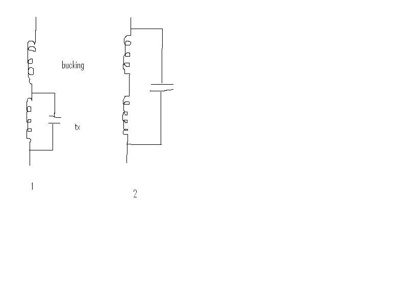

              • Hi I measured my coils and found a 80 deg out phase so i decided to make another coil but i don`t known some basic.
                i`m gonna try with co planar like dfbowers one.
                again sorry for the basic cuestion.....
                tx tank is + tx coil + bucking coil +
                + tunning cap +
                or
                + tunning cap+
                and.... which side is conncted to the hot tx ocilator, tx end or bucking end ?
                • tx tank is , tx coil plus bucking coil and tuning cap or tx coil tuning cap plus bucking coil?
                  • "2" Second version
                    dfbowers: Nice coil, what is the voltage Vpp and the phase shift is near 90 or 180 degree? And connections loooks like this?
                    • Number 2.
                      • The wiring connections look correct. Now, some say that the phasing should be 180 degrees, but mine is 90. Also, my BM600 coil built by White's is 90 degrees.
                        Vpp is 15V. Make sure that your Tx wire size is correct or Tx amplitude will not be correct.

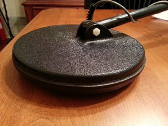

                              I finally got a chance to get out with this coil today. Without a doubt, best coil I ever made! Air tests were not that impressive, but it ends there. I have 3 lead balls (.570" diameter) buried in my test garden @ 7", 8" and 9". Doesn't seem like much, but in MY soil, ALL my detectors struggle to find any of them. My Shadow X5 is ablsolutely quiet. This coil with Silverdogs IDX kit hits all of them loud and clear in DISC mode and is more stable and deeper than my 9" and 10" homebuilt DD coils.. Ha! there is really something to be said about smaller coils. Again, this is only a 7.5" coil inside an 8" shell. (My TGSL MIGHT hit the first one on a good day with a 10" DD coil). Now, with that said, this is all old technology.. but exciting for a home hobby builder.
