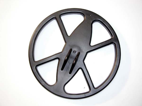

                              • How do you do you cut card board to fit coil enclosure ?
                                My coils are in this shape ...
Name:	CORPUS 27.5sm.jpg
                                You have cover under coil ?
