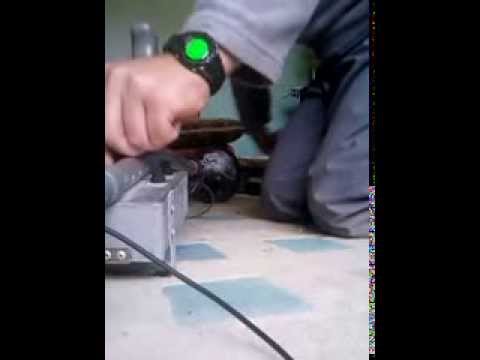

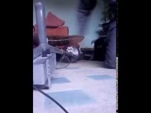

                            • oh i can download it
                              my disc put dont work like you and your ferrite dont seem 5 cm ( it is too small)
                              buy thanks about your perfect help man
                              and i think you are 20-24 ( your age may means ) if you are 24 like me.
                              best wishes
                              and i try to fix my detector ,1- i will set again tomorrow for nulling coil ( near 1.5 volt without attachment and with attachment better near 1 volt )
                              1-1 - then turn SENS pot on max and find the best cap parallel to RX coil for best depth and stability around 25NF to 68Nf (how much frequency for RX coil should be have ??)
                              2-i try to reject ferrite 5 cm by GEB pot
                              3-reject iron by disc pot
                              and best wishes for you man

                              • The ferrite is not too important. Tried a few different types have an old AM antenna here and that works just the same. It is only for bench testing more important that it works with the ground.
                                As you see I have a broken piece as it does not work well if it is a ring shape. Rod is fine.
                                Had to add a 10K resistor to the ground pot as mine would balanced at one end of the pot travel.
                                Worth spending time to get working properly as it is a great detector.
                                Normally set the disc so a ring pull is just accepted. The detector is then quite on small iron and small foil allows all silver and gold to sound normally. larger iron gives a spitting sound (none clean beeb) You still have to dig aluminum and larger foil. If you turn disc up to much you loose gold.
                                The black coin in the video is a silver shilling I found on the beach with the IDX last week. Corroded and ground down to about half is original thickness.
