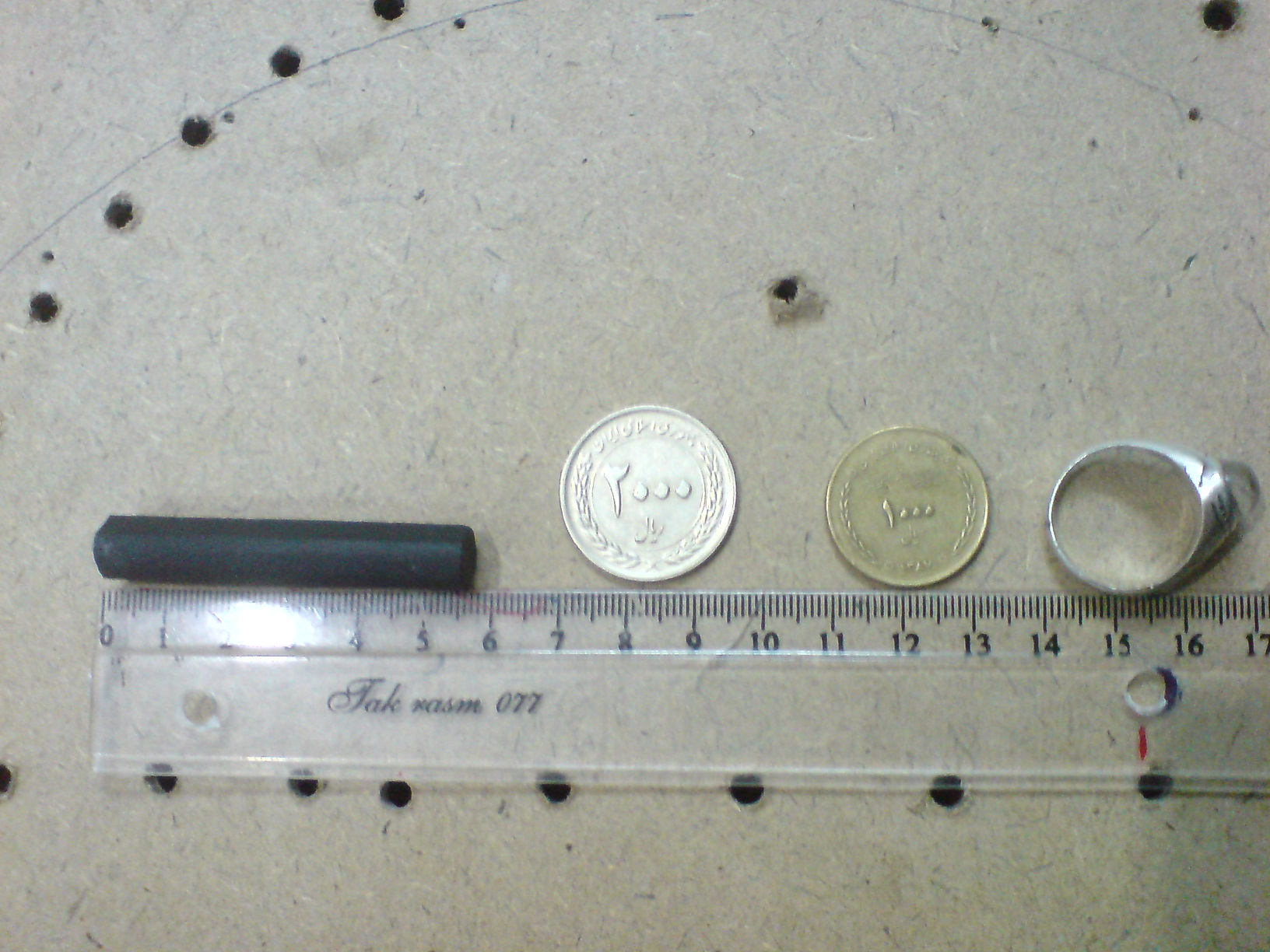

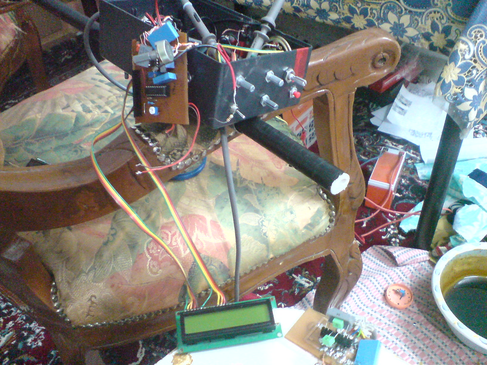

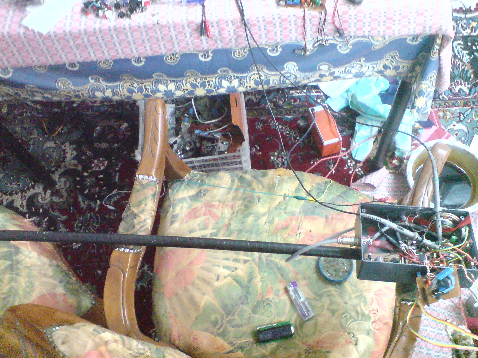

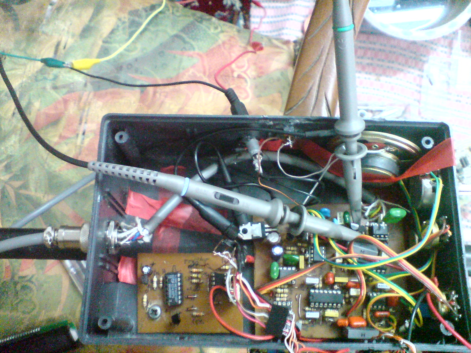

                        • hi all gurus and friend
                          i add Attachment 26873 and in this i put for C , 100n( between pin5-8 ne5534 )and my nulling figure is 650mv(ne5534-6)
                          then :
                          i put the SENS on the max depth then find the best caps for the RX coils (stability and best depth near 32 - 33cm for 2000Rial )and it is for me 22n+22n+1.8n+1.8n
                          i set DIsC on fully CW(for reject iron ) then get test in my video and put it here.
                          in video i put by pice of ferrite 5.1cm and i can not reject it , and can guide me more ????(need to adjust for discrimination )
                          sorry for my bad QUALITY video, ( and i can not find 1EURO in my city ) so i measure by 2000Rial,1000Rial,ferrite , silver ring in this video

                          • Disc should just work. There no real setting up.
                            Fully CCW to accept everything then turn it up to you required level.
                            Some big iron still breaks through but look like you gave a small problem. Best to test with a small screw or nail. Should always possible to have no sound at all.
                            • ok
                              i put disc on ccw fully then check it.
                              i first think reject the ferrite next ferrite the iron.
                              EDIT :
                              i put disc on fully cw and next push zero buttom (set point ) and turn geb pot to find reject point (not reject well )then release zero.
                              but now again can not reject the ferrite and iron in cw mode for disc , so maybe my coil have problem or problem in me ????(my friend i do every think you say and very ask to you ,so sorry ,but i need discrimination , if you can put here a video for guide me more better. )
                              • Okay I will put a video of disc when I get back if nobody answers first. Going away for a two days cycling got a 5 am start so signing off for now.
