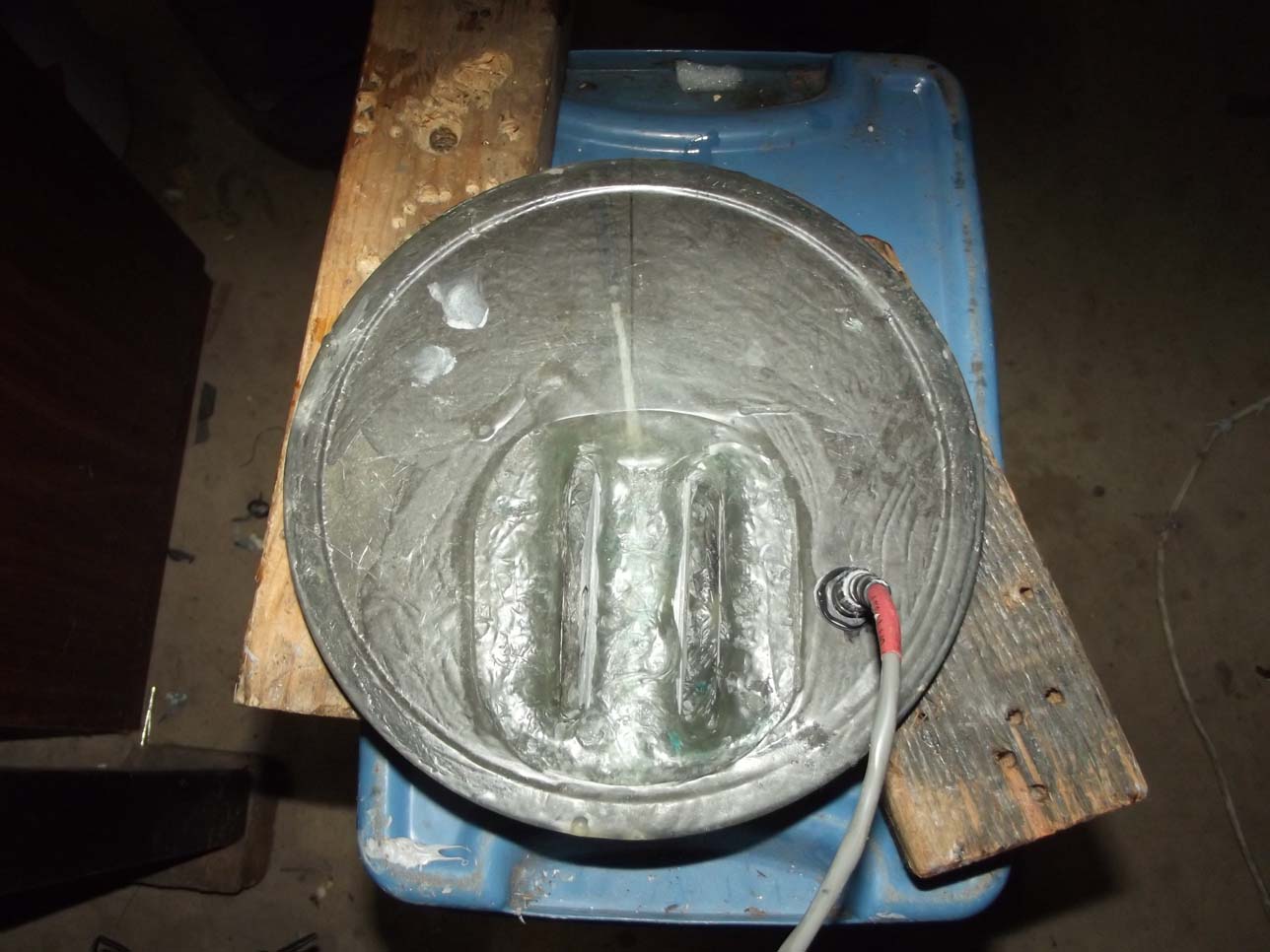

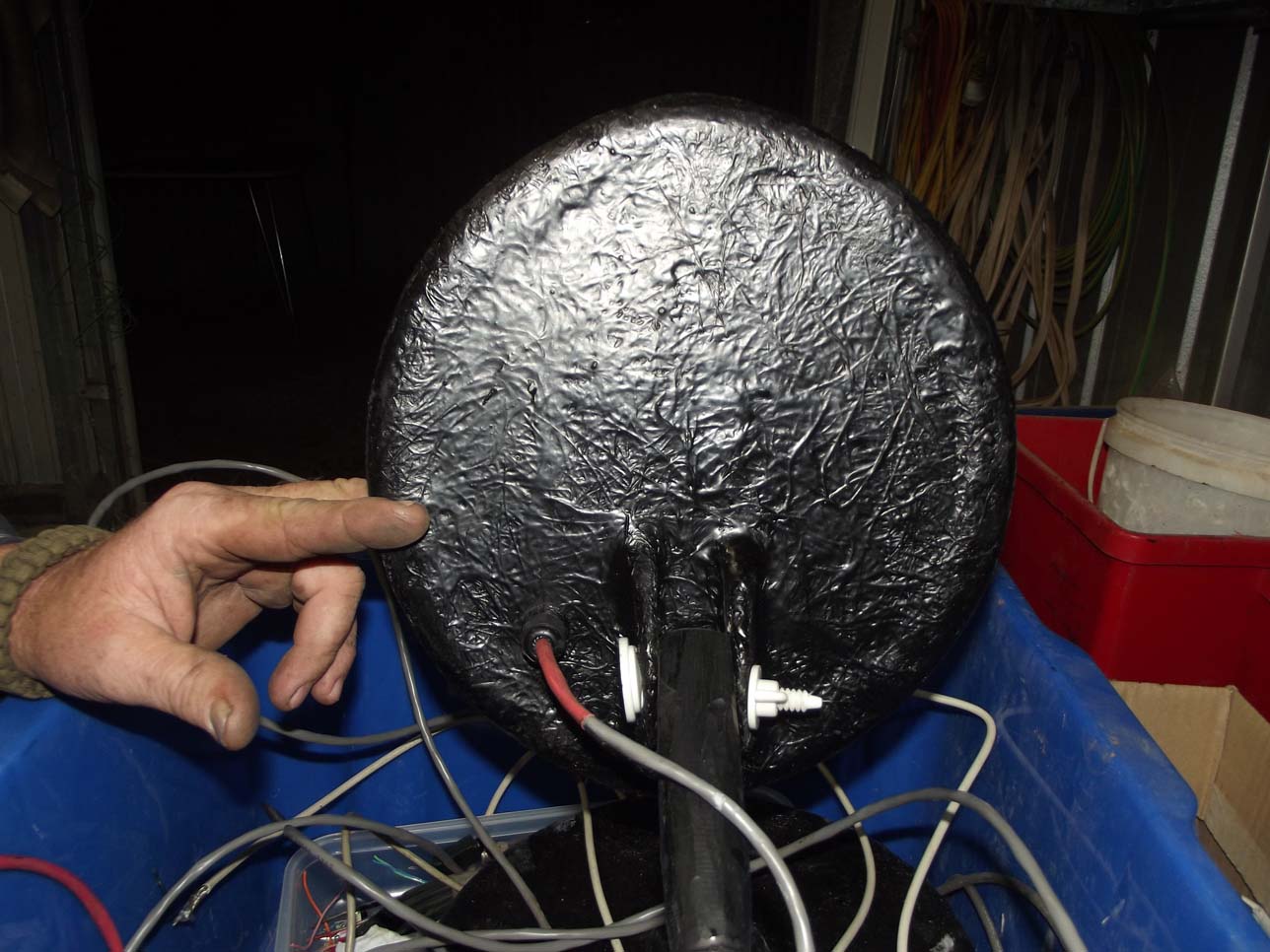

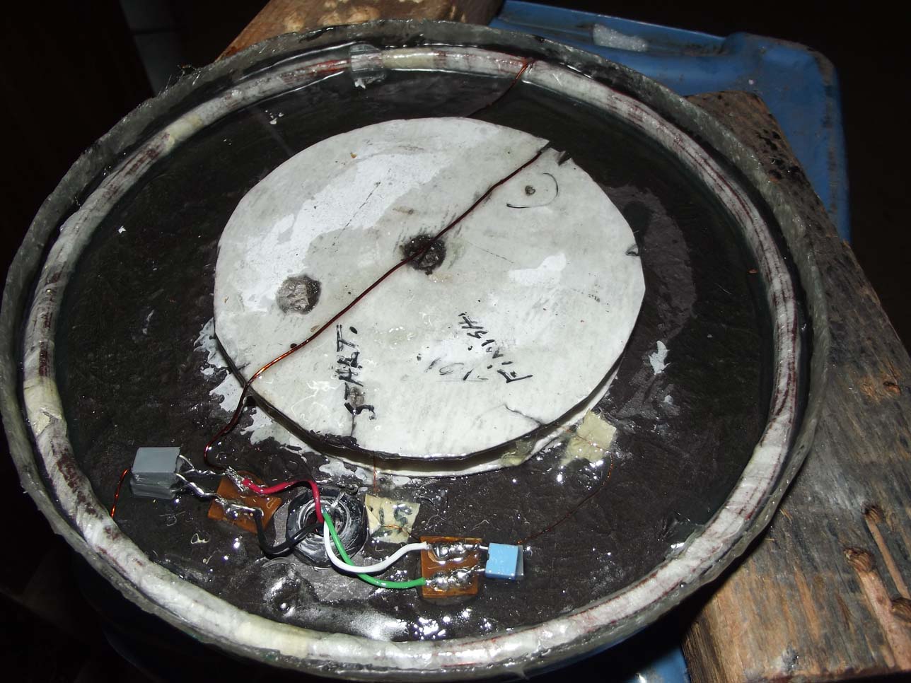

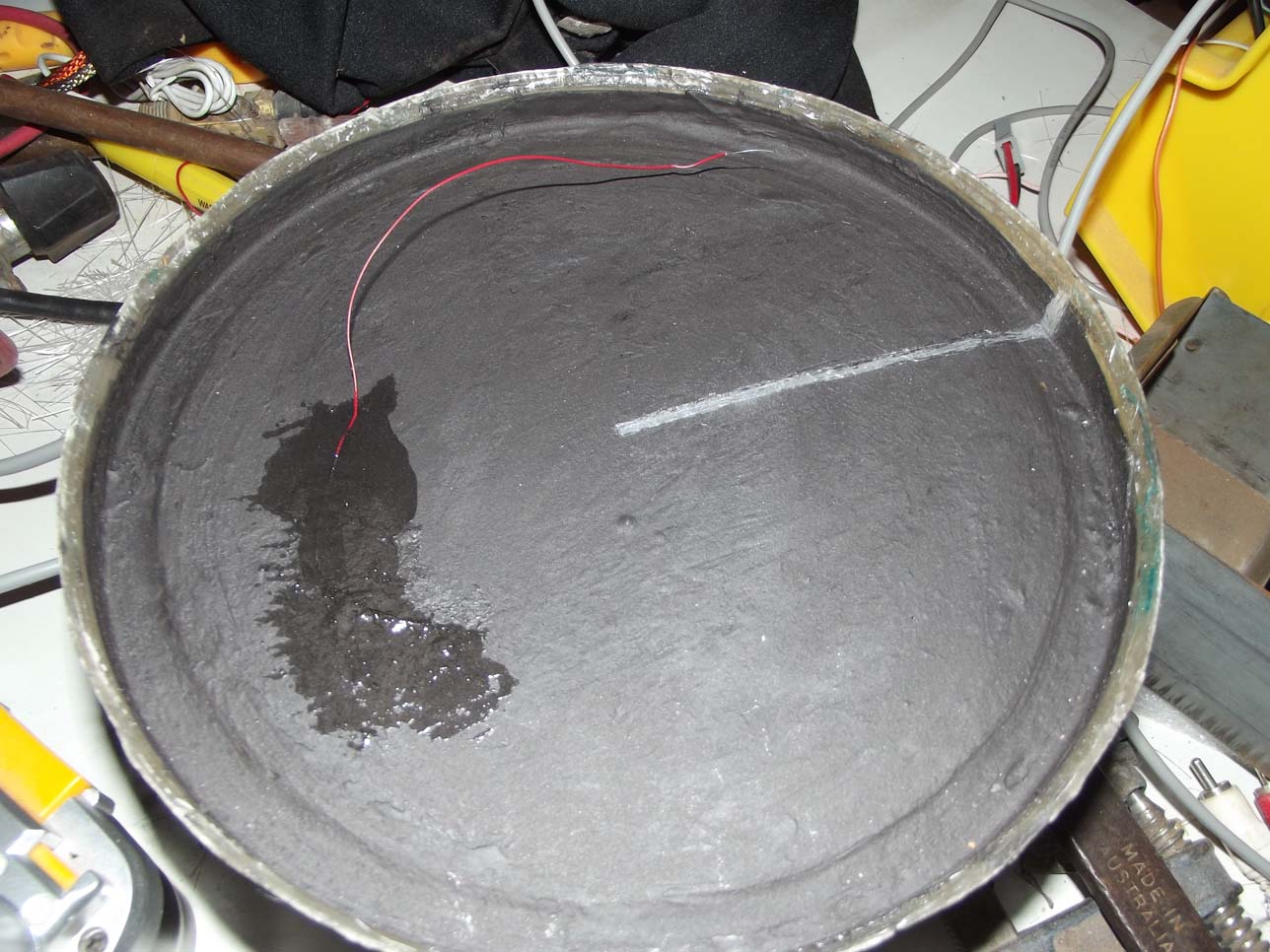

    • hi ,, ALL ,Just a few pics of the 2x new coils I made ..Click image for larger version
ID:	339549Click image for larger version
ID:	339550Click image for larger version
ID:	339551Click image for larger version
      LEARNING a bit as I go <BUT cannot achieve the air tests that most do on here ,,GEB-OK can do that OK now, it seems once you get to reject the ferrite ,& try as I might I cannot improve the air test A 20 cent size coin AT 30cm ..
      CHEERS ALL ,,,,,,,,,BARRY..

          THANKYOU ,,WAIKIKI ,, that very good information ,as I on my DD coils used a solid copper wire on the edge of the coils [single strand] & yes leaving a gap ..
          So next coil I will use your method ..
          GREAT,, MATE ,,,,,,,,,,BARRY..

                • "seems once you get to reject the ferrite ,& try as I might I cannot improve the air test A 20 cent size coin AT 30cm .."
                  You dont want more - what you have sounds perfect.
                  if you go for a 40" air test, it wont work over ground as the Rx and Tx will be so close. It will false all the time/
                  try what you have and it will be fine S
                  • Dont forget Barry the null is secondary importance. The correct phasing makes or breaks your coil.
                    If phase correct by tweaking position of coils, and maybe the Rx cap up or down 1 or 2 nF --- when rejectin ferrite, and irn and accepting all other phases - then take a look at the null.
                    If 300mY or less leave well alone. Your away.

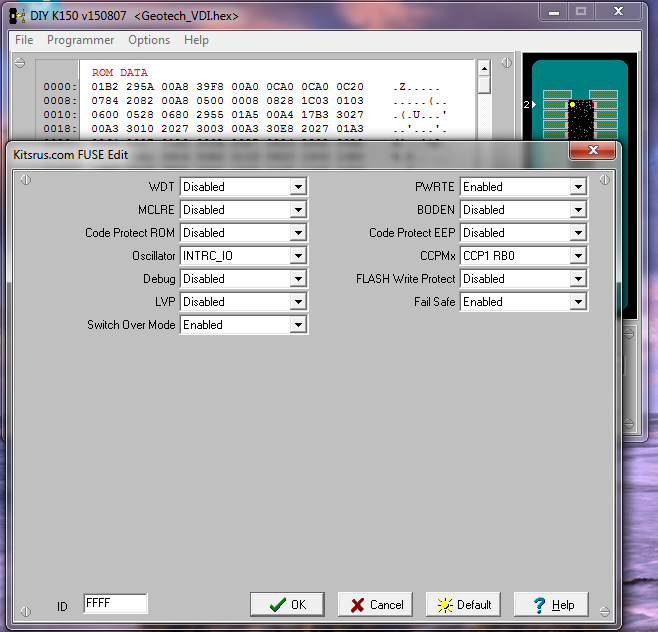

                    • hello guys!Do i need set up something here before i program PIC 16f88??pls help

                        HI STEVE GREAT ADVICE AS PER USUAL , ALL of my 3 coils built are approx same air test within a coulpe cm or so ,& i tried each time to improve but I must have found the limit of my IDX ,,
                        What I have improved with these last 2x coils is the GEB -reject ferrite at 11-12oclock & thats good ..
                        NOW also have a great formula for the graphite shield mix [very pleased to have found that ] of course from much help from this site& members ,,
                        STEVE ,MY son is interested so we will build another soon & I will buy a bare board to experiment with following your higher frquency mods etc..
                        Soon to get out to test on actual ground to test the DD vs the coplaner will be interesting..
                        I am to obtain some fibre-glass woven -cloth in an attempt to make lighter shells & may try as suggested by Waikiki to not use a shell at all ??? but for that I need the woven type cloth for wrapping etc etc ..
                        I may lookinto some audio mods to raise frequency etc for my old ears HAhaar ,I have done many audio fet projects before ,so into the Junk-box ,,..
                        The IDX is a great project & I am glad that you STEVE changed my mind from the TGSL ,, THANKS-MATE ,,,,,BARRY..
