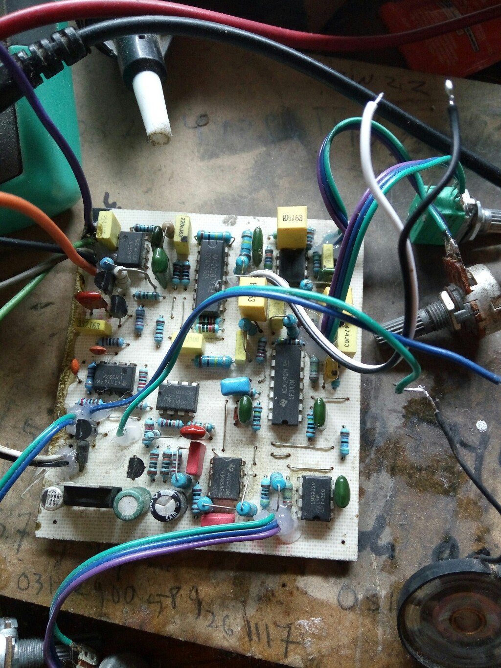

      I continue work this neglected board, but i have no sound, without coil attached, 12v battery and 7808 8v regulator, voltage normal..... Any suggestion where to check?

        Do you get plus and minus 4 volts
        Mine has never done a start up beep. I get a bit of chatter without a coil but others get nothing.

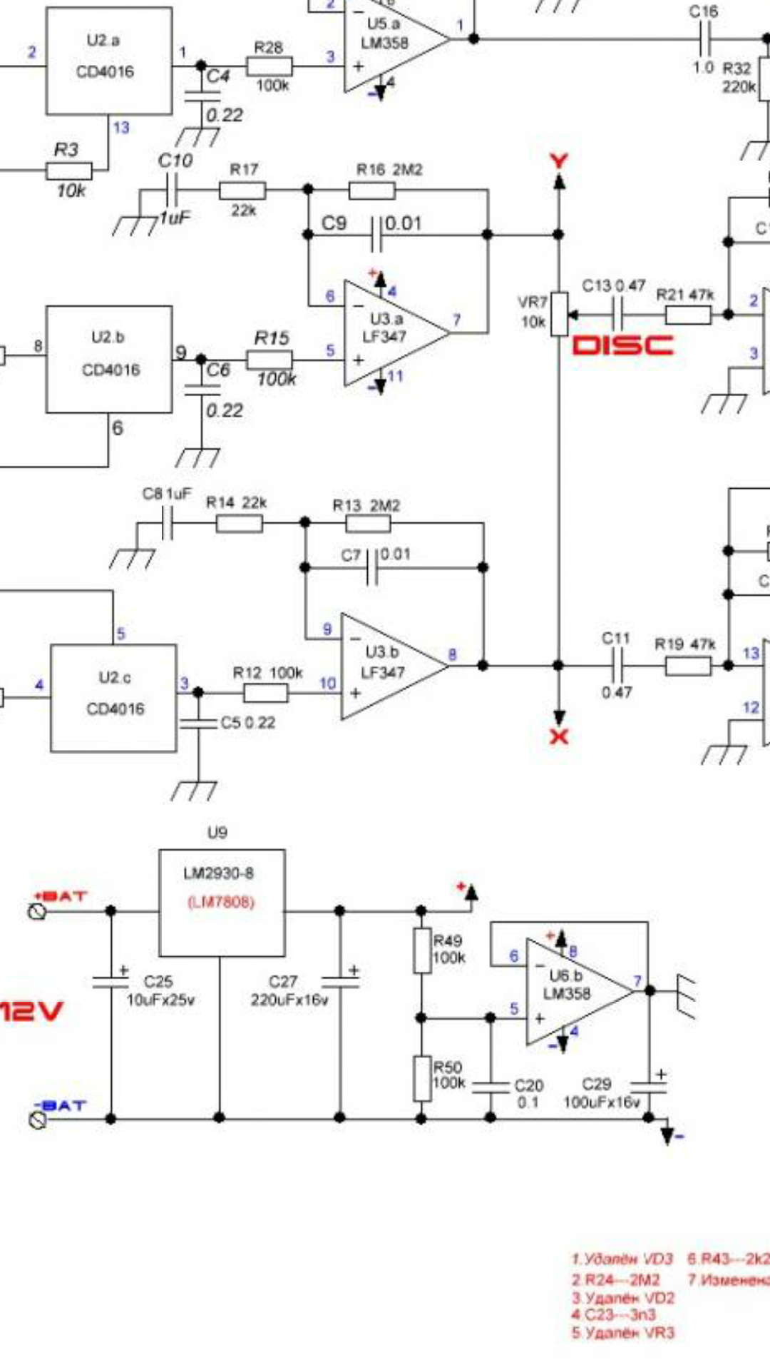

        • My board Just silent, where to check -4v, +4v?
          • From memory one side of C27 is positive the other minus when compared to battery minus
            be careful with the audio and TX as both use minus not earth.
            • I have 8v on c27+, 0v on c27- ....c27 is direct track of batt and 7808

              • Originally posted by ripsdevala View Post
                [ATTACH]40902[/ATTACH]
                For audio stage, what transistor is used? If there is BC517, must be turned for 180 degree.
                • Im using mpsa13
                    You are correct. Its been awhile since I visited my IDX
                    Ground is the outer track of the board not battery negative.

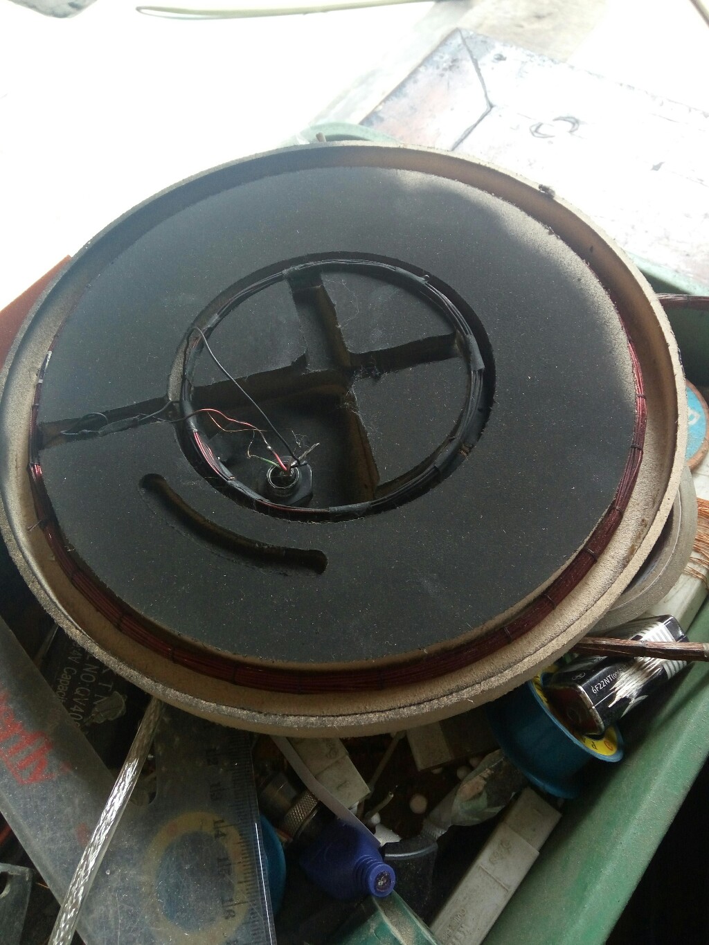

                    Have you tried a coil.
                    • Yes i do, but no no sign of life....
                      Im sure this is just like others mistake...short, dead parts or bad soldering, but i cant see it.
                      ....And my boy messing it up with spray paint

                        You could check the Wave on the TX with a coil connected
                        Golfnut did give some test points here http://www.geotech1.com/forums/showt...658#post181658
