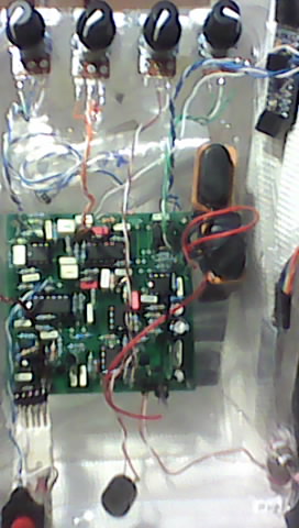

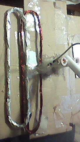

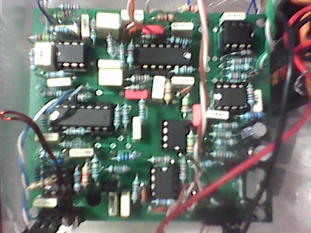

                  • put some pics up so we can stop guessing at what u made
                    • Glad for the help, guys.
                      Board:
                      Coils:
                      - TX line is at bottom of Image ,
                      while RX line is at center following Pole.
                      - No metal around Coils , Pole is Plastic , Joint is a Pencil as axle.
                      - RX line is a Shielded USB Cable.
                      - I can not Epoxy the Coils down - until I achieve a Tuned Coil.
                      How do I tune the TX Coil for U1 p6 = mv - if the TX is already tuned as 16V p2p and 6,3KHz ?
                      • I can answer your last question,,
                        You adjust the overlap of the coils.
                        With your long geometry coils (which are a diversion from the norm) you may find it difficult.
                        If I were you I would bend them round initially..

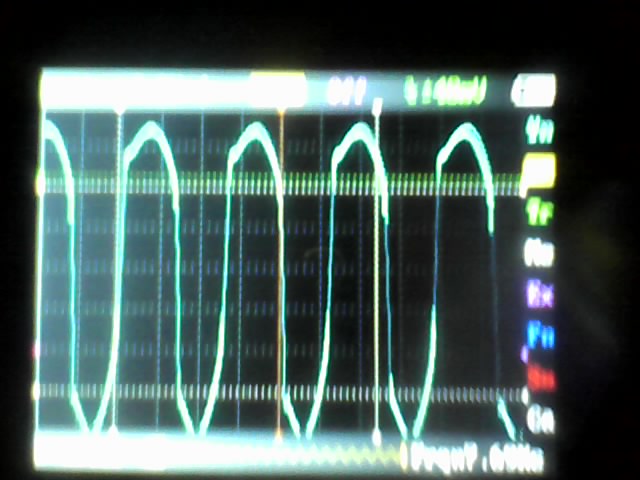

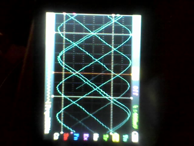

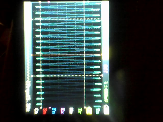

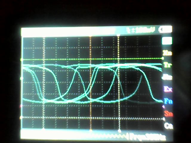

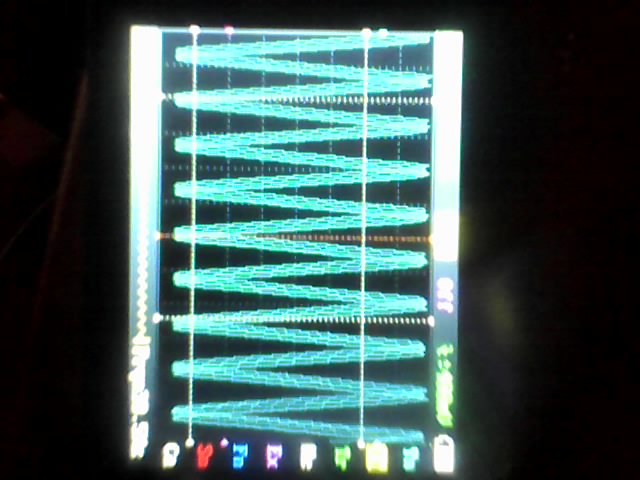

                          • scope yout Tx signal and show us a pic please
                              TX at 200us and 2V per div:
                              TX at 100us per div:
                              TX at 10us per div:
                              RX at 10us and 0.5V per div:
                              RX at 50us and 0.2V per div:
                              I stretched the Coils into Ovals.
                              But, I still get the Chirps or Chattering or Rattling or Metronome - no matter how I adjust the Coils.
